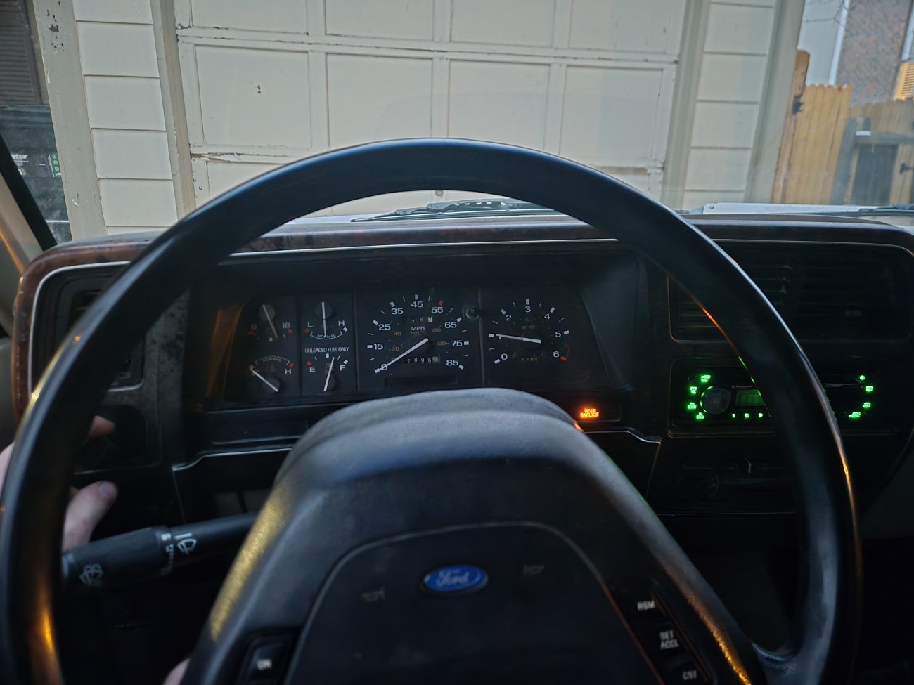

Hey all a couple days ago the illumination for the interior lights went out. I check ed and replaced the respective fuses and pulled the gauge cluster out and didn't notice anything melty. What makes this even more confusing is I installed a new radio and the dimming worked on it just fine. Any ideas as to what the issue is? I thought it might be because my license plat lights are currently out but that can't be because of the radio. Any help is much appreciated.

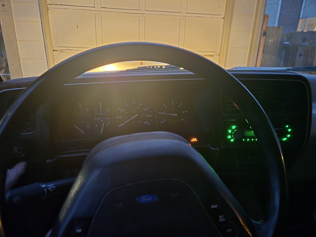

I don't know if yall can tell but the radio gets brighter with the dimmer engaged but my gauged cluster doesn't light up. Honestly at a loss
