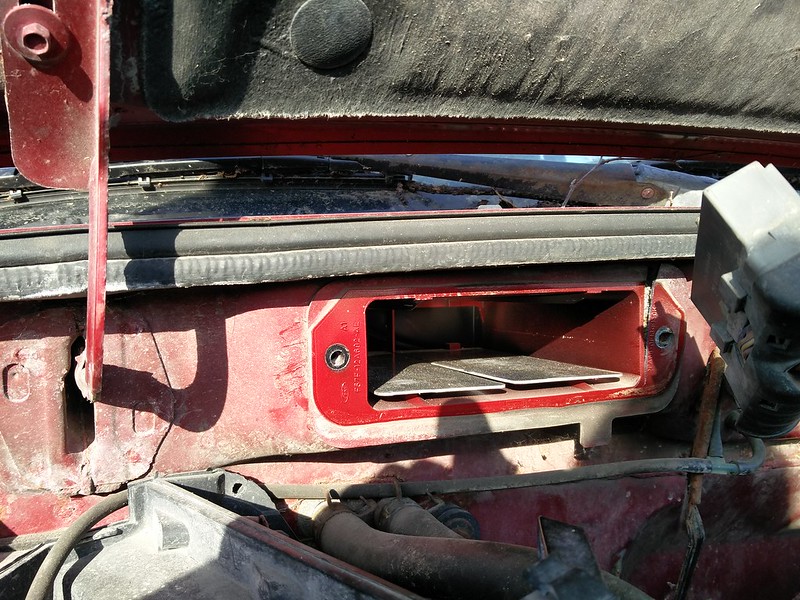

Problem I'm having is that 95-?? (97 at least) "protective boxes" for the ECM appear to be glued into the firewall, and don't seem to want to come out.
Any suggestions on how to get it out? I broke two today trying and decided I needed to re-evaluate before trying a third.
I do have the dust/water boot/lid to match the EEC-IV, so I just need the box to put it in...

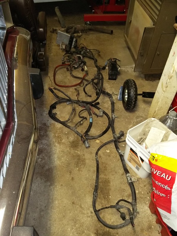

In other news, the 93 EVTM arrived. I laid out the harness...there's a lot of wire here. I'm estimating at least a third is going byebye.

The protective box I pulled out was glued in also but I managed to get it out in one piece. Unfortunately it was about 4 years ago and it is kind of vague as to what I had to do...but I did remove the dash and disconnect the aluminum plate as that was bolted to the inner firewall.
I probably used a 12 in 1 tool and some razor blades to cut the adhesive around the box before attempting to pull it away...or maybe I was able to push it from the inside once the outer edge was cut back.

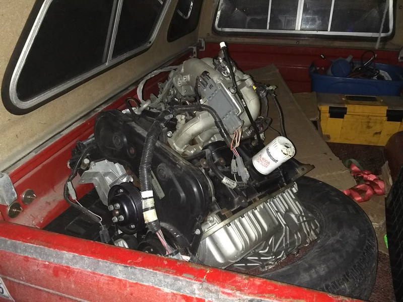

That engine looks pretty clean...that will perk up the truck considerably once everything is worked out...:icon_thumby:
Wow Kishy, good score with the exhaust and EGR tube. Is that going to hook directly into the TB you are using? If so, it will save you quite a bit of work..
Yes, this EGR tube will mate directly with the EGR valve on the new engine...it should be about as easy as it gets.

Ah...so it's normal for them to put up a fight. I had been hoping once the two retaining bolts were out, it'd just pop out. No such luck.
Dropping the dash sounds lovely. I'll evaluate access and see what I can come up with next time I'm at a yard. I'm not above attacking the truck with a reciprocating saw if it comes down to it. Knowing I will need to at least get eyes on the inside half helps though.
It's crazy clean. I completely believe the story about how it was never installed in a vehicle.
I'm expecting it to wake things up nicely.
Be sure to grab that aluminum shield that sits under the ECM...it acts as a ground and probably anti-static as well as keeping the heat from building up. Not sure how hot those computers get but they are better in the upper dash than behind a kick panel in terms of air cooling.
You will notice the ground strap on the aluminum shield...that is probably the most critical component other than the box itself.
A sawzall might work well but there is quite a bit of metal to hack through...

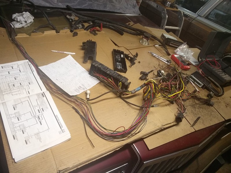

Took the harness apart, studied it a bit. Figured out most of what goes where.

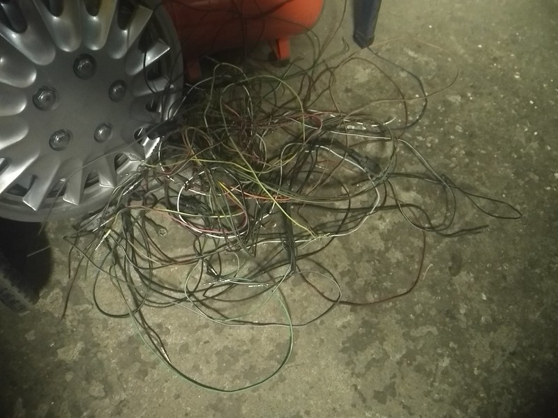

Got rid of all wires I don't need, but stopped short of pulling out the A/C stuff. Will mull that over to decide later. A/C is definitely not part of the engine swap, that's for sure.

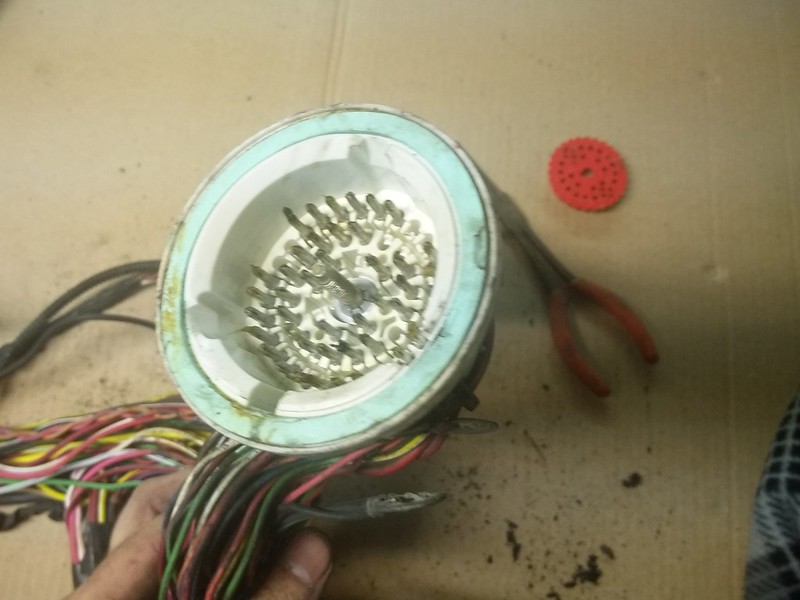

De-pinned C105, the round monster that interfaces through the firewall. No pinout seems to be available for it so I just started tracing things back and using my EEC-IV breakout box to check wires that went to the ECM connector. Eliminated a handful of wires. Made some messy notes.
What I numbered as "pigtail 2", the single wire is for the low oil level switch. I had no idea Ford did that in the trucks, my Lincoln has the same setup. But this 2.3 oil pan does not have the threaded hole for the switch so it will go unused.
It's unclear to me if the ECM wants to see the VSS only for cruise, or if it wants a VSS regardless. Since my truck doesn't have cruise, there is no existing VSS. Should be simple enough to add and I'll keep the VSS wiring in the harness regardless to help make cruise easier to retrofit later should a red wheel with cruise buttons show up.

Just spent some time studying the EVTM a bit more. Looks like 15, possibly 16 wires that need connections through the firewall. I'm hoping most of those are already exposed in the 85 harness so I don't have to fish around under the dash too much.
Quick note...the DPFE connector on the harness is wired to the same ECM pins as an EVP would be. 26 Reference Voltage, 27 EVP Sensor Input, and 46/49 Signal Return. So all I'll need to do on that front is splice on the EVP pigtail instead of the DPFE one and that'll be in business pretty easily.
I came up with this reference as I dig through the wiring. https://docs.google.com/spreadsheets/d/1D1yYnpxD8xAzGzVuzE_R2OeaXA6W447Rn5ArDgqtBpU
It will evolve further as more progress is made.
