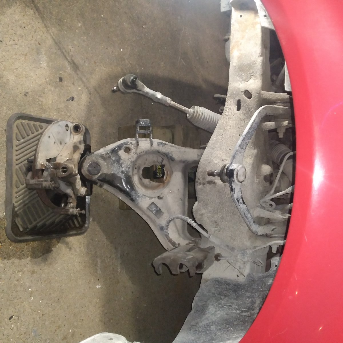

Iac? I looked it up. I'm gonna order one. Soon as i get the front end lined out. Gotta pull the coil springs again gonna grind the lift blocks? down a bit and take some pressure off the system.

why grind the lift blocks? can you not just pull them out? i pulled them out completely on my 03 and it made the truck level
Well it was supposed to be 2" by the time it translated to the ends
It's actually 2.5
Let me say this correctly
Coil spring spacers
If I knock em down by half that should be an inch or inch n half ish when I stick a tape measure from concrete to top of fender
Then I can go to the back end move the bolt in the shackle lift one hole and end up with abt an even 1' lift all the way around
It had 235's on it when I bought it so I've just kept that size
But now I want 245's or 255's that I'll run abt 5-8 lbs under pressure and make em a lil squishy so my 10-12 bulged herniated disc's will feel more comfortable 👍 😃
And I'll b able to go back to the stock Monroe shox and ecerything should b ok
If not ya just yank em out entirely

08-11 Rangers had shorter lift blocks. I wouldn’t grind the factory block
The axle blocks out of a 2008-2011 are about 3/4" - 1", if I remember correctly.
It's a 2000
I put coil spring spacers in the front with (how to say I didn't thoroughly review and go over 8 hrs worth of reading and clicking according to my air force mechanic) rancho shocks
It's a 2000
I’m saying , if you want shorter blocks… there’s where to get them…
The front end is back to the stock configuration now. Thanks. I'm gonna drop a hole in the rear shackles and take an inch off the back end. It'll still hav an inch of lift in the rear but I should b able to go back to the softer shocks anyway

Mine doesn't hav any sort of lift block
2 whl drive
I put adjustable longer rear spring shackles on it
3 leaf springs is it and the front is um a mess with no torsion keys and hammer marks everywhere 🤣🤣
