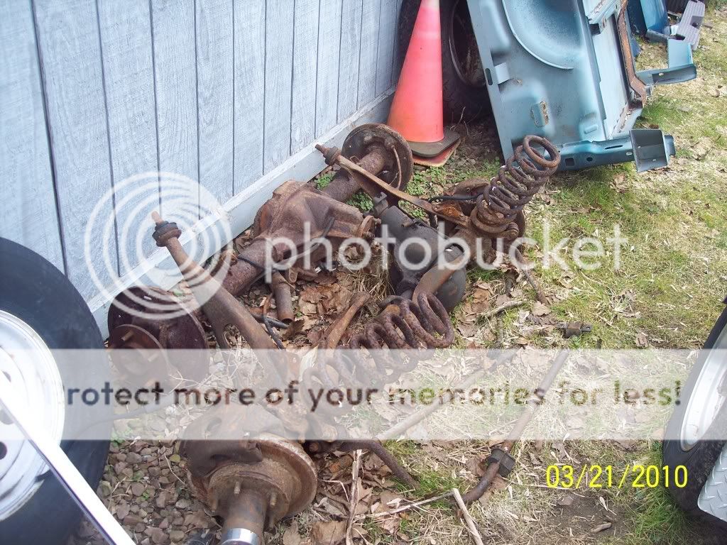

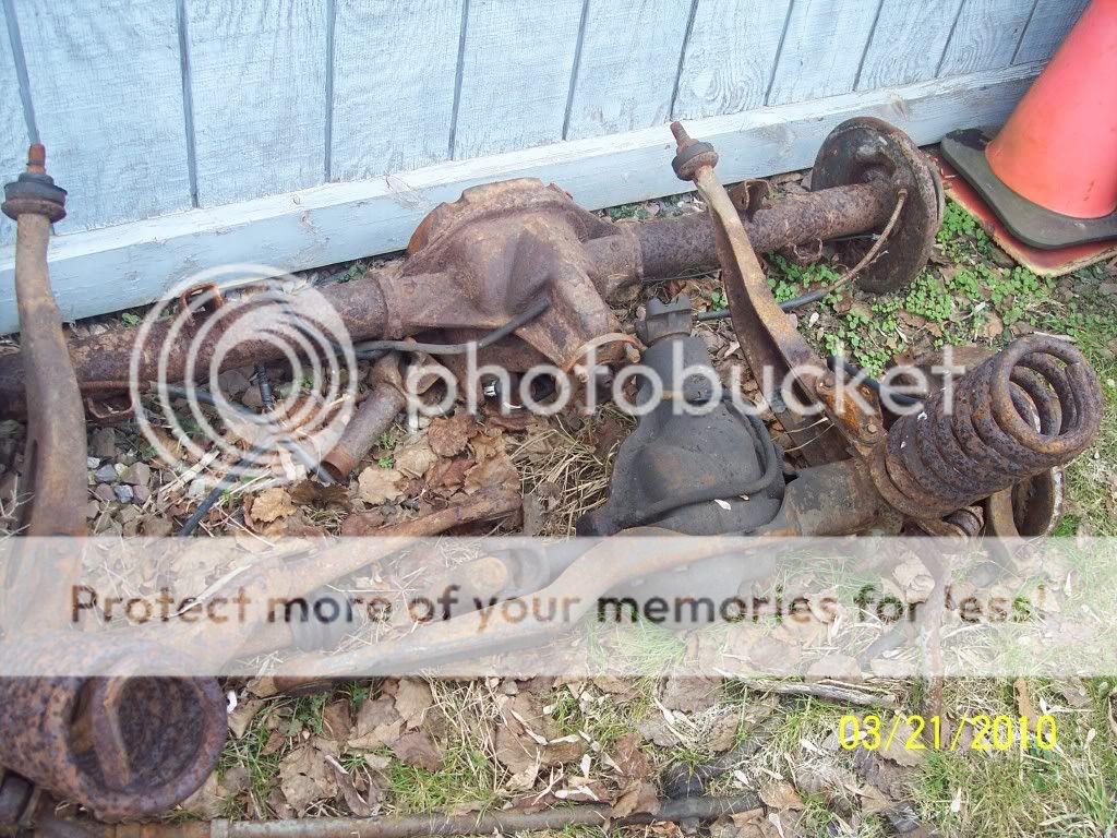

and here are the axles , they will get cleaned and painted first

i am gonna start stripping the axles tuesday after next , take all the steering components off , the sway bar , the springs , brakes , radius arms and third member off the front , and disassemble the rear , sand and paint the rear , i know the front has to be cut down to fit
