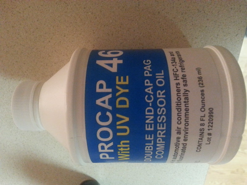

For oil, Ford uses PAG 46 in most of its R134a systems. I recommend getting the Double End Capped PAG 46, as it has much better lubricating qualities than regular PAG 46, plus the Double End Capped PAG oil does not absorb moisture. PAG 100 or PAG 150 are too thick. It is not very much more expensive, and for what you are paying to replace the compressor if getting new, it is worth the 2 or 3 bucks extra. I also got some special oil for the o-rings and fittings called Nylog. It is specifically designed to keep the o-rings pliable and prevent leaks.

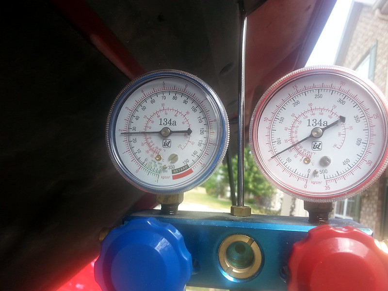

A Quick tip: before doing any work on the A/C, make sure all electrical connections (connector at the compressor, and the connector at the pressure switches), fuses and relays are good. Also check the blend doors in the dash, as this is a trouble spot for the Ranger. If any of these are bad, the A/C will not come on or will not work right. Also make sure the belt tensioner is working properly. Check the condenser to see if the fins need cleaning and / or straightening. If your condenser has all of the fins bent over you will have reduced airflow through the condenser and that will decrease the effectiveness of your A/C. You can get a fin comb from Harbor Freight for 5 bucks.
Tools: You will need access to some special tools for this fix. You will need an A/C manifold gauge set, and a vacuum pump to evacuate the system. You can buy the manifold gauge set at AutoZone or O’Reilly for about $90 or Harbor Freight for about $50. The pump is quite abit more expensive. I recommend borrowing or renting one for this, but Craigslist can be a source as well. I picked mine up on Craigslist for $35. Another option is the Harbor Freight vacuum pump that hooks up to your shop air compressor. This is only $20, but it will not pull a deep vacuum like a regular vacuum pump made for refrigeration will. *note, if using the Harbor freight vacuum pump that attaches to your air compressor, make sure your compressor can maintain at least 110 psi continually for the time that you are using it. Most home compressors do not have this capacity, so if you do not have a commercial compressor, you might be better off buying a used a/c vacuum pump. Also running an air compressor for an extended period of time will consume a lot of electricity, so be aware of that when you get your energy bill. If you are doing the air compressor vacuum route, I also recommend starting and warming the truck up before pulling the vacuum. The residual heat from the engine will help boil out the moisture at a much faster rate. If you warm up the truck before pulling the vacuum you can shorten the amount of time with the vacuum pump turned on. An hour or so should do the trick. (Thanks 4x4 Junkie!)

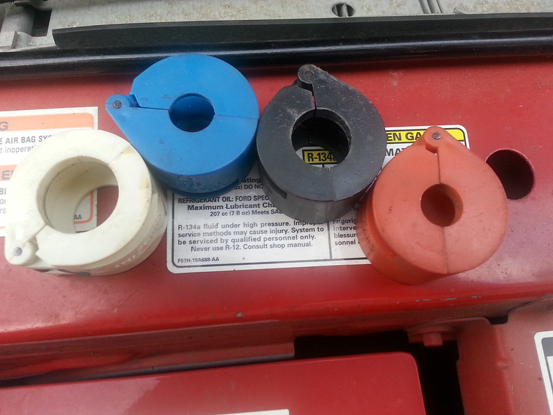

• A/C – Fuel line disconnect tools (3 different sizes)

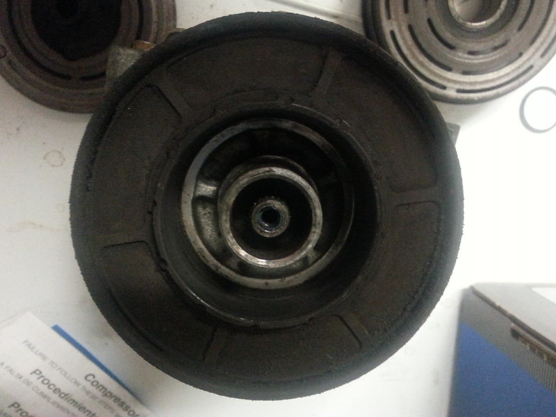

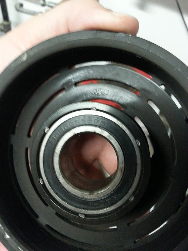

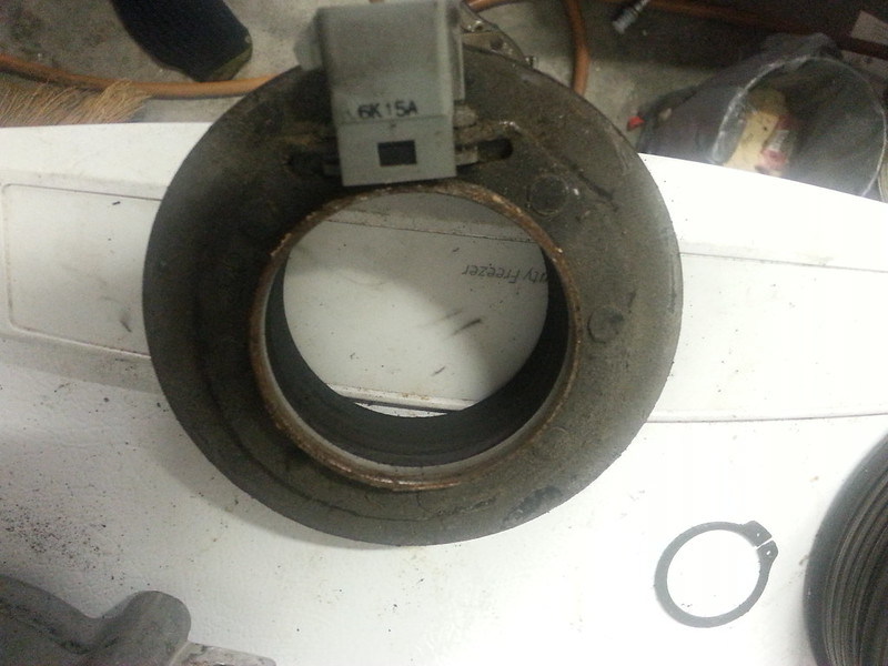

1. If you are replacing the bearing only, here is the part number from the OEM ford bearing: Nachi 30BG05S5DS
2. Remove the serpentine belt. This is done by placing a 3/8” breaker bar in the tensioner (located in the middle of the engine) and using it to take the tension off of the belt.
3. Disconnect the wire to the electromagnetic clutch.

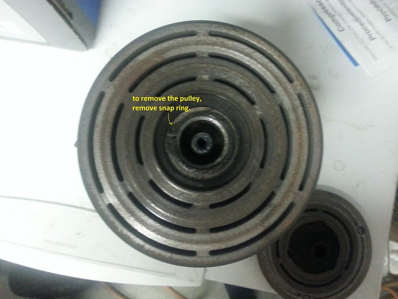

4. Remove the center bolt from the hub of the clutch assembly (8 mm) you will have to snap the wrench or ratchet quickly to keep the compressor shaft from turning while doing this. You can also get a spanner wrench to hold the compressor from turning.
5. Gently tap the screwdriver between the clutch plate and pulley with the hammer at several intervals around the clutch plate to remove the clutch plate and shim(s).
6. Remove the pulley and bearing assembly by removing the snap ring holding it on.
7. You will also need a three jaw puller or clutch puller tool to assist in removing the pulley assembly. Be careful when setting the jaw on the puller so that you do not damage the electrical connector to the coil. For replacing the bearing, you can remove just the pulley and not the coil if you set the jaws out far enough to just grip the pulley, but the coil is also pressed onto the shaft and will need a puller to remove. The coil is really pressed in hard and will need quite a bit of work to pull off. I do not recommend removing the coil if you just need to replace the pulley, bearing or clutch plate.
8. If there is oil all over the clutch from the compressor shaft, your life just got uglier. See replacing of compressor below. (You technically do not have to replace the compressor, just the seal to the shaft. And that requires removing the compressor…)
9. To install the clutch, if using the same clutch, installation is the reverse of removal. Be sure to align the socket for the power connector in the coil so that it is on top of the connector and sitting in the notch of the compressor housing. You will need to press the coil onto the shaft. A large socket will help seat the coil. Use the rubber hammer to set the pulley back on the shaft.
10. Installing a new clutch assembly or pulley will require you to set the movement distance (air gap) between the plate and the pulley face when the clutch is energized. This movement distance must be between .013” and .033” as measured with a feeler gauge.
11. If the distance between the clutch plate and pulley is outside of the minimum and maximum clearances, you will need to add or remove shims to get it into spec.
12. Torque the center bolt to 12 ft. lbs.

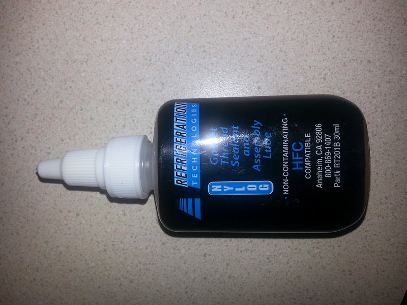

• Bottle of PAG 46 DEC oil
• Nylog
• PB blaster

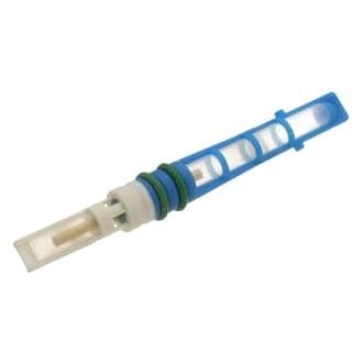

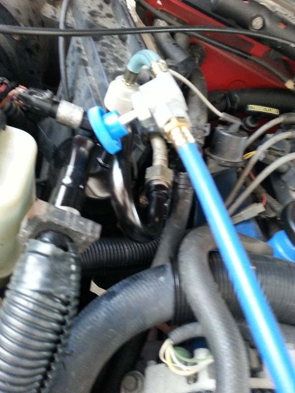

Section 4.
Part to be replaced: Orifice tube
Located in the lower tube coming out of the Evaporator core.
Tools and parts you will need:
• Safety Glasses
• Orifice tube removal tool
• Nylog
• New Orifice tube
• New Accumulator/ Dryer
Procedure:
1. Remove Accumulator/ Dryer (see section 3 for details)
2. Remove the metal keeper and use the second smallest A/C line disconnect tool (blue) and disconnect the short refrigerant line from the bottom line of the evaporator.
3. Use the Orifice tube tool to extract the orifice tube. You can also use a pair of needle nose pliers instead of the Orifice tube tool, but I could not get a grip on the orifice tube with the pliers I had, so rather than fight it for two hours, I went and bought the damn orifice tube tool. Made my life much easier……* Protip: Compressed air can be used to blow the orifice tube out if it is being stubborn. (wish I would have thought of that…Again thanks 4x4 Junkie for that helpful tip)
4. Make sure your new orifice tube matches the old, and pitch the old tube. Don’t bother trying to clean and reuse it, they are only $2.00, it isn’t worth it.
5. Be sure to put some PAG Oil on the o-rings of the new Orifice tube
6. Replace the o-rings and put Nylog or PAG Oil on them when hooking the line back up.

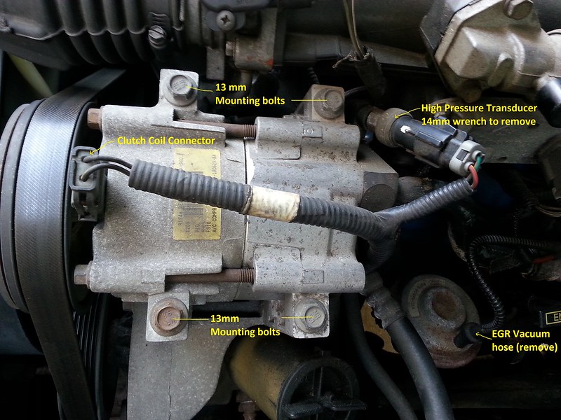

Section 5.
Part to be replaced: Compressor.
Located at the top of the engine on the driver side.
• Safety glasses
• 3/8” breaker bar
• ¼” flat blade screwdriver
• 13mm socket
• 8mm combination wrench
• 10mm combination wrench
• Ratchet
• Torque wrench
• Nylog
• New compressor
• New Orifice Tube
• New Accumulator /dryer
Procedure:
1. Disconnect the battery using the 8mm wrench.
2. Remove the rubber air intake pipe from the upper intake and remove the air filter box. You can leave the end that is attached to the inner fender in the truck. You will need to unhook a few sensors to do this. The pipe is clamped to the upper intake with a regular worm screw hose clamp. Use the screwdriver to loosen it several turns, and it will slide off. The air cleaner end has a spring clamp. Just undo it.
3. Remove the serpentine belt. This is done by inserting the 3/8” breaker bar into the square hole on the tensioner. Move the tensioner enough to slip the belt off of the idler pulley in the center of the belt path. Then remove the belt from the compressor. The tensioner is located just below the alternator on the passenger side.
4. Disconnect the connector to the electromagnetic clutch.
5. Unbolt the refrigerant lines using a 10 mm wrench. Pull the lines out of the compressor and set aside. This bolt is kind of hard to get to as the refrigerant lines and the intake manifold block easy access to it. You can break it loose and then by unbolting the compressor from the truck will make it easier to spin out.
6. Remove the four 13mm bolts holding the compressor onto the bracket.
7. The compressor should be free now to take out of the engine.
8. You will now need to clean/ purge the condenser and lines if you are reusing them. See Appendix A.

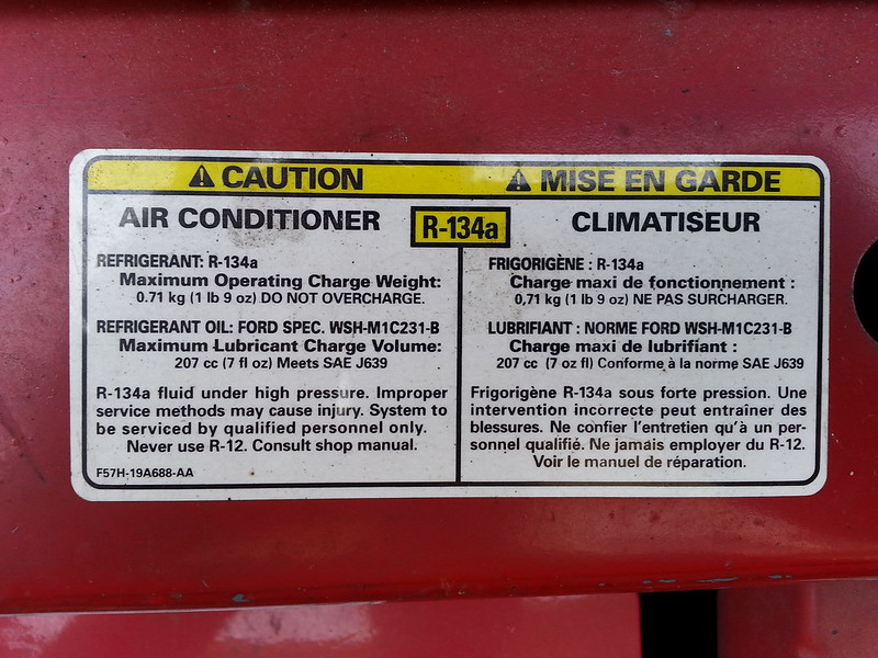

9. Installation is the reverse of removal. Be sure to put 5 ounces of PAG oil into the new compressor and stand it up on the clutch pulley for about ten minutes or so to ensure that the front seal gets lubricated before putting it in the truck. If you do not ensure that the front seal is properly lubricated, you will leak coolant through the front seal.
10. Protip: for measuring out proper amount of PAG Oil, my bottle did not have any markings to say how much was in it. Go to your local pharmacy (CVS, Walgreens etc, not your dealer or liquor store  ) and ask for an 8 oz medicine bottle. They are brown and have ounce marks on them, and work perfect for metering out just the right amount of oil.
11. Be sure to put two ounces of PAG oil in the accumulator/ dryer and an ounce in the evaporator.
12. When placing the new compressor in, make sure that the compressor sits flush on all four mounts of the mounting bracket. If the bracket is warped, straighten or replace the bracket entirely. If you mount it to a warped bracket, it will twist the compressor and cause it to leak.
13. Do not tighten the bolts until they are all in and finger tight, then torque them evenly until they are at 15-21 ft. lbs. DO NOT OVERTIGHTEN!!! Over tightening will cause leaks.
14. When hooking up the refrigerant lines, replace all of the o-rings and coat the new ones with some Nylog or PAG oil. Torque the 10mm manifold bolt to 13 – 17 ft. lbs.
15. Protip: I ended up unbolting my compressor so that I could bolt up the manifold to the compressor easier. It made all the difference, then I retorqued the compressor mounting bolts.
16. After you hook up the hoses, rotate the compressor 10- 12 times by hand to push the oil into the lines.

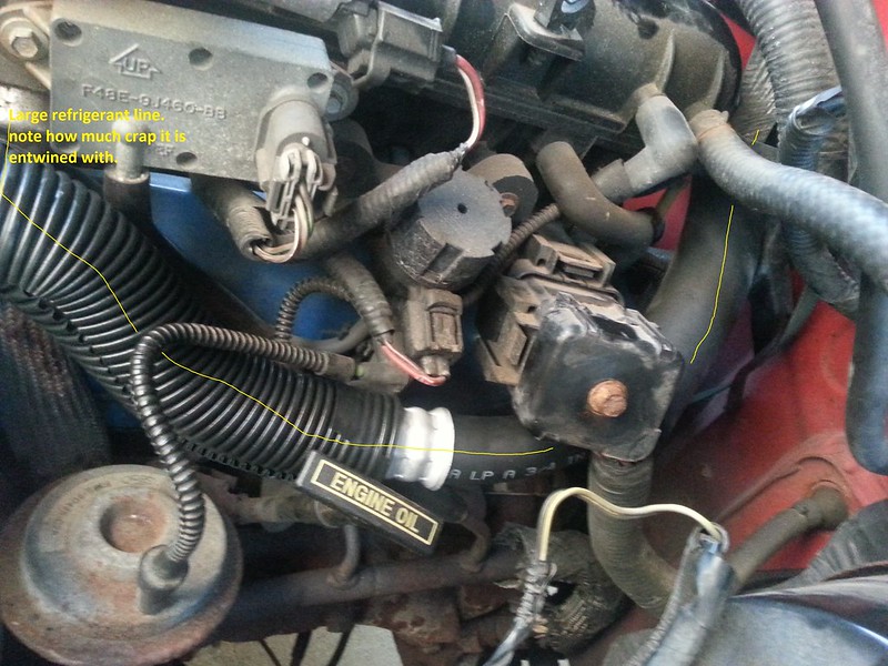

Section 6.
Part to be replaced: Large Refrigerant line assembly (the one that wraps around the back of the engine).
Located attached to the compressor and wrapped around the back of the engine and attached to the accumulator/ dryer.
• Safety Glasses
• 10mm socket
• 11mm deep well socket
• Dremel Tool with cut off wheel or grinder
• New Orifice tube
• Nylog
Procedure:
1. If available, kick a Ford engineer in the ass for this stupid setup. Otherwise, cuss him out.
2. Disconnect the battery using the 8mm wrench.
3. Remove the rubber air intake pipe from the upper intake and remove the air filter box. You can leave the end that is attached to the inner fender in the truck. You will need to unhook a few sensors to do this. The pipe is clamped to the upper intake with a regular worm screw hose clamp. Use the screwdriver to loosen it several turns, and it will slide off. The air cleaner end has a spring clamp. Just undo it.
4. Remove the Accumulator/ Dryer. (See section 3)
5. Remove High side pressure transducer. (See section 1)
6. Remove Refrigerant line assembly from the rear of the compressor by removing the 10mm bolt that holds it to the compressor.
7. Using the second smallest A/C disconnect tool (blue), unhook the small line that has the high side port from the condenser.
8. Now the fun begins…
9. Unbolt the engine wiring harness from the engine, right next to the driver side valve cover.
10. Unhook the vacuum line from the EGR valve (if equipped).
11. Unhook the brake booster line from one side. Does not matter which side, I choose the booster side because I did not need any tools to pop it out of the grommet
12. Using the 10mm socket, unbolt the engine wiring harness from the firewall.
13. Using the 11mm deep well socket, remove the nut that holds the bracket supporting the wiring harness (right next to the pigtail socket that you just unbolted in step 10) and pull the bracket off. This will now expose an 11 mm stud that secures the ground wire from the harness to the truck body.
14. Using the 11mm deep socket, remove the 11mm stud that secures the ground wires.
15. You will now need to remove the bracket that supports the hose at the rear passenger side of the block. I have no clue how it is fastened to the block, It is two tight of a space for me to get my hands in deep enough to even feel the cussing bolt let alone put a wrench/ socket on it… The bracket comes up from the rear of the cylinder head/ block and wraps around the refrigerant hose and is riveted to itself in a shape of a “P”.
16. My solution…. Take a Dremel tool and grind the rivet off. This will also be a chore as you will have to lean across the engine and the transmission dipstick tube is really close. Once the rivet is ground down, spread the bracket apart enough to drop the hose through the opening.
17. The new hose thankfully comes with a new bracket that is held to the hose with an 8mm bolt. Remove the bracket from the hose and reuse the old one still attached to the engine block and use a zip tie or small bolt to close it back up when reinstalling. I also used a piece of the foam insulation off of the old hose to act as a cushion on the new hose between the bracket and the hose.
18. You now have everything removed/ loosened and ready to pull the refrigerant line assembly out of the truck. Start by wiggling/ finagling the end that was hooked up to the accumulator/ dryer under the radiator hose and heater hoses. This will take some work to get them under these hoses, but then the hose should be free from that side. Gently pull the hose up and work it out from behind the engine. You will come out behind the wiring harness that was bolted into the firewall. Stop.
19. Go to the driver side of the truck and take the end where it bolted to the compressor and move it down and away from the compressor and out from under the wiring harness where it bolted to the engine harness. You will then need to finagle it around the brake booster hose and the throttle cable.
20. The refrigerant line should then come out. If replacing entirely, drain the oil out of the old one into a cup to measure out the same amount of new PAG oil to put in the new hose.

Disconnect tool:
How To:  Rebuild your A/C system
Springlock keepers, they can be removed using your hands only or a small screwdriver to pry them off:
• New Orifice tube
• Nylog

7. Replace the Orifice Tube (see section 4)
8. Be sure to replace and coat the o-rings with PAG oil or Nylog.

• PAG 46 DEC oil

Tools you will need:
• Safety glasses!
• Flush kit. I used a Mastercool A/C system flush kit. Got it off of Amazon for $45
• Flush solvent Ford recommends a terpine based solvent or Dura Flush for its A/C systems. I used turpentine for the initial flush to get the big gunk out, then the Dura Flush as a final flush, as the Dura Flush solvent cost $32 a quart…
• Shop air to charge the flush kit bottle.
• A metal catch can to reclaim the solvent as it comes out of the component. I used a 32 oz tomato juice can that I cleaned out.
• Paper towels
• Funnel
Procedure:
1. Put your safety glasses on!
2. Do NOT flush a compressor.
3. Do NOT flush an accumulator/ dryer or any hose with a filter permanently attached. Those items will need to be replaced.
4. Place the catch can at the end of the component being flushed. If flushing the component on the truck, be sure to put the catch can at the lowest opening. You may need to put a tube at the outlet end to reach the can. I was able to use the short refrigerant line plugged back into the bottom line of the evaporator, and the condenser was already in such a way that I did not need a hose or tube to extend from the condenser.
5. Assemble the hose and the nozzle on the flush kit.
6. Fill the flush kit bottle with the flush solvent to the half way mark and replace the cap/air fill nozzle assembly
7. Charge the bottle with shop air
8. Put the rubber tip in the opposite end from the catch can. Be sure that you firmly press the rubber tip into the part being flushed so that it seals well, and have the bottle tipped so that the hose is pointing down from the bottle.
9. Squeeze the trigger until all of the solvent and air are released from the flush bottle.
10. Get the catch can and then open the bottle. Put the funnel back in and a paper towel in the funnel to filter the solvent.
11. Put the solvent in the bottle and repeat steps 2 through 8 several times.
12. Once you feel that you flushed it enough, change out the solvent to a clean solvent and repeat steps 2 – 8 again, and then do it again with the Dura Flush as the last step.
13. Let the solvent evaporate out of the system for a few hours
14. I highly recommend putting a filter on the liquid line coming out of the condenser after flushing the condenser. The design of the condenser is such that it will be nearly impossible to flush all of the debris out of it. If you are getting a serious amount of black gunk out of it or your compressor died from the “black death” replace the condenser!

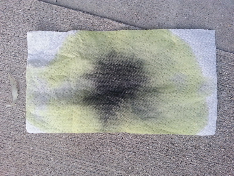

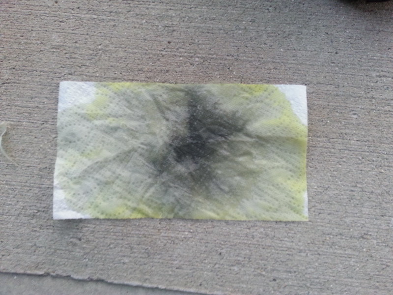

Reasons why you flush the evaporator and condenser...

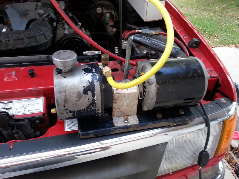

1. Hook up your manifold gauge set. Blue to Low side (top of accumulator/ dryer) Red to High side (refrigerant line behind driver’s headlight) Make sure all four of the valves are closed.
2. Hook the vacuum pump to the yellow hose on the gauge set. Make sure the valve on the pump is off.
3. Turn on the pump motor
4. Open all four valves on the gauge set
5. Open the valve on the pump.
6. Let the vacuum run and the low side gauge (blue) should show negative pressure. Let it pump down to as close to a negative full atmosphere as you can (this varies depending on altitude, see chart below) Normal atmospheric pressure is about 28 or 29 inches of Hg for people at 1000 to 1500 ft above sea level.
7. If it is not pumping down, you have a pretty good sized leak in your system somewhere.
8. After it gets down to the proper vacuum level, let the pump run for about 2 hours. If it is very warm and/or humid, let it run longer. On an extremely hot and humid day, let it run for 4+ hours. Running it longer than 4+ certainly won’t hurt. You can cut the time down on running the vacuum pump by starting the engine and letting it warm up to operating temperature. This will help boil out any moisture in the lines quicker. With the engine hot, your vacuum pull time will be about an hour or so, 2 on the very hot and humid days. Again running the vacuum longer won’t hurt it.

• The appropriate amount of refrigerant for your truck. (97 Ranger’s require 1lb 9oz or 25 Oz.)
Keep in mind, the only way you can accurately put the correct amount of refrigerant in is to evacuate the system and add the recommended amount of refrigerant and then stop. (25 ounces in the case of 1997 Ranger) Unless you have access to very expensive machines that can weigh and meter out the exact amount needed you will want to keep a very close eye on the pressure for both Low and High side, and the outside temperature and the inside the center left dash vent temperature to get you close to the mark. Remember, if you overcharge the system, you can break some expensive parts. A little bit of info that might make your life easier: 1 pound = 16 ounces. The common r134a can is 12 ounces. The sticker under the hood is rated in pounds and ounces (my 97 calls for 1 lb and 9 oz)

1. Make sure all 4 valves are closed on the manifold gauge set.
2. Hook the blue quick connect to the low side valve on the compressor. (Top of the Accumulator/ dryer)
3. Hook the red quick connect to the high side valve on the compressor. (Refrigerant line behind the driver side headlight)
4. Hang the gauge set from the hood making sure that none of the hoses can contact the belts or fan.
5. Let the yellow hose run from the gauge set so that it hangs over the bumper.
6. Take a can of refrigerant and put the tapping device/valve on the can and run the valve in to puncture the can. Keep the valve closed.
7. Attach the valve to the yellow hose.
8. Open the valve on the can
9. At the manifold end of the yellow hose, there should be a shrader valve to bleed off pressure. Open the valve on the refrigerant can and take a small screwdriver and depress the shrader valve until the refrigerant comes out of it. This purges the yellow hose of any regular air and moisture which you do not want in the system.
10. If this is just a recharge or “top off” SKIP to Step 14!!
11. With the truck off, open both the blue and red valves on the hoses next to the trucks refrigerant lines.
12. Open both valves on the manifold portion. This will allow refrigerant to equalize on both sides of the compressor.
13. Close the low side manifold valve.
14. Close the High side Manifold valve. You must do this before going to the next step!!

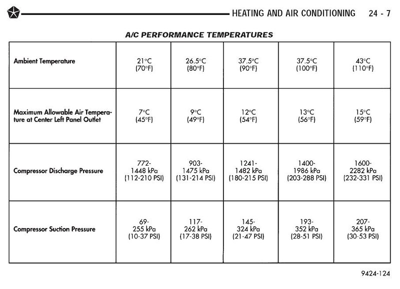

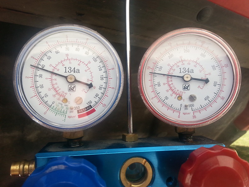

15. Start the truck, and with the A/C off, check the static pressure. To check the pressure, open both the blue and red valves on the hoses next to the car’s refrigerant lines. DO NOT OPEN THE VALVES ON THE MANIFOLD PORTION!!! If it is above 70 psi, you should have enough Refrigerant to cycle the compressor. A rule of thumb, your static pressure will be close to the outside (ambient) temperature when you are checking it.
16. Put the A/C controls to Max A/C and the blower on the highest setting. Make sure the A/C switch is on.
17. Make sure the engine is running and A/C is on full blast.
18. Look at the low side gauge (blue). It should read above 20 psi and below 55 psi depending on the temperature outside at the time. Your high side gauge (red) will be in the range of 100 psi to 350 psi, depending on how hot it is outside. When the engine fan kicks in, your high side pressure will drop quite a lot.
19. If you are doing a fill with the exact amount of refrigerant (25 oz for a 97 Ranger) you may add the rest of the refrigerant now. 2 full 12 oz cans and a smidge of a third can total. Do not add any more than this!! (if your Ranger is a different year, please look up the proper amount for your truck)
20. For a top off of a low charge system, if your low side pressure is below 20 psi, you can add refrigerant to the system via the yellow hose. Pay close attention to the pressure temperature chart when adding coolant. Something else to consider, if you are doing this on a cool day (below 65 degrees) you can easily overcharge the system and not know it, so I would recommend charging it on a day that is warmer than 70 degrees. If your High side pressure goes above 300 you are in danger of blowing out your condenser…
21. Now that you have the R134a can attached and the valve open, open the blue manifold valve. DO NOT OPEN THE RED ONE UNDER ANY CIRCUMSTANCE AS THE HIGH PRESSURE WILL CAUSE THE REFRIGERANT CAN TO EXPLODE!! Opening the blue valve allows the refrigerant to be pulled into the low side of the compressor to charge the system. Keep an eye on the gauges and charge the system until the low side is just under the low side pressure that correlates to the outside temperature. The high side should not get much higher than 350 psi on a hot day. On a cooler day, both your low and high side pressures will be lower. If you empty your refrigerant can, turn off the blue valve on the manifold before unhooking the empty can. Be sure to purge the yellow hose again when you attach the new can.
22. Protip: if you want the can of refrigerant to load a bit faster, get a pan of hot tap water (no need to put it on the stove to heat it, straight hot water will work) and dip the can in it as it fills. This will heat the refrigerant and make it fill a bit faster.
23. When you reach the desired pressure and temperature settings (as confirmed by your pressure/ temp chart), you should have nice cold air again. Close the blue manifold valve, close the refrigerant can valve (leave the can on the gauge set. This way you will not have to purge it the next time you use it…even if the can is empty, leave it on the gauge set, it will protect the yellow hose from getting contaminated with dirt.)
24. Your air temperature coming out of the middle vent in the dash should read as noted in the below table for the outside temperature listed. Since you cannot accurately measure how much refrigerant is in the system and how much you have added, I would keep an eye out on the temp pressure chart. Once the vents get close to the temps listed, stop filling.
25. Close both valves at the refrigerant lines. Turn the engine off and release the quick connects. Warning: they will be hot, especially the red or high side connection.
26. Replace the caps for the valves and put your tools away, you are done.

Another option is the Harbor Freight vacuum pump that hooks up to your shop air compressor. This is only $20, but it will not pull a deep vacuum like a regular vacuum pump made for refrigeration will. If you go this route, I would recommend to run it at least 12 hours, and to do the A/C repair and vacuum on a very dry non humid day.
12 hours with the shop compressor running will use a lot of electricity... What I would suggest instead is run the vehicle's engine up to full operating temp and then shut it off and run the vacuum pump for an hour or so. The residual heat from the engine will encourage much faster & more thorough evaporation of any moisture in the A/C system. Also, if your air compressor has difficulty maintaining at least 110 PSI while the pump is attached (most home/non-commercial compressors can't), it's vacuum performance will be greatly reduced (to the point if the engine isn't warm, it will not be able to boil all the moisture out of the system no matter how long you run it).
Compressed air can be used to blow the orifice tube out also (at least it worked both times for me).

6. Let the vacuum run and the low side gauge (blue) should show negative pressure. Let it pump down to about -28mm of Hg.
It should be inches/Hg. Also, 28 in/Hg may not be attainable if you live at high altitude. See this chart for what reading indicates full vacuum depending on your altitude.
Sea Level = 29.92 in-Hg
500 feet = 29.4 in-Hg
1000 feet = 28.9 in-Hg
1500 feet = 28.3 in-Hg
aarrrgghhh! :bangheadagainstdesk: Added as a protip.
I think you may have missed my post edit... (probably was while you were replying) With the engine hot, even the HF pump shouldn't need to be run for more than an hour (especially with a good compressor that can maintain pressure). One hour of electricity is a lot less than 12 lol (and is why I brought up preheating the engine).
I think with that harbor freight pump you would want to run a bit longer than an hour, but yeah 12 is a bit long :)

I did mine with the HF venturi pump, 30 minutes was all it needed.
With a bit of creativity, some boxboard, duct tape, and a leaf blower, I was able to get my twin-cyl 5HP Craftsman compressor to maintain right around 112 PSI... As a test, I put water (about 80°) inside a jar, hooked a hose up to the lid and it boiled (a hot engine will keep the A/C components much warmer than that). Without the "supercharging" though (lol) the compressor by itself could barely maintain even 100PSI and the water in the jar would not boil at all.

BTW, I just noticed your gauge pic (text) still says mm/Hg :icon_twisted: :D
Thanks for the input, and I don't know what you are talking about on the picture :p:icon_twisted::D
