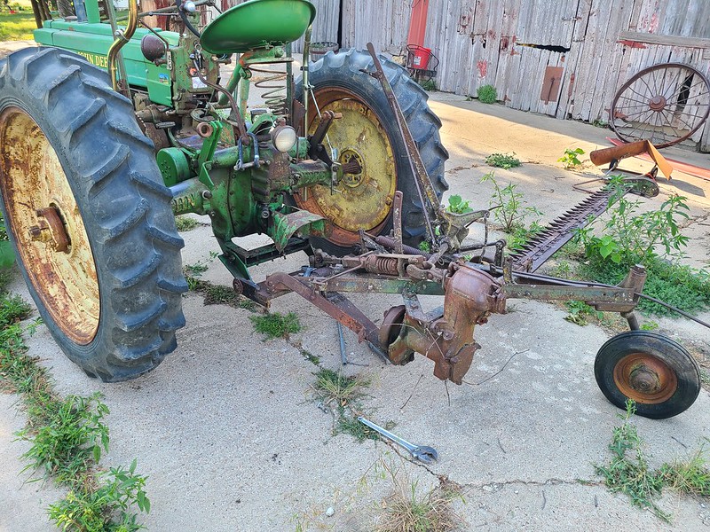

Mine needs a new tire too, it just uses a wheel barrow tire though. It holds air for a day... and on something that sits in the weeds 360 days a year that is good enough for now.
