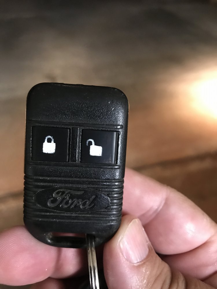

I have a 2002 Ranger Edge and I want to disable the horn beep when I lock or unlock the truck via the key fob. I only click once and the horn sounds.

Your picture doesn't look like the Fob in the owners manual, no Panic button, so.............

Door ajar light only works when truck is running. If I lock from the fob with door open the horn only sounds once. Double clicking on the remote doesn't do anything as the horn already sounded on the first click. Also, the truck doesn't have power locks. It's strange that all the key fob searches all have the panic button. I have yet to find one like mine.🤔
What’s the point in pressing the lock button if the truck doesn’t have power locks?
The key fob will lock and unlock the truck, but inside there's no power locks. Hope that makes sense.
Yes, it makes sense. It’s an add-on system, not factory installed.
+1 ^^^, yes, it was a dealer or previous owner add on, so won't follow Ford owners manual instructions
You will need to find the controller and disable the horn activation from there, there should be a brand or model number on it and hopefully you can find the wiring diagram for it on-line
