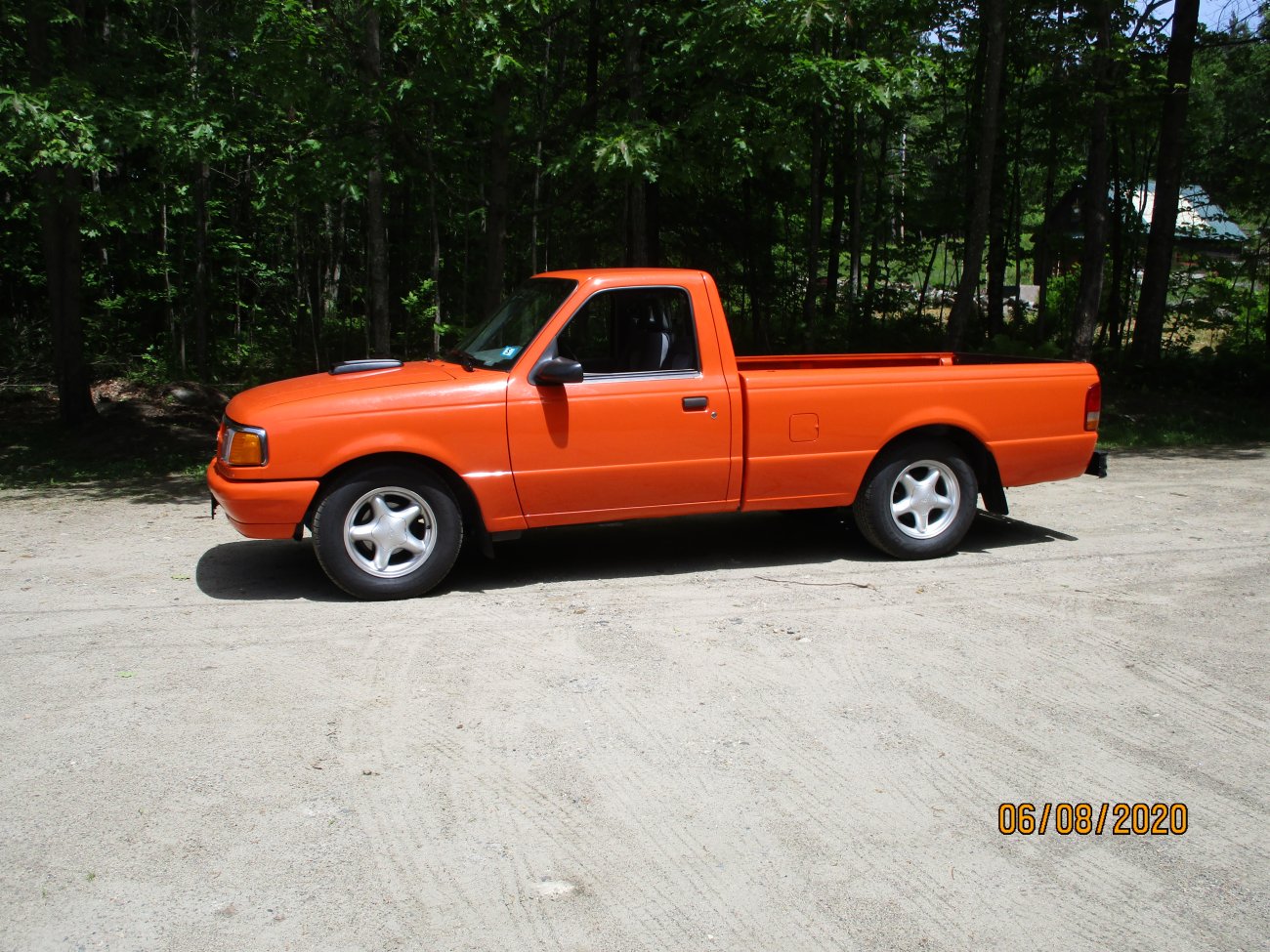

If you paid $500 for that truck it was a gift. I wanted an 83-88 short box to build my V8 Ranger and ended up with a 93 long box for $1500 because it wasn't rusty. It had no engine, transmission, gas tank, gas tank crossmember, heater box, a junk 8.8, and no brakes. It was in a car trailer when I looked at it so I didn't realise it was lowered- or that it was a long box. The front cab mounts were completely missing, the rear mounts were a hockey puck and a stack of washers on each side, and the under floor mounts had 7/16 bolts wound into 12mm threads so they barely held. The box was held on by 2 3/8 carriage bolts. I kept the dropped I beams and bushings because I didn't want to buy new stock arms.
