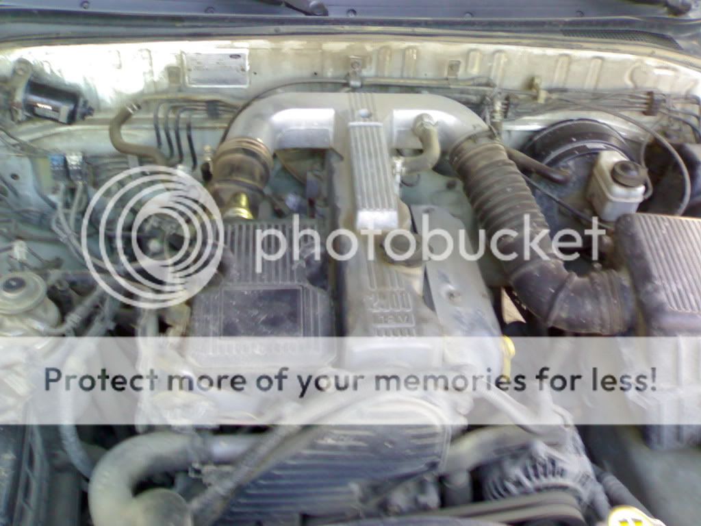

Take a picture of the engine. We may be able to tell you what you need to know.

Today I got message from Ford Thailand, they said it was launched to another country J, but there is good news is they sent me owners book !!! And now I know some information about my car.
Some details:
SOHC-12V in-line, 4-cylinder, W9 engine, (2,892 cc, 176.4 cu in).
