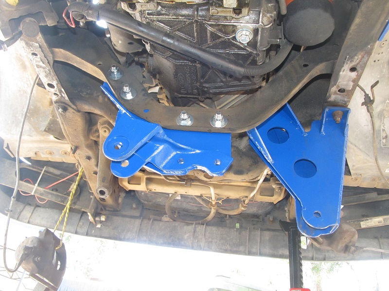

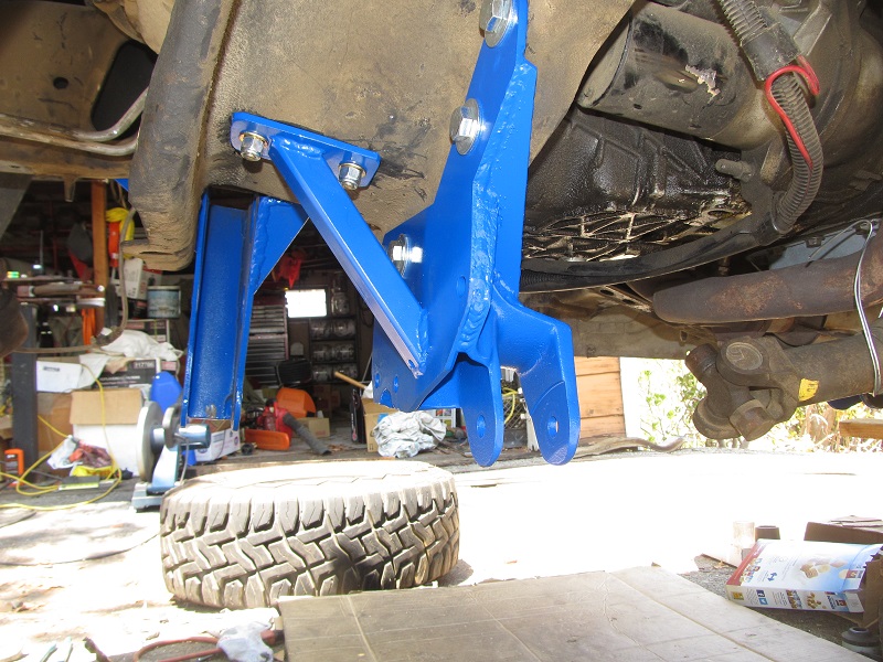

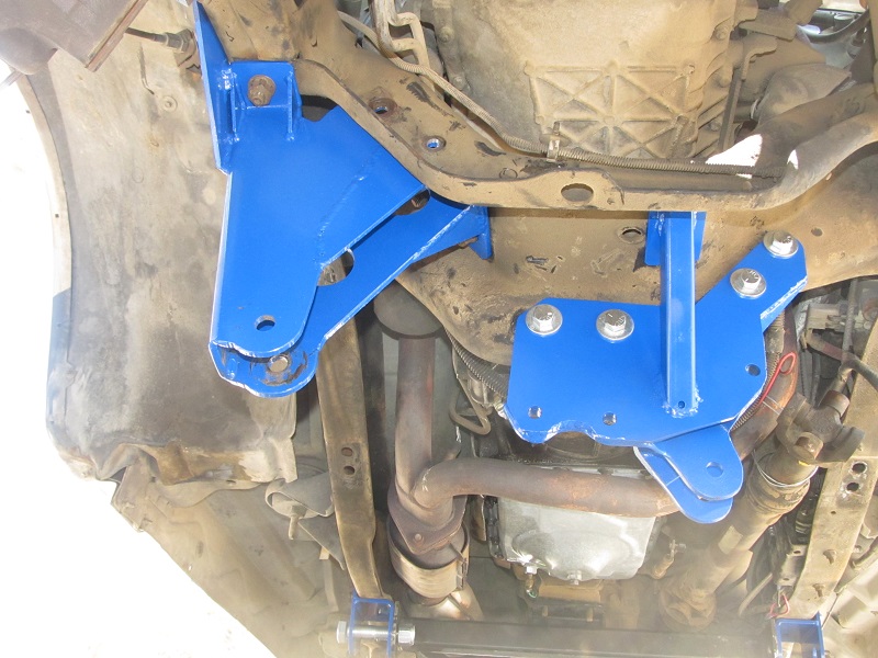

I helped a friend with this issue on an Explorer a few years ago (I believe his too was Rough Country)... What we did was cut away the offending part of the bracket assembly, then welded the bracket to the drop plate, followed by a gusset up top to further strengthen the area where we cut it. Also we added a brace to it, though this part probably isn't necessary on something not wheeled hard.
