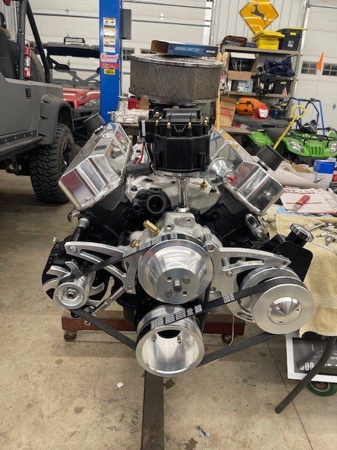

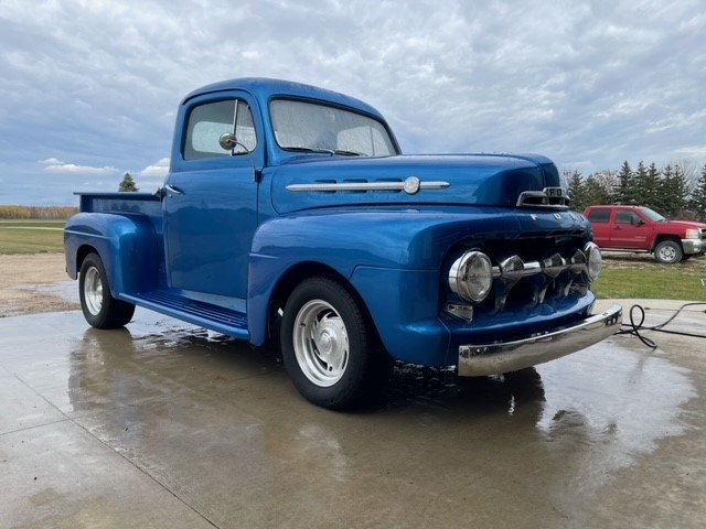

Richard how is this project coming along? I am currently in the middle of a 5.0/ 2002 2wd Ranger motor/frame swap into a 1952 Ford F1.
I am using a 8.8 out of an Mountaineer with the nice LS option. Just set the motor in lastnight and now onto the header adventure......
