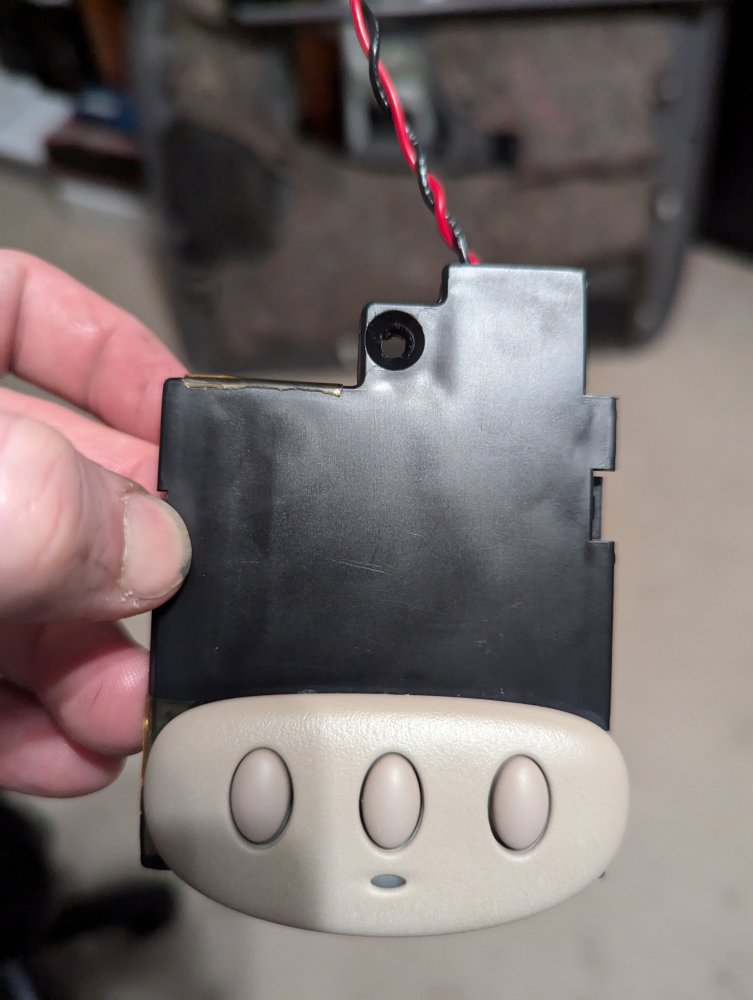

Picked this up from the JY today. Came out of a Toyota SUV. I was initially thinking I could rig it up behind the driver's side A-pillar but it's too wide.
Maybe if I gutted it out of the case it would fit?

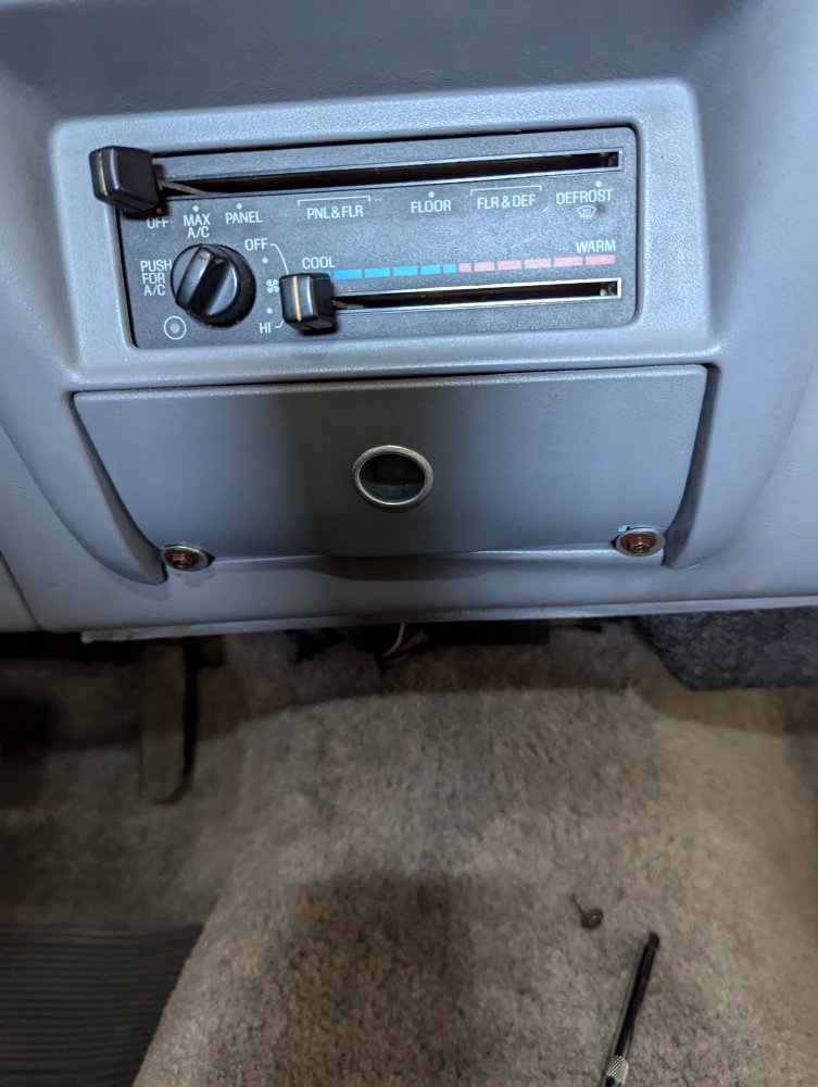

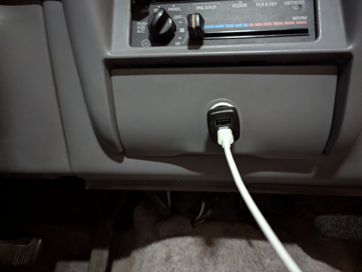

Do you use your ash tray?
Edit: Just saw you already have a power port there.
I do not. I also did this recently to it. I was thinking a long those lines as well but I was worried the signal wouldn't go very far if it was low like that.

I will have to take some measurements but looking at where the clips at the top there appear to stop there looks to ~half an inch of room. With the board removed from the homelink housing it might work.

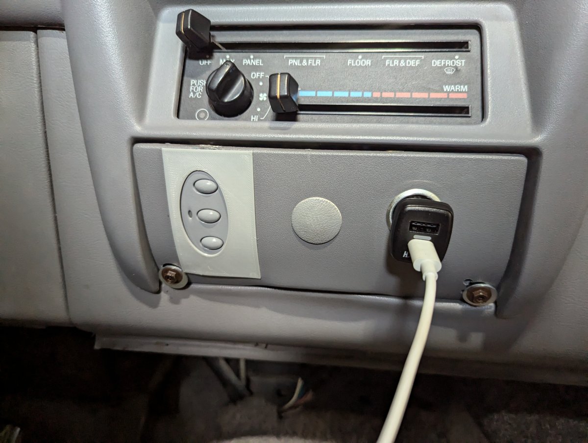

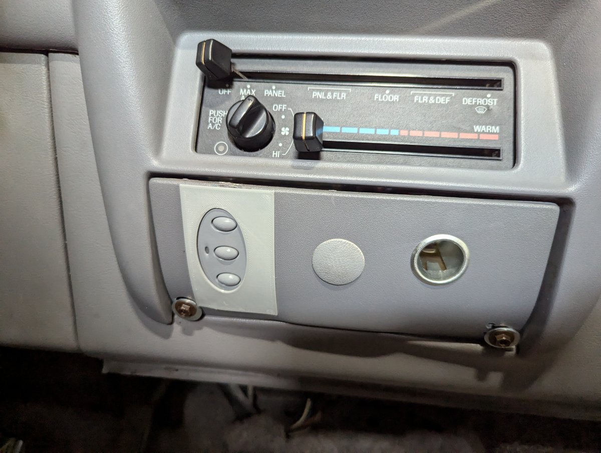

Well, I hobbled it together. I couldn't bring myself to cut the door cards. I've never seen another 93/94 ranger with the power locks/windows so I'm gathering they are hard to come by.
I would have done a number of things differently, but it's in there and it works!

Two main issues I ran into was the way the buttons connected to the actual PCB board. Could only fit ~1mm of something in there as a cover for the jagged hole I cut.
The curve of the ashtray cover was already more than that so I 3D printed a thin trim piece and molded it into place with a heat gun, then super glued it.
Second issue was I placed it probably 1/2 inch too high. The back of the homelink box interferes with the cover going back far enough into the recess so it sticks out a little further than I would like.
Will probably grab a new ashtray cover from the junkyard next time and give it another shot. Repainting the cover with my add-on trim piece would probably help it blend in better.

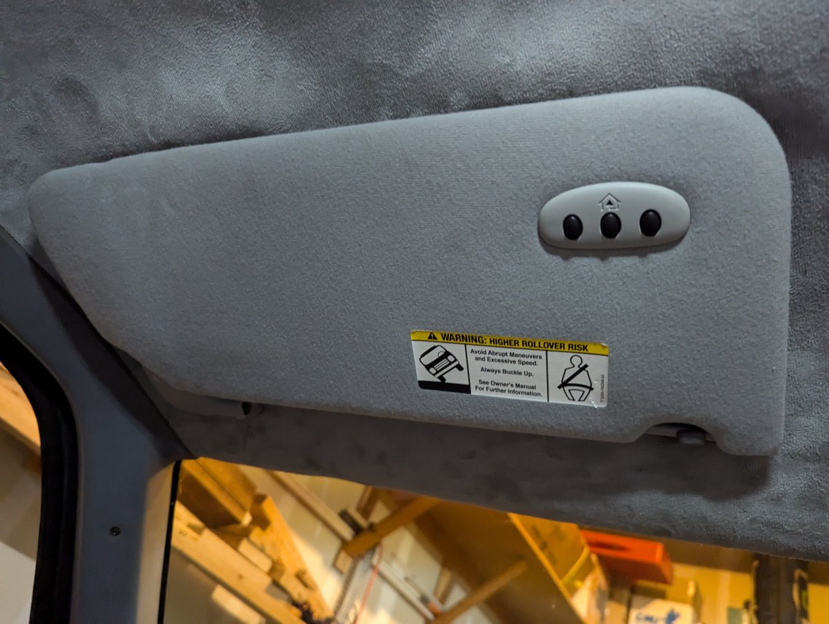

Happened to find homelink visors from an 04 expedition. So I ended up replacing my above hackery 😂
