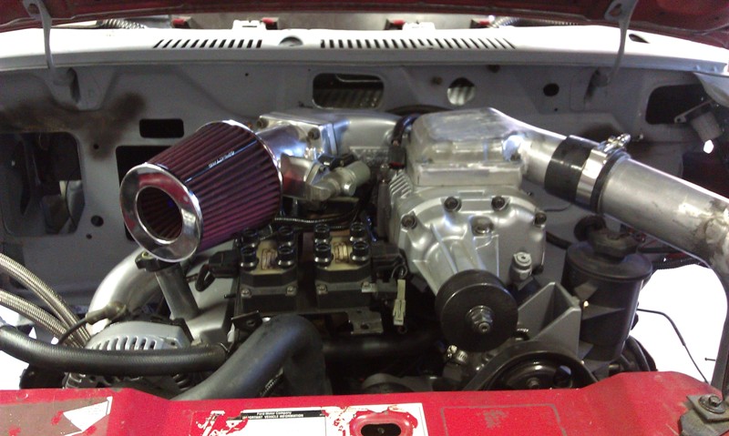

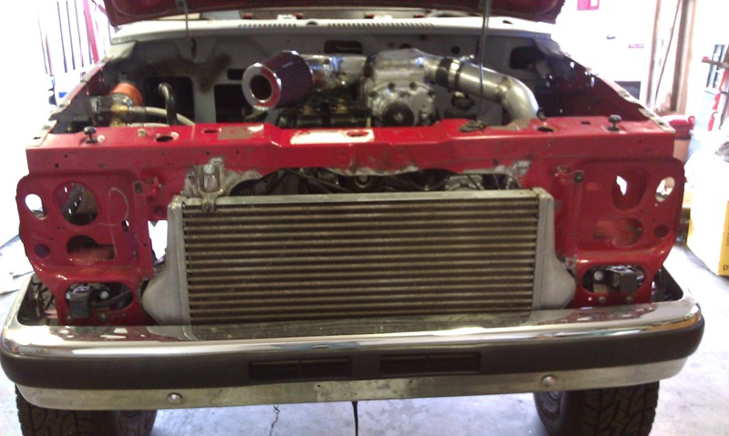

Okay, time for Dad to speak up. My sons horse power wishes are a little zealous. If he could make 500 rwh i'd help dasfinc eat his shoe. He might and i mean might reach 450 at the flywheel, but thats pushing it. As far as the blower goes it was sent to embre Machine an ported and polished before we aquired it. It was set up to put out around 16-19 lbs boost. The bearings have been upgraded to handle 19,000 rpm, which i would never attemp. i've set it up so it will spin max 14,000 at 6500 rpm max The company in forest grove Oregon that specializes in eaton blowers is Magnum Powers, they make some realy nice stuff. I've spoke to the owner a couple of times about setting this up. I recomend anyone with a eaton check out his site http://www.magnumpowers.com/. The tuner is going to be Adam Marrer of Pops racing via remote desktop. if i can figure out this picture posting thing i'll put some pics on. And i am old.

It looks like it is coming together nicely, and I like what you have done, but it sounds like you don't understand CFM/Supercharger efficiency either.
My setup has a 2.0 pulley on a Magnuson MP90 Charger, and puts out 8PSI.
Stock internals on a 5.0 cannot take much more than 8.0PSI safely or reliably. If that blower makes 19PSI, his power goals would be achievable, but the block would still crack in half long before then.
My 2.3 pulley made 5PSI.
I know you are using an over-sized crank pulley to my understanding to get it to spin faster, but again:
A) Stock 5.0 internals do not like more than 8PSI
B) I've never seen an M90 blower make close to 19PSI on a V-8, it just doesn't move enough air. Does't matter how much the blower is modified. Infact, I don't think I've seen any Eaton M112's make over 18PSI on Cobras...
Stock 2003-2004 Cobra's only push 8-10PSI with the M112.
A STOCK M112 blower spinning at 19,000 RPM at 6500RPM and makes right about 15PSI on the 4.6 Cobra V-8. an M90 spinning at 14,000 will not even make remotely close to that. I'm sorry to be so firm on this, but an M90 just doesn't have this kind of efficiency.
I will eat my UNDERWEAR if it makes more than 15PSI of boost and doesn't instantly explode.

You miss-understood me. I have no desire to make 16-19 psi. I would be happy if we could reach 8. And yes I know the stock block can’t handle much more than that. The motor we got the blower off of was set up to run 16-19 psi. And it had a lot of mods done to it. I personally don’t care how much power it makes I just want the thing to run when where done. To much power would mean more money out of my pocket to beef up drivelines, clutches, tranny’s and so on. I just want this to be a fun truck that will turn a few heads.

The earlier post from I assume your son? Had me thinking he had assumed since it made 16+lbs on a Supercoupe it could do it on the 5.0 also. I was worried that you were both putting all this work/time/money into this project without a firm understanding of CFM and M90 efficiency/limitations.
a 350-375whp goal is a safe, and achievable goal with what you have done, and plan to do, and MORE than enough for our little trucks.
My truck at 8PSI with everything mentioned previously is an absolute hoot to drive, and I'm sure you will both enjoy the heck out of it.
Be sure to get a Wideband installed, and suitable injectors. I'm running 30lber's, and it doesn't seem to be enough to feed my truck up to 6K RPM at 8PSI.
I have 42lb'rs plus i put in 3/8 fuel line to help. I'm just worried about detonation problems with the crappy gas we now have. Adam Marrer gave me a lot of assurance he can get it to run well but it might be a bear to start the first time. I have the explorer sll4 computer, need to get a moates quarterhorse and will be also be getting the Innovate mtx-l wideband for it. i was intregged by the distributerless ignition setup the system can run. it also gave me more room for the eaton. And at 375whp it should flat ars move. Adam did project 550ft lbs of torque, which scares me a little. I know what that does to 8.8 diff's and clutches and trannys, being a big block guy myself

My truck Dynoed 250whp/300wtq at 5psi with an otherwise bone stock motor.
I think 550wtq is a bit optimistic as well, I think 420-450wtq would be a more realistic neighborhood. There is a Twin Turbo V-8 ranger on www.rangerpowersports.com who is 408whp/491wtq at 10PSI. Turbo's are WAAAAAAY more efficient though, so it being "only 2 more PSI" does not equal that kind of HP/tq on a roots blower.
