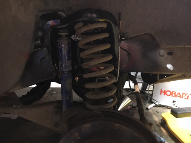

Here it is all put back together. I still need to finish the brake line I broke while taking out the old bracket. The parts for that have taken a long time to arrive. The ATS bracket appears to be identical to the original one. It bolted right up except for the holes on the bottom side of the frame (due to the offset from my reinforcing plate.
