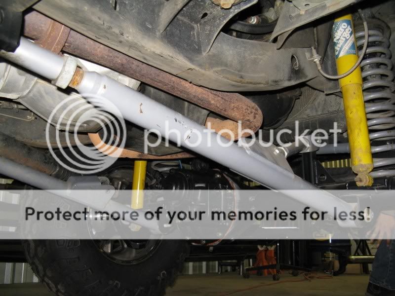

True hi 9.
Totalled,
Do you have info on this? I see it is in the front, but what is the center section, flpped, currie, other?
It looks like its been off set, is this correct?
Totalled,
its made by HI-9, its the only TRUE High pinion 9".
