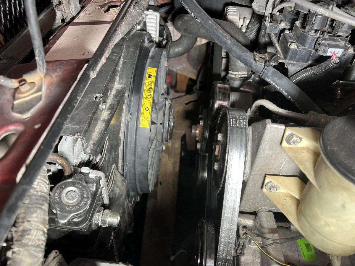

I like the Volvo fans. Two speed, self contained relay.
@Elutheros - how did you secure the bottom of the Volvo shroud in your application? I am about to install that in my truck and have not decided the best way.
On the regular Explorer double core radiator the bottom of the plastic shroud slipped right into the clips on the bottom of the radiator. Since I installed the taller Explorer radiator I haven't put anything there to hold the plastic shroud against the radiator. Your question reminded me I have to do something about that. :) I think one small straight bracket to the bottom aluminum of the radiator will be enough.
