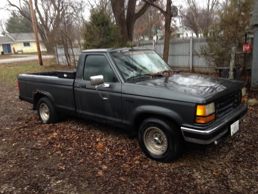

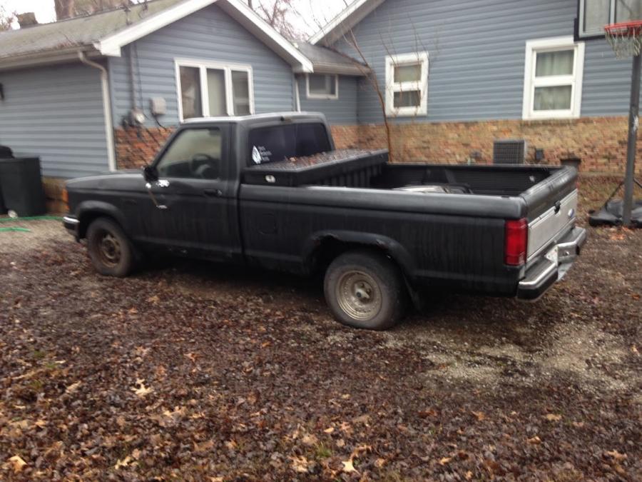

More pics soon. Those pics are the Craigslist Pics before i bought it.
