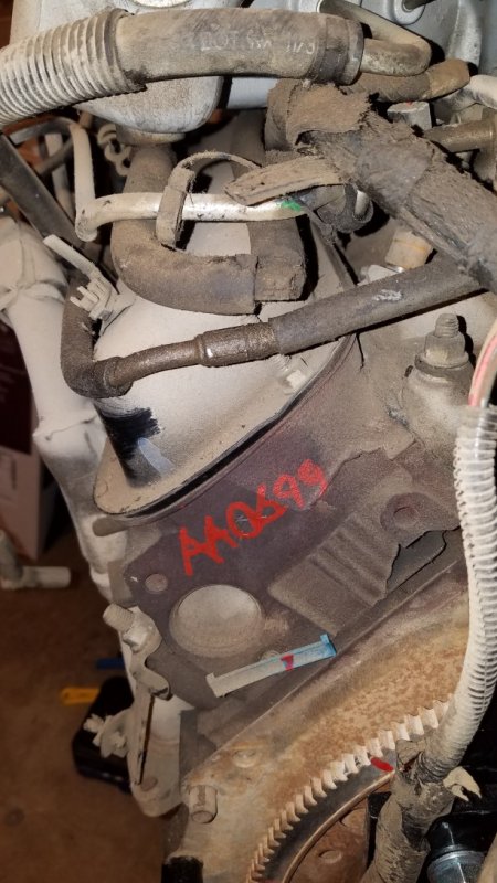

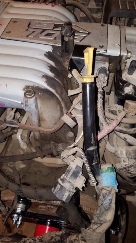

Help Identify 96 Explorer 5.0
post a picture of the heads in the back.
That's a later throttle body for sure

Those are gt40p heads... it's a late 97+ engine.
Yep, External egr pipe, single fuel line, 1999 or newer.

Cleaned the top of the engine and underneath all the grease is white paint. That's not normal right? Paint goes all the way under like it was taken off and painted. This engine will probably not go into my truck. I will still look for a 96 or 97. Going to try and look for some photos of 96 and 97 engines that would help me identify them better. Thanks for all your help.

See the 4 bars cast into the head, next to the freeze out plug. That's means it's a gt40p head. (Late 97+).
If it has 3 bars it's a gt40 head. They were used on 96-97 engines.
It's that simple.
It's that simple.
