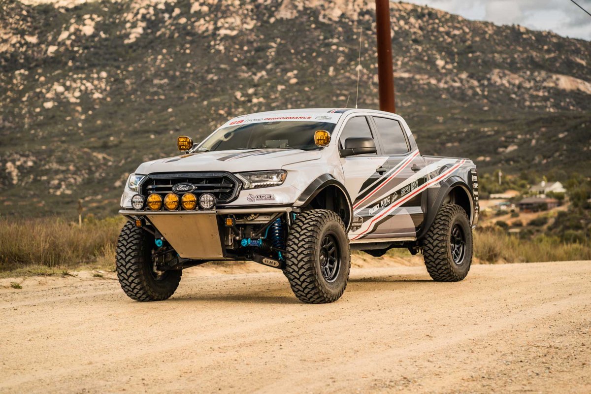

Here's a really sharp truck and you can see it has appreciably more clearance under it - not unlimited (differential). Not sure what the tires are but for sure not oem. So if I had that truck then I would have gone right through that crossing no problem. Now if I could set my truck up like that I'd be happy.
I think I'm looking at some money in the front suspension and custom body panels on there. I'm thinking of getting those tires they say they're not horrible noisy. I'm guessing those are probably 33" tires on 15" rims.

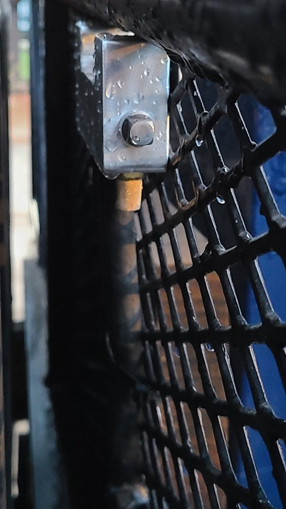

One thing to do ahead of time, if you're going to be hitting deep water, is to extend the breather vent hoses to a higher location. Your transfer case and both axles have vent tubes with a little fitting on the end to keep dirt out but allow air to enter or exit. Get longer pieces of hose and replace those. Get the vented end up as high as you can. If these vents are in good condition, they give the axles an easy place to breathe and minimize the chance of ingesting water when they need to draw air in due to cooling and contracting components. Doesn't help for front wheel bearings, though. You just have to have good seals there.

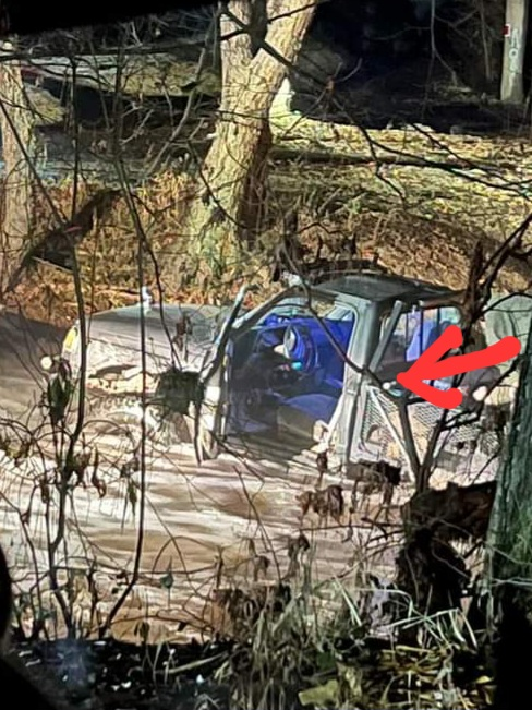

I recently built a little manifold and installed it on the front of the truck bed between the bed and cab. I ran all 3 hoses to that manifold.
In my recent creek dunking, those vents were still at least 24" above the water level.
