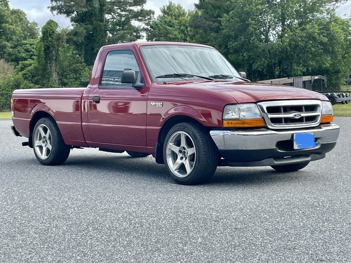

Hello, I'm New To TRS and this is my Ranger
Hey guys, I am new here and figured I would introduce my truck.
I have a 3.0 Ranger XLT that I drive pretty everywhere.
Here are the specs as of now:
  • 2WD
  • 3.0 Flexfuel
  • 7.5 rear end with 3.73 gears
  • 4R44E Transmission
  • Lowered 3" front and 5" rear
  • Front and rear swaybars
  • Cobra replica wheels from LMR on 207s
The truck was painted around 6 months ago and was lowered around that time as well. Original leaf springs were worn out and caused the rear end to shift laterally towards one side and sagged a little. New springs have 4 leafs as opposed to 3 and definitely a bumpier ride, but the shift and sagging were corrected. Currently looking for more ways to tighten up the handling on this truck; the lowering kit came with slightly stiffer shocks and I added rear swaybar from a Mazda B3000. The rear swaybar did wonders for the handling, now the rear end of the truck is pulled into the turn and there is significantly less body roll. Steering still feels too soft, so I have my eye on a set of polyurethane bushings for the steering rack here (I just need to make sure they will fit) I installed cam adjusters for the upper control arms to fix the insane amount of camber after lowering the truck. Now it is somewhere between 1-0.5 degrees as opposed to 2-3 degrees.
I haven't done too much research on the power steering system, but I am hoping there is a way to change the steering ratio. I have plans to autocross the truck so that is why I am so particular about handling.

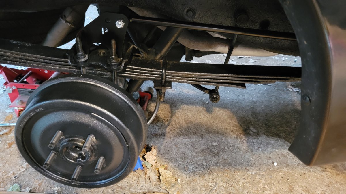

We are on a similar journey. I put in a larger '97 Ford Explorer Sway Bar (thanks to the advice of some of the older members). It did wonders for the front. I've been looking for something similar to replace the rear, but no such luck so far. I stiffened up the stock bar by adding a set of leaf spring clamps, putting each clamp about 6" in front of the axle. You can get the clamps for about $17.00 at Summit Racing or Auto Zone: a very noticeable improvement. They will improve what you have already done. I am one of those who likes the James Duff traction bars which minimize axle wrap and make shifting smoother.
James Duff traction bar and leaf spring clamp mounted 6" in front of the axle.

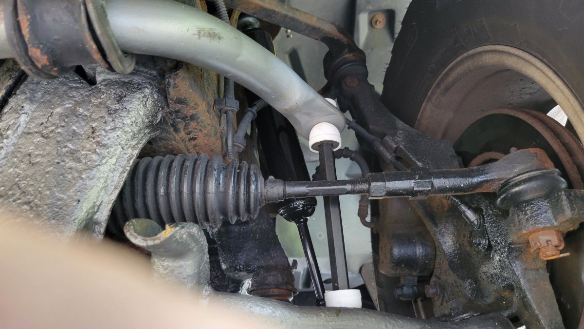

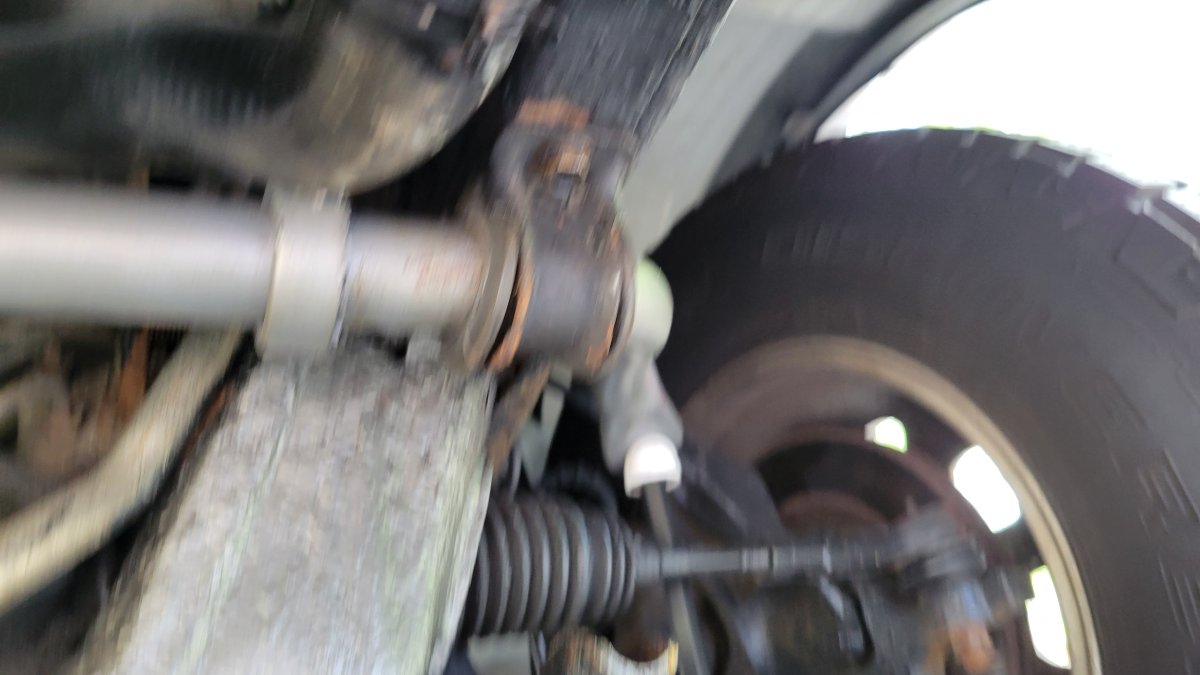

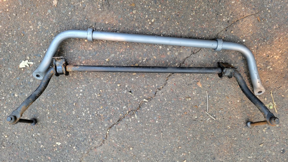

It's clear those two in the photo don't match. How do you bolt it up that way?
It bolts up just fine. It may be different, but the distance from hole to hole is the same. The problem is the two bushings that hold the sway bar to the frame. They are much larger than the originals so i just kept cranking them down tighter and tighter.
Note the old stock bracket has been wrenched down tight on the larger bushings: not very pretty, but it works.

Hey so it has been a while, but it turns out the exploder swaybars do not seem to have the clearance for coil springs. The swaybar on my coil spring ranger is 41.5 inches hole to hole, and the explorer swaybar I picked up is 39.5 inches hole to hole. It also doesn't clear the frame. It was $10 at the salvage yard so I don't care too much. Were there any coil sprung SLA explorers? Can't seem to find any info.
I seem to have read somewhere here on the Forum that a front sway bar from an Explorer will swap with a Ranger, provided both are from the same year. That's what I did and it worked. Note that Explorers offered 2 different sizes; one about 5/8" like the Ranger, the other about 1" which is stiffer.
My '03 Ranger Edge has a torsion bar of course, but I remember looking twice and noticing that the new bar would have easily cleared a coil spring.
The smaller Ranger bar and the Explorer. The holes are the same distance apart. The Explorer has plenty of room to clear the coild springs.
Hmm. Didn't clear mine and it was off of a 99 explorer. It clears the coil springs fine, but not the part of the frame that holds the coil springs. It also did not line up with my end links. It was too short.
