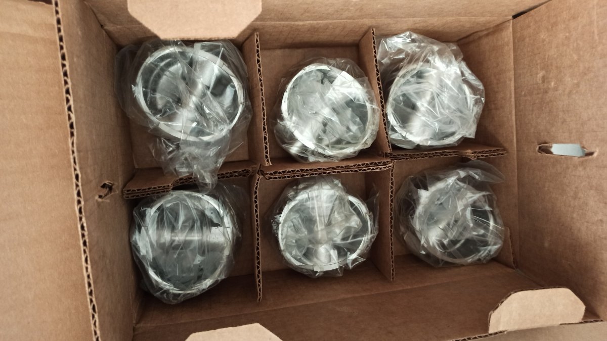

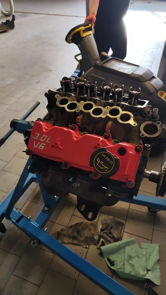

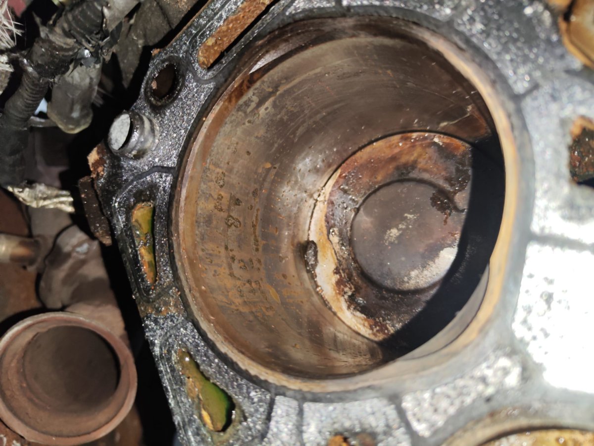

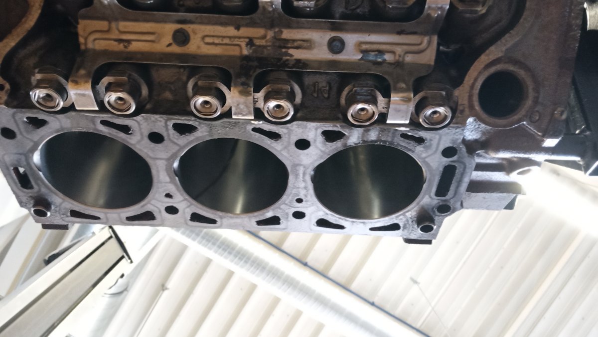

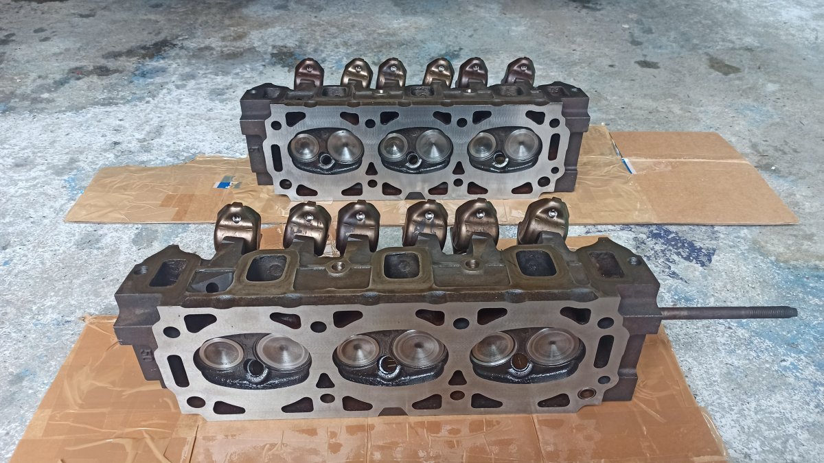

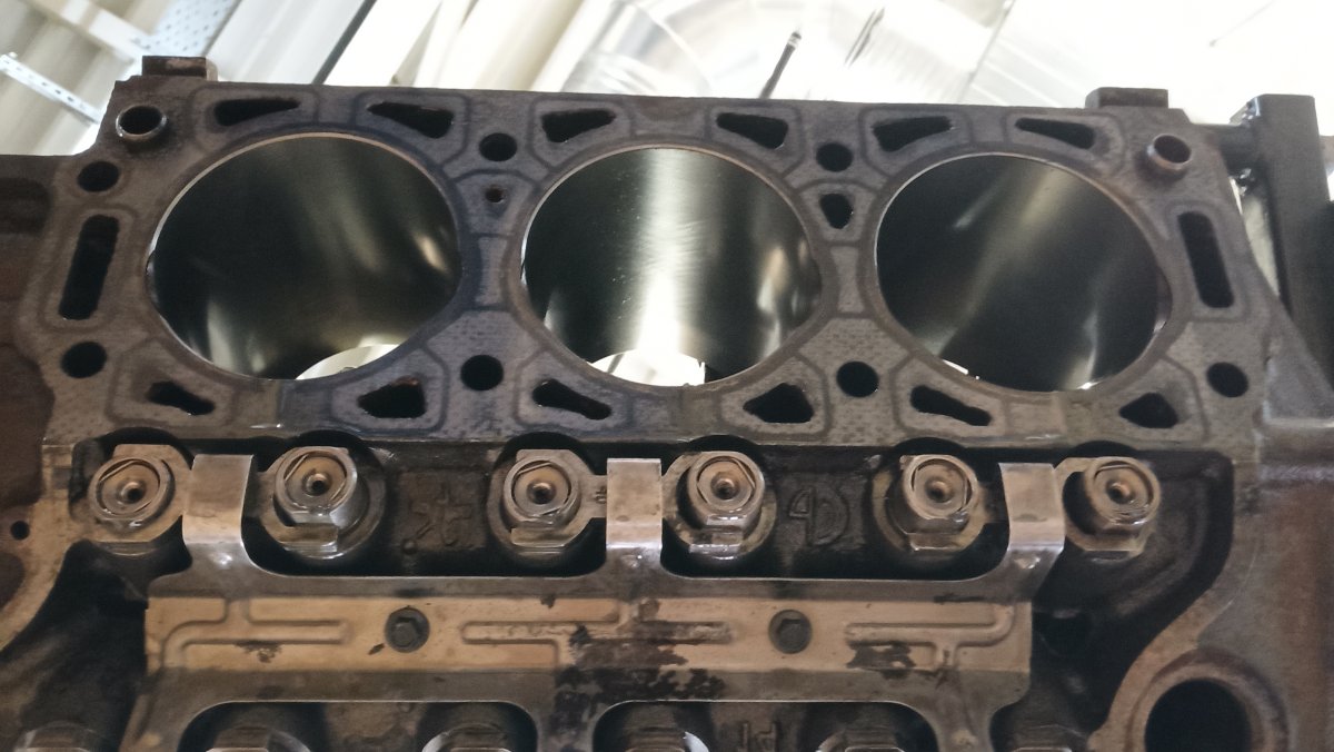

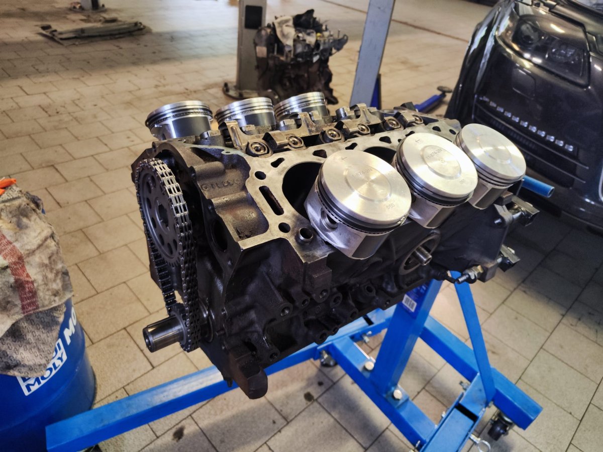

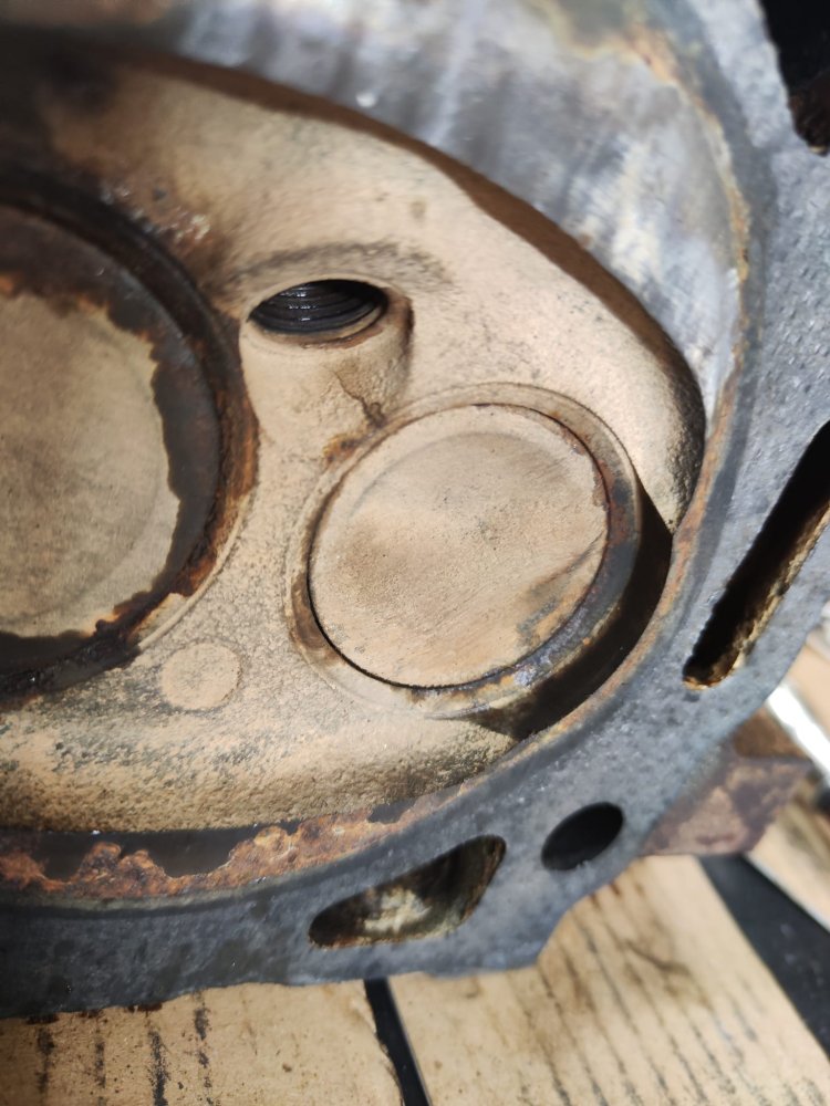

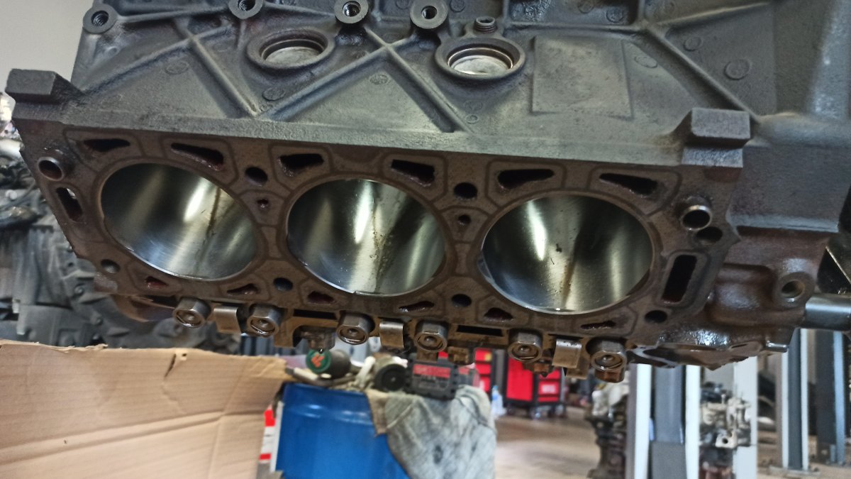

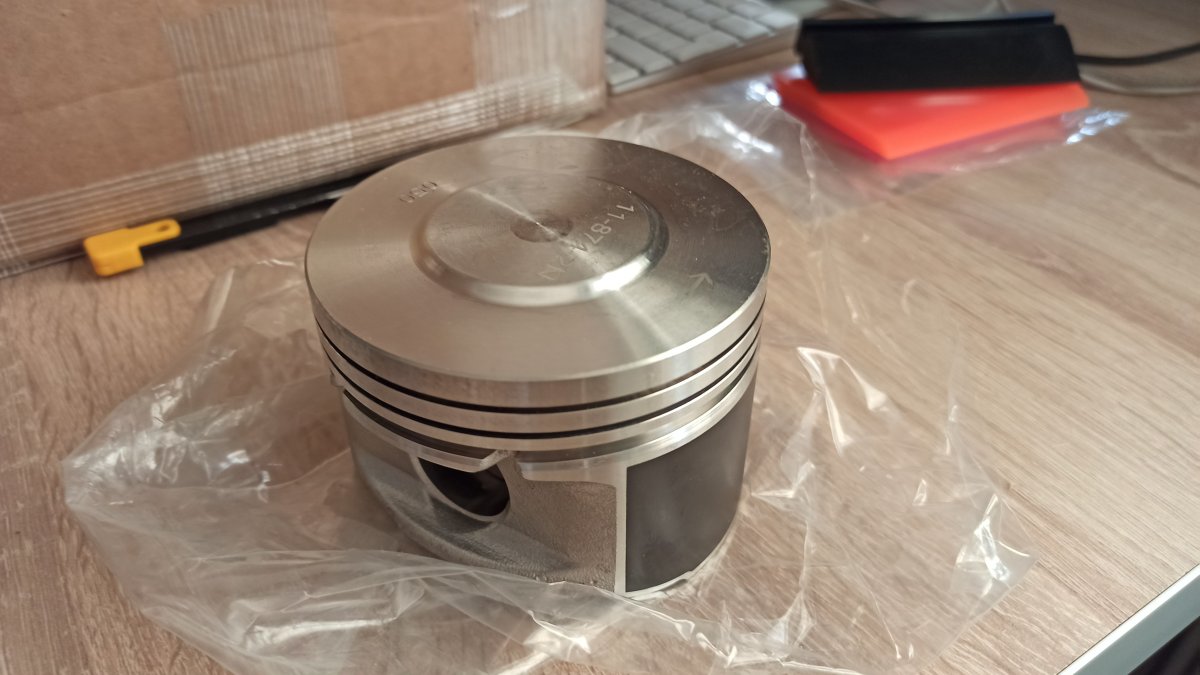

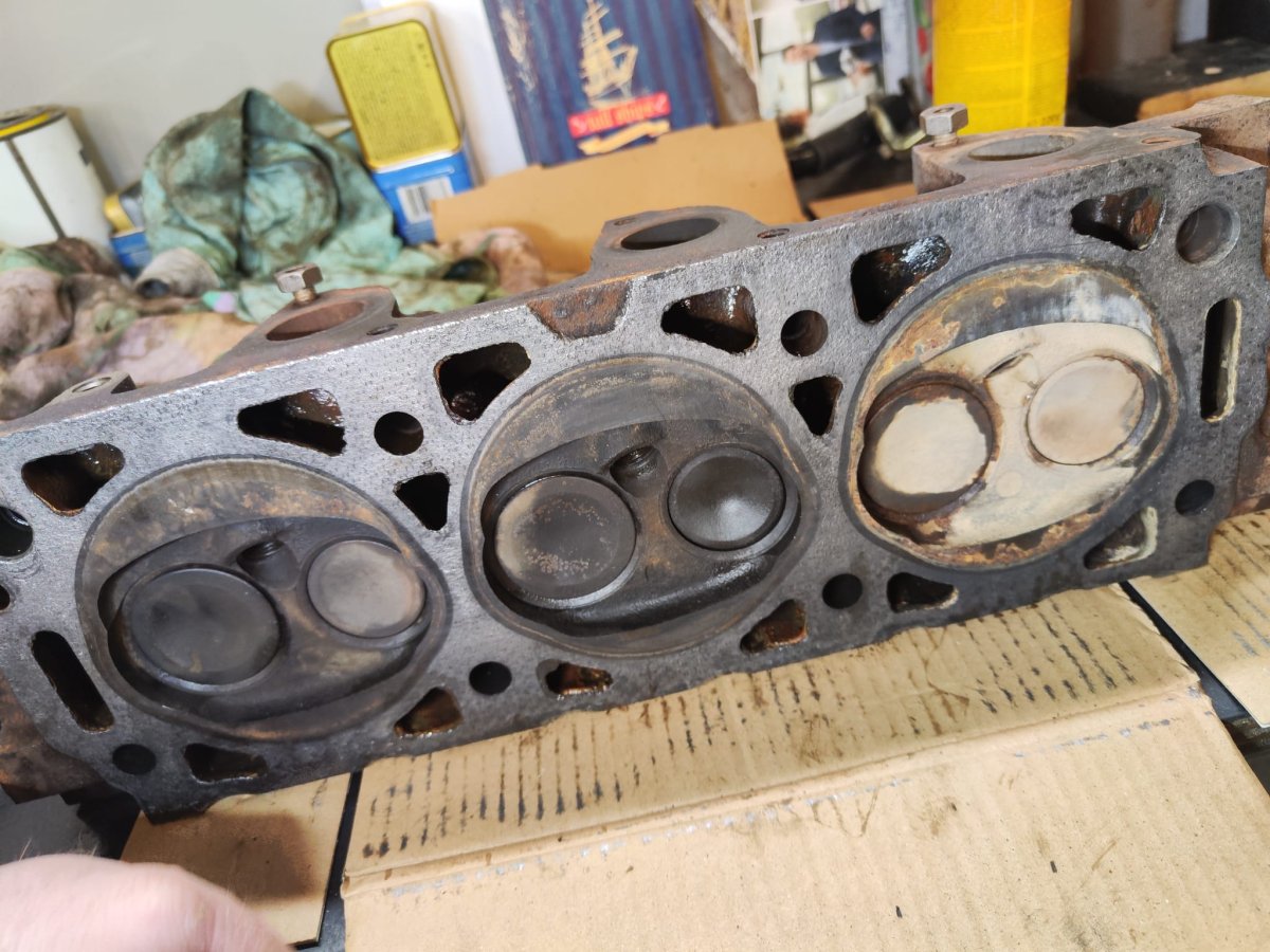

This is 3.0 Vulcan Engine , its under construction now :) Heads are cracked , pistons and rings needs to be replaced, and cylinders remachined. I hope it will be worked. Bottom end is in mint condition.

Sounds as though the engine overheated. You should look at replacing the radiator, because the existing one is probably clogged.

Engine was a real crap:

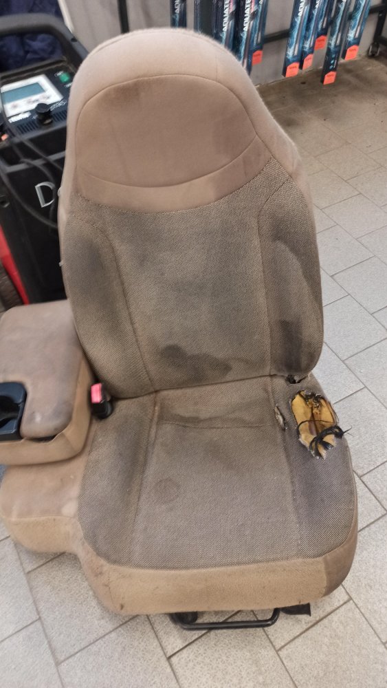

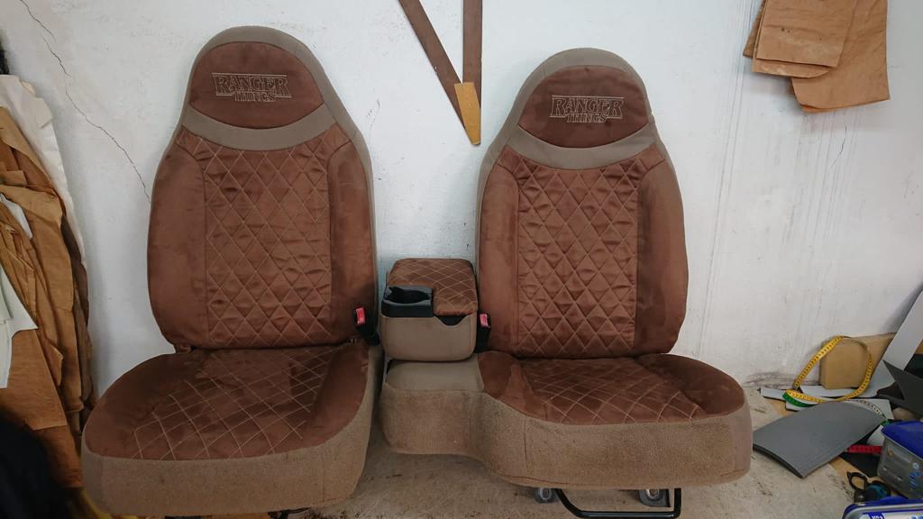

I've never seen stranger things.. but yeah.. those seats are suuuuuper awesome.
me either, but the kids seem to love it.
Agreed, great seats!
The new engine parts look pretty good too. I'm looking forward to seeing more.
I just can't get over the seats lol.
Feel like making another set? 😛 my truck doesn't need much... but a set of imported European seat covers would definitely put it over the top 😉
Pictures, pictures, more pictures!
I want those cushy seats, mmm, mmm, nice.
thats all my truck needs to, cool seat covers.

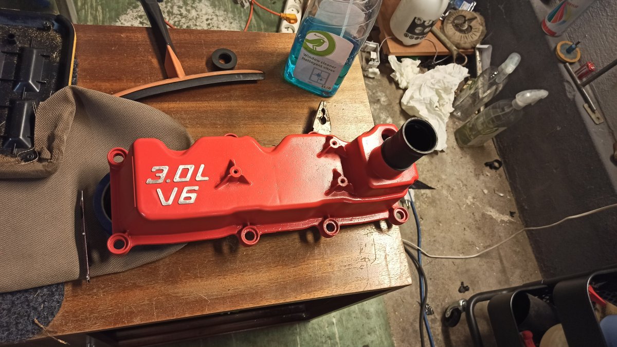

i like the valve covers too but my engine is doing fine so i am not cracking it open until it breaks down

Awesome progress. Nice work on the seat covers.

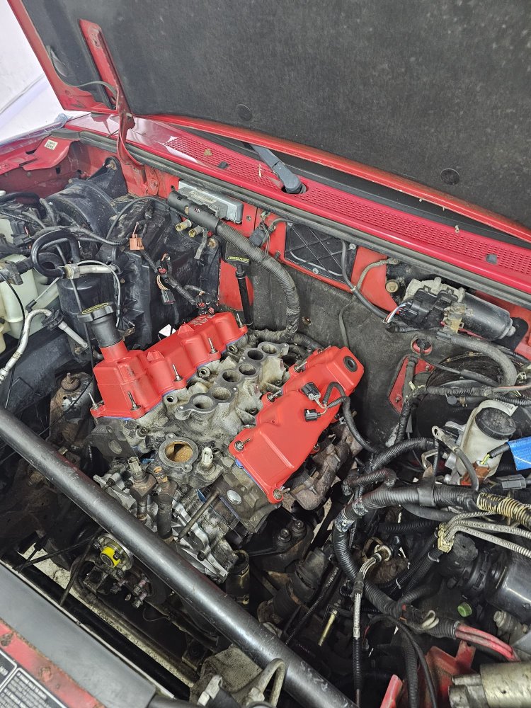

Hello again, after a couple of months finally Ranger is running. I had to do remachine heads again, cause of huge oil consumption. I realized , that the valve seals wasn't problem. The reason was huge gap between valves an steams. Thanks to my friends from another shop for fast replacing stems and valves . Now engine is working perfect. Now i'm waiting for some vacation to start withe frame and body work . Some videos from progress:
