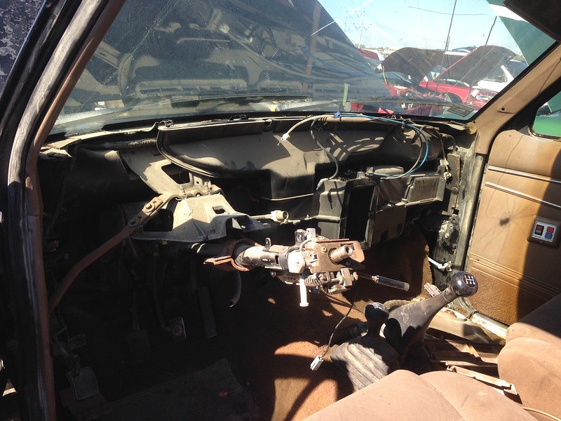

By all means, if you want to go ahead...
The control head is right below the radio obviously so you may end up there anyway.
You may end up here too if you are really lucky...
