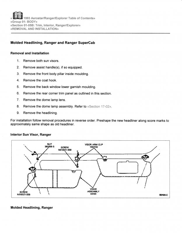

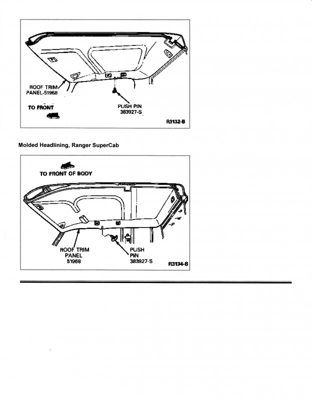

These are the instructions from the Ford manual for 93-94, it doesn't say much about doors or windows ( or seatbelts ) but I haven't done mine yet either. I looked online a while back and it seemed they are available for a little over 200 dollars
I also watched a utube video of it being done and the guy made it look easy
30347
30348
