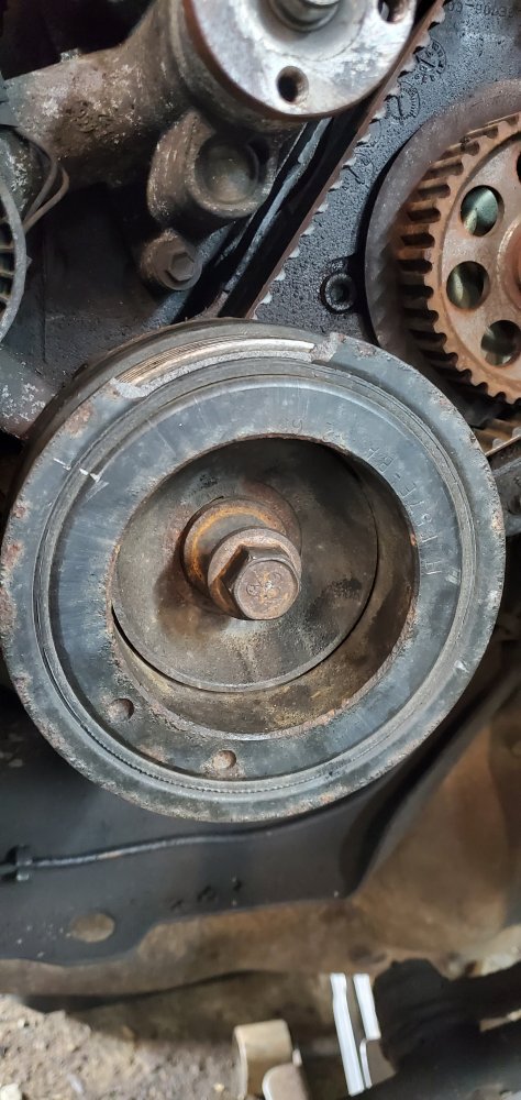

ok, seriously, how the **** are you supposed to get a puller on this thing?
Harmonic Balancer Removal
Tried a gear puller (on the back, it broke the balancer when it slipped off - no, im not replacing it, I hope it detonates this sh*theap of an engine), no success. No success with hammer, prybar, or hitting it from behind either.
Who the **** designs a harmonic balancer with no ****ing puller holes?!?!
Ford seems to think it falls off. Instructions literally just say "Remove bolt, remove damper hub".

Theres a slot big enough to stick a large screwdriver behind the tone ring to the left, stick it in there and pry while whacking it on the side with a brass hammer. Always works for me.
You gotta vibrate it while you pull it, that's the key. Don't just wack or tug you gotta whack while tugging. Pull it, whack it, pull it whack it soon it achieve full release... ok sorry I'm done.

Uh, the pulley bolt is out, right? I pulled one on a 90 2.3 years ago and the bolt was the hard part; I should have heated it. The rest was easy. The write-up on it is still here on the site.

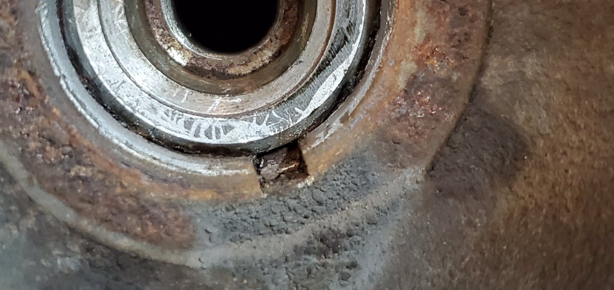

Well. Found the problem.
Going to guess that keyway is annihilated.
Better yet, the center bolt bent from the puller.

False alarm, just a ton of rust.
Still going to need a balancer and now a balancer bolt.

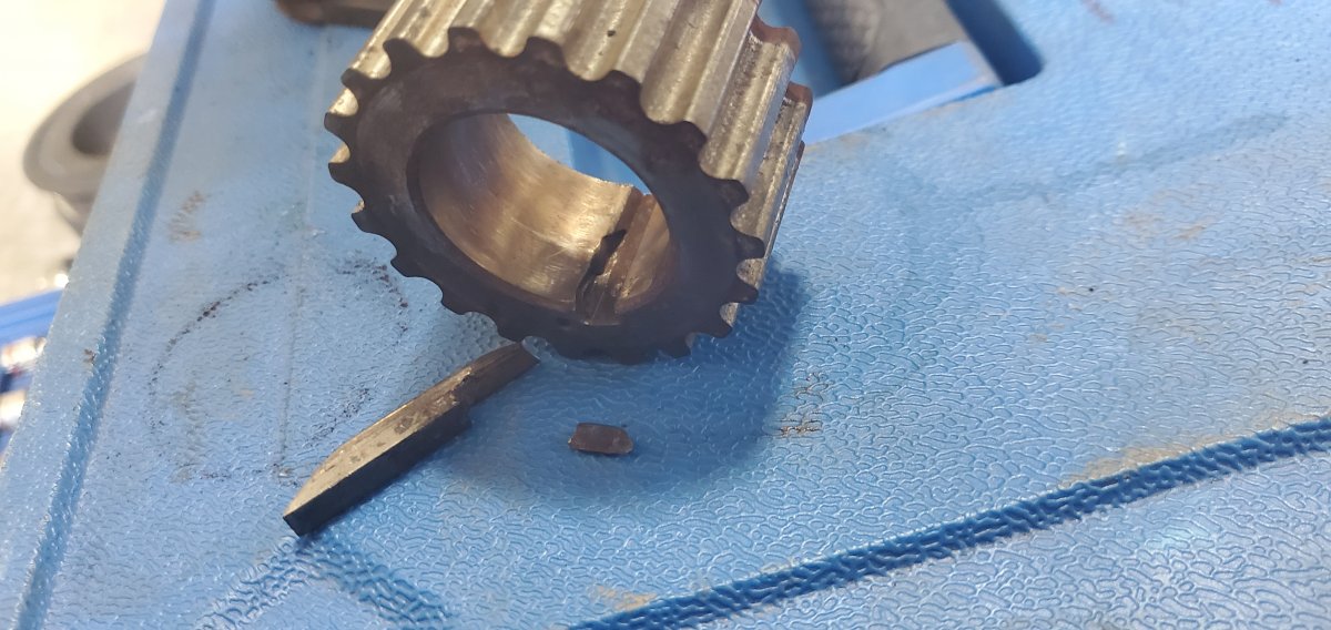

So, final update.... went to hang the new timing belt, and could not quite line up the timing marks.
Found this:
