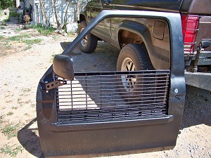

I actually just finished them, other than installation. My BII has all electric, and in order to swap in the new doors I need to do the trailer hitch quick disconnect mod to the door electrical harnesses. That is tomorrow, I think. I'll see about some pre- mounted pics, but it will ruin the finished project effect I was gonna spring on ya.

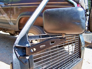

I did go ahead and fabricate some custom mirror mounts using some uni-strut pieces, and hand made brackets. I think I really like how that turned out. I used the original mirror heads, blackened, and I like the look.
Since My Beloved gets pretty nervouse about some of the dangerouse appearing things that I do.....I made some removeable wire mesh panels that lock in to the half doors to make them more like whole doors, for highway travel purposes.
Also, all the original door latch and lock functions are still functional, and when I get around to making removeable "window" panels, The doors should be securable, for intown locking issues.
I also plan to make snap on vinyl panels to make them rain proof, using some heavy mil welding screen that I have. This will be next week, likely. I still need boatsnaps for this.

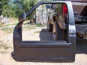

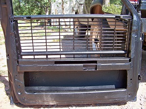

Ok, well here are some preliminary pics. Doors are not mounted yet, I had to go to a job interveiw instead. Guess I'll shoot for this weekend.

OK, you asked for it. This may not be logical to you guys, but makes perfect sense to me. I want to be able to keep the half doors on all summer long, but have a reasonable amount of security when I go into the city, (Oklahoma city isn't the most safe and secure place, and things walk away pretty easily) So I am making them lockable and relatively secure.
Also, my wife and daughter will not get in it with out the panels installed, (They think they'll fall out). Since I am inherently lazy, I want to be able to pull the panels out at will, instead of swapping doors all the time, since this is my daily driver as well.
I still have not made "window" inserts yet.
There. Are ya ok with that? ;)
This was probably more time consuming than most people would want to put in to it. I like it, though. I can also remove side panels to access the latching mechanisms, and bolts, ect. inside the frame.
