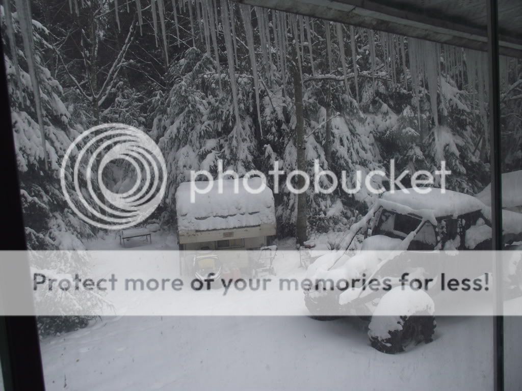

here's a pic.looks like a good day for paperwork.
yuk...where am i,friggin edmonton?

thought you had the basement all set up with the welder in there and such? and is that the ranger there without the bed?
ya,the small welder's there.i'm in aluminum welding mode right now,that gets done in the shed.

and yup...that's the poor ranger just waiting for me to get back to it.i have to look at it all the time out the living room window,so trust me,it's not forgotten.
