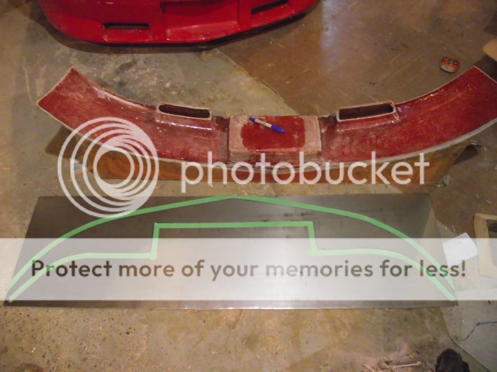

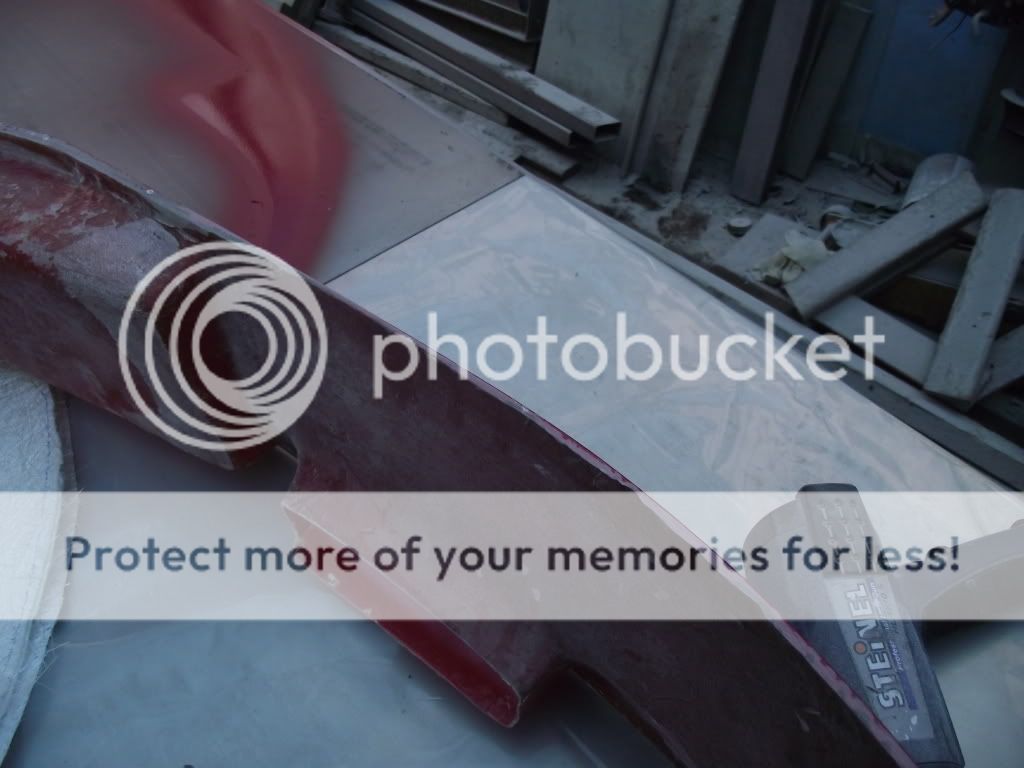

as promised,here's how the top plate was done.i started by tracing it from the plug onto a piece of sheetmetal.this will be my mold.after waxing and applying pva,i framed out the tracing with masking tape.this is just to make it so i can see where the edges are when i spray on the gelcoat.
Gt-12

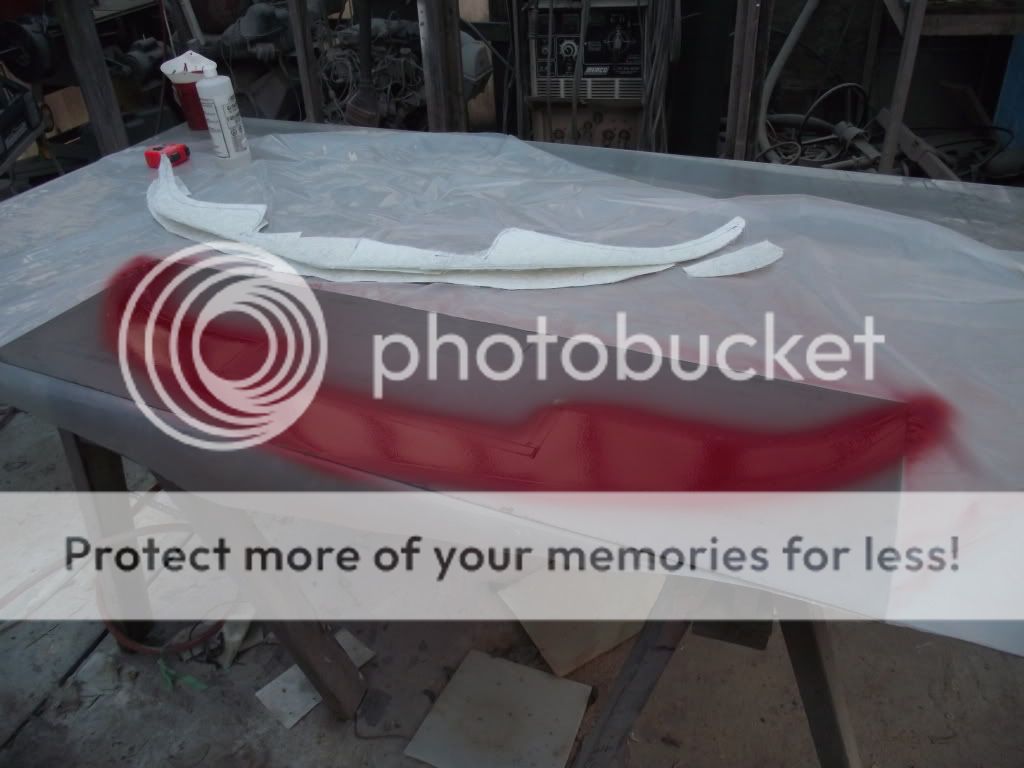

then,after it was sitting flat,i sprayed the gelcoat on.note the pre-cut matt.
Gt-12

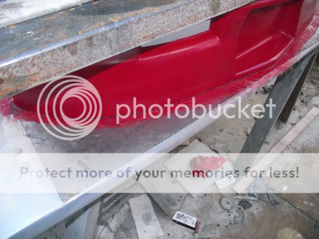

the top edge of the airdam was sanded,making sure it was flat and even across it's width,and to give some bite for the resin.
Gt-12

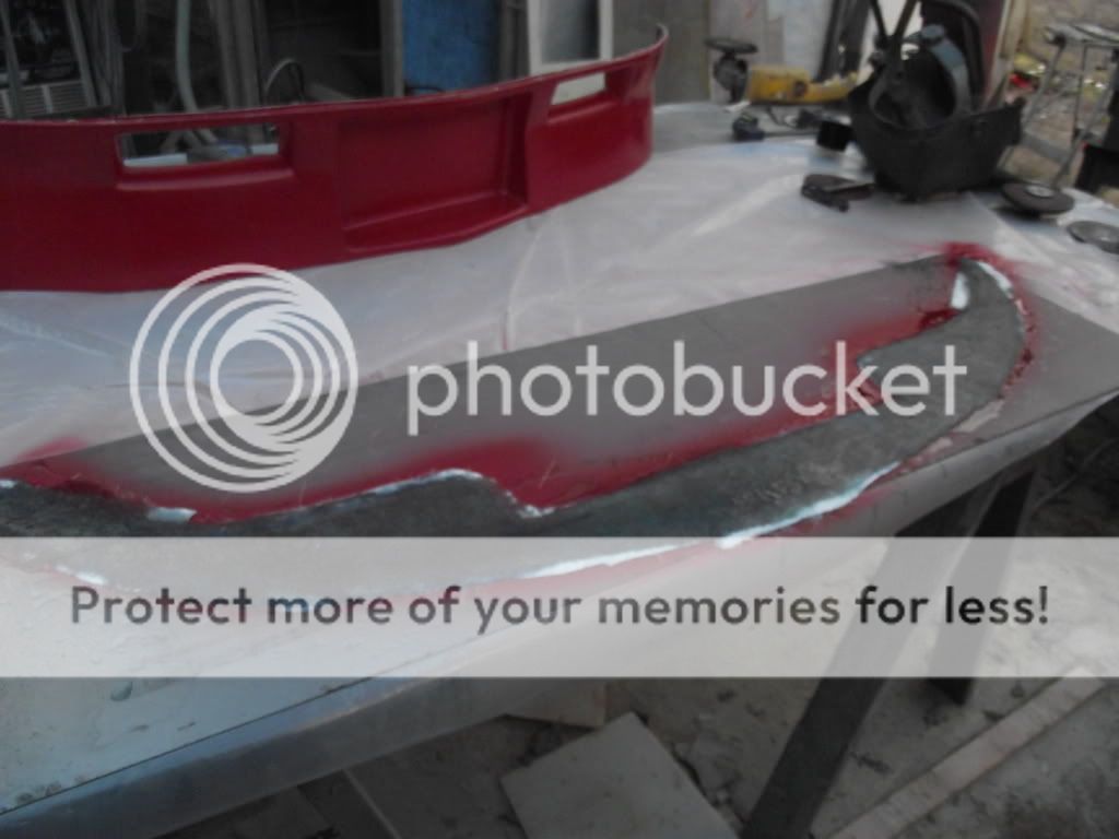

i layed down 3 layers of matt-one more than the face of the airdam as this is the part that will be mounted to the chassis.
Gt-12

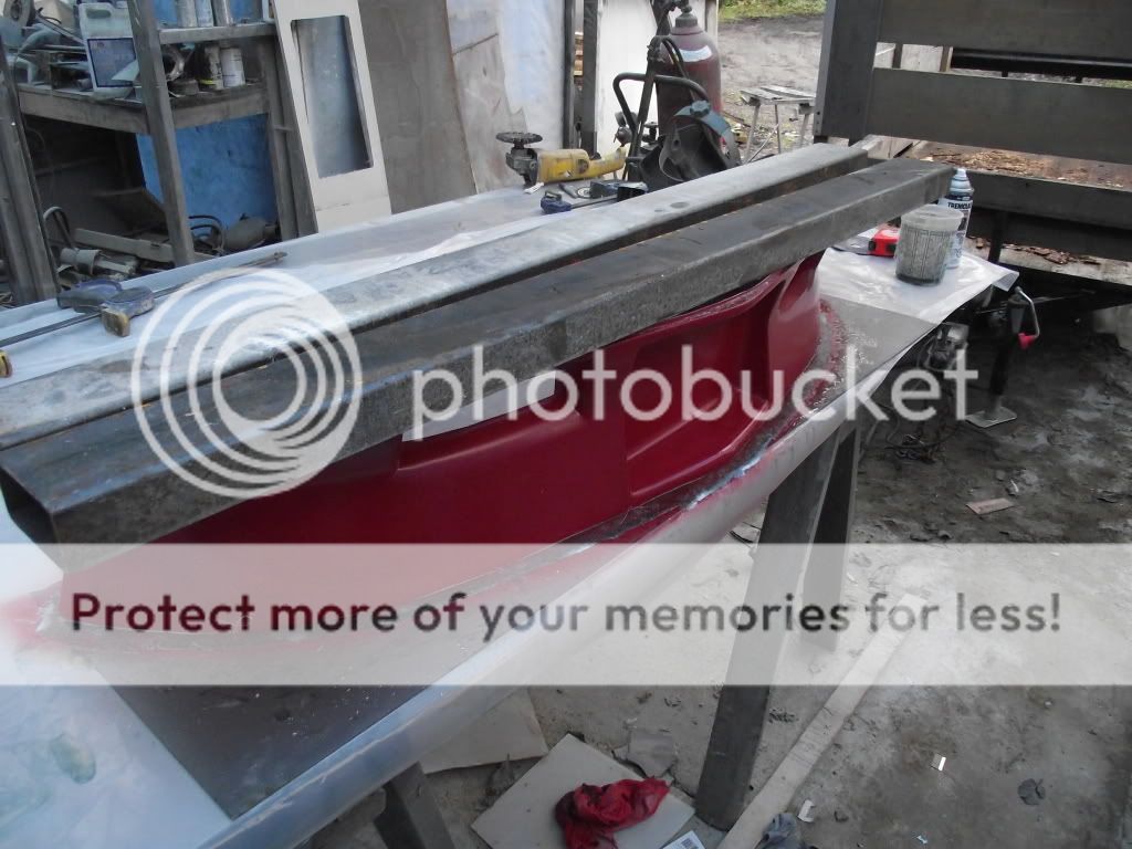

while it was still wet,i poured a little more resin on the front edge,then placed the airdam down on it,and weighted it down with some steel.
Gt-12

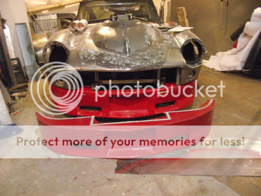

i then trimmed the excess material from the front edge with a razor blade and removed it.
now,it's just a matter of waiting for it to set completely so the steel mold can be removed.
Gt-12
and there....outside of trimming the back edge i'll call this done.that trimming will need to wait till tomorrow,as it's dark now.
