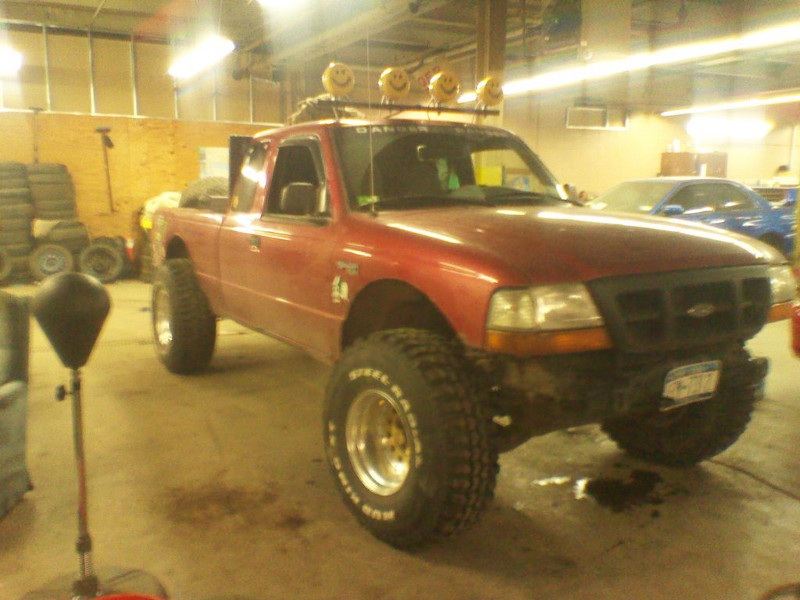

got my 35's on finally

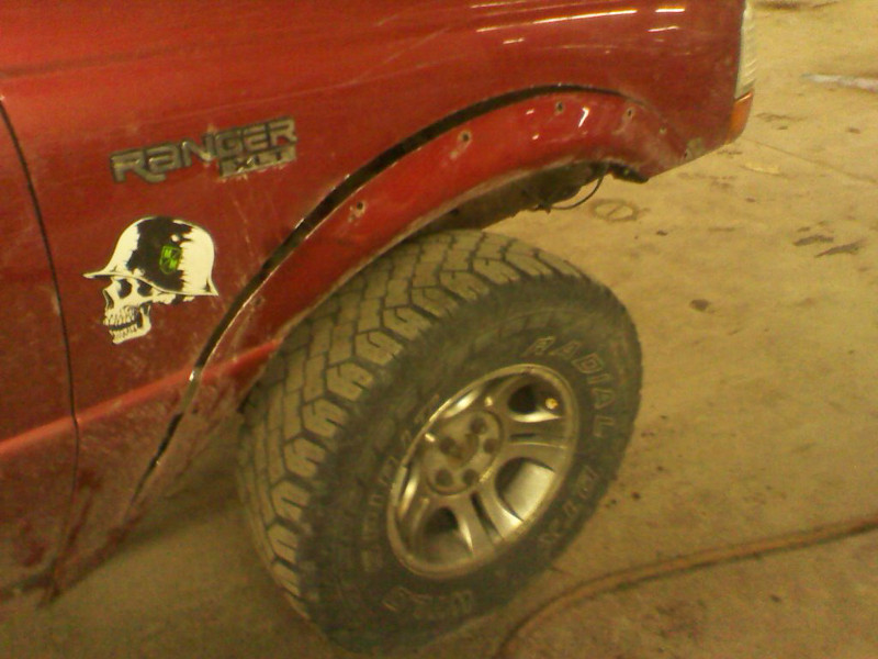

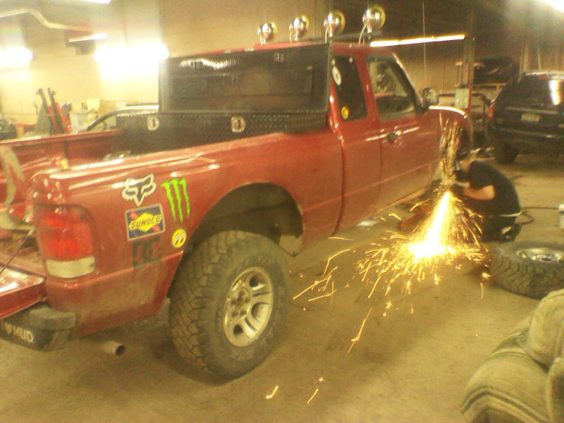

Use a cutoff wheel to cut your fenders, I've done jigsaw sazall and cutoff wheel, defiantly like the cutoff wheel best and also do little cuts in the fender an inch or so long to fold in for a lip.
im getting 35s on my lifted 2wd, and just cut a set of front fenders for the extra clearence. a rolled edge would look really clean. so every inch make a little cut or make the cuts an inch long? have any pics of this?
heres how mine turned out with a cutoff wheel
op- truck looks good but def not smart to run that on all stock stuff.. just my .02

actually ive only noticed a slight difference when on the highway, but other than that its not that bad, i think ppl just over react esp. when it comes to ride quality lol if i wanted a caddy i wouldve bought one, but before the 35's i had 31's so that might be why i only feel a small difference

I cut and folded in about every inche and folded it all the way up against the backside of the sheet metal, will try to upload some pictures in my build thread here tonight. Helps give the fender some strength and to keep from destroying your tires on the edge of the fenders.

I first taped em off in the radius I wanted, then cut with plasma (just try not to catch your fender on fire).

well here we go, fenders all cut, i cut em just above where the factory flares used to be..., and only thing modded as far as suspension was full torsion twist, and yes i can turn full lock no prob with these 35's, im pretty happy with how it turned out, heres some pics...
