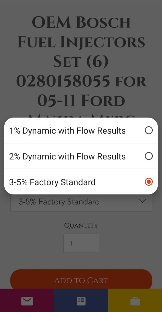

So, CS Performance got back to me today on a set of reman-s.
How uh... how precise does the flow matching need to be?

I dont plan on going much above the 3-3.5psi baseline. But only options I'm seeing are the stock 20lb or the Ford performance 47lb. So, it looks like I'm "stuck" with the stockers.
