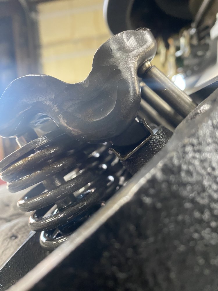

hold the phone folks, in that pic the rocker looks dangerously close to the bracket underneath it.
hopefully thats just camera angle.

Yeah, it would take some effort to get the rocker to touch that bracket.
it was camera angle. I edited my post.
