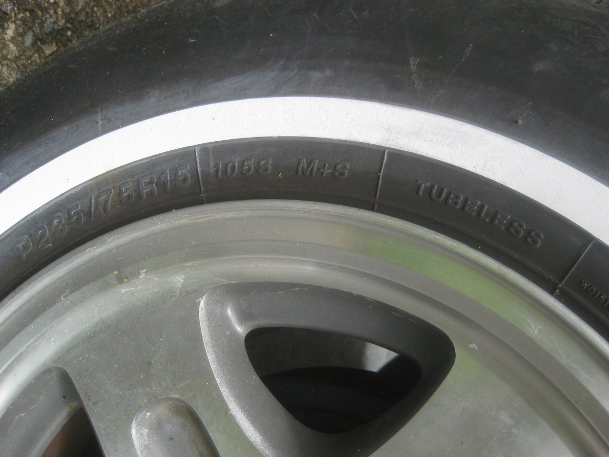

I think the speed rating is the S in 105S.

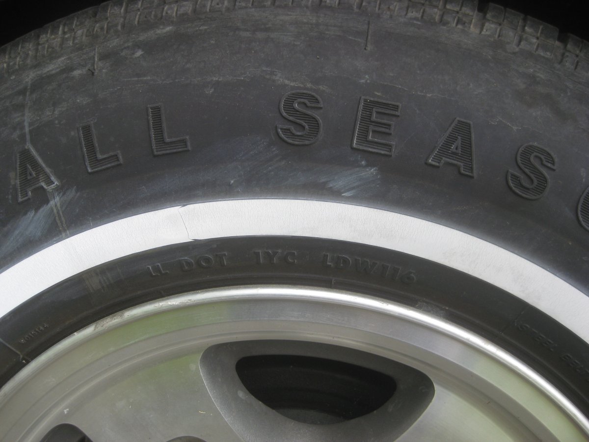

Here's pics of relevant parts, excuse dirtiness please.
cool. yeah I think you have to look at the combo of the offset and backspacing.

The date stamp is usually in an oval shaped stamping on the side wall. Often only on one side of the tire.

yes I see oval with date code on my XLT tires. I see no such thing on the Mazda tires but I'll check the inside face of them when it's not raining. thanks.
