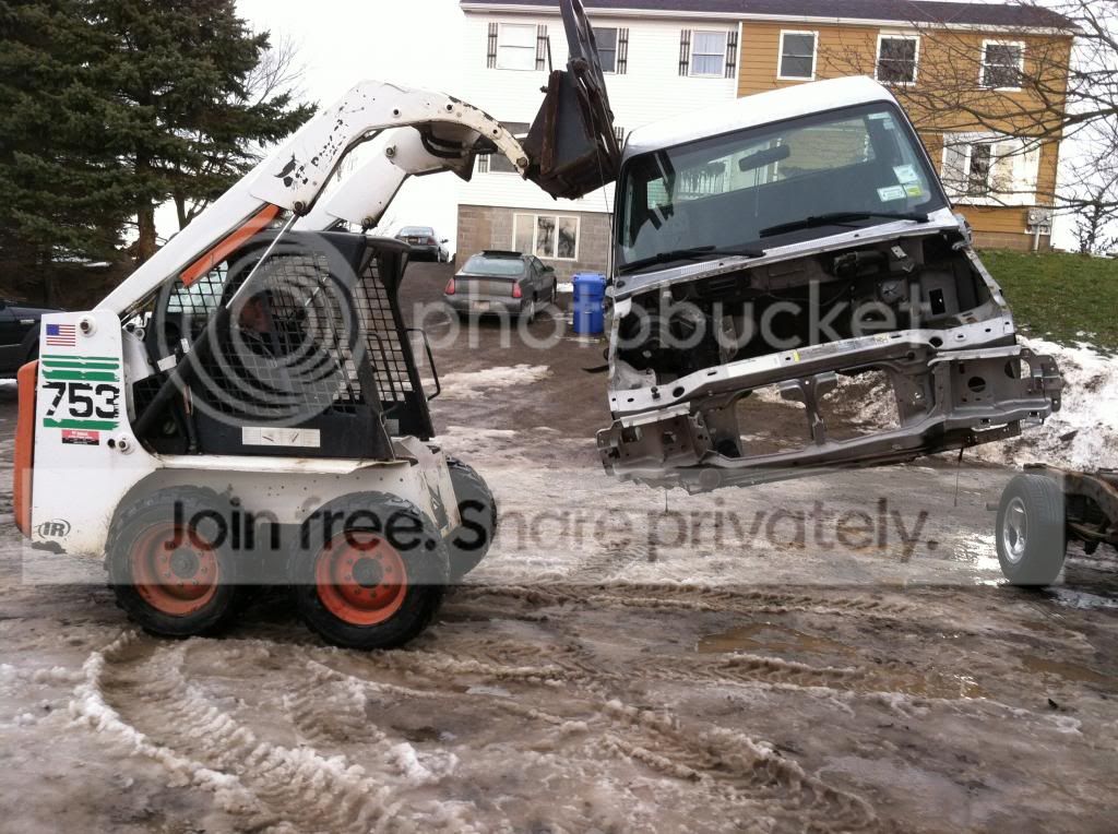

Couple new updates... Brought this home from storage...
Gen I Project
Gen I Project
Gen I Project
Gen I Project

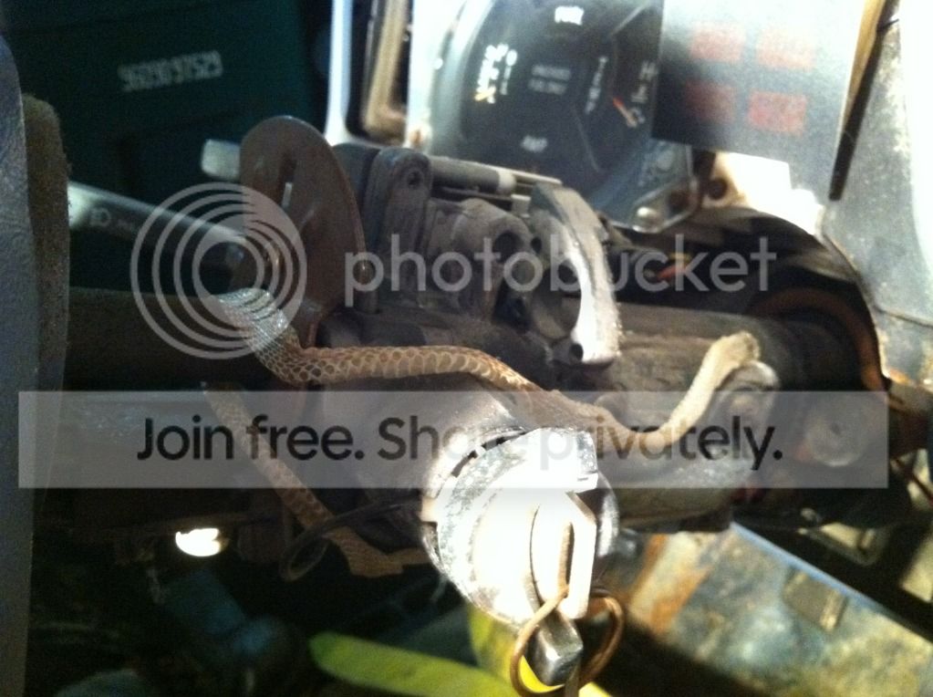

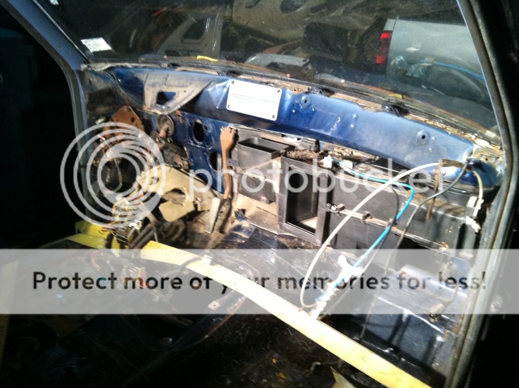

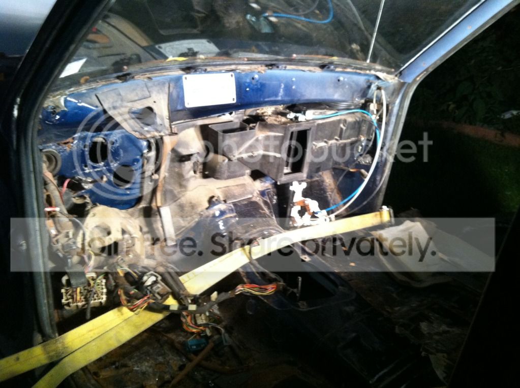

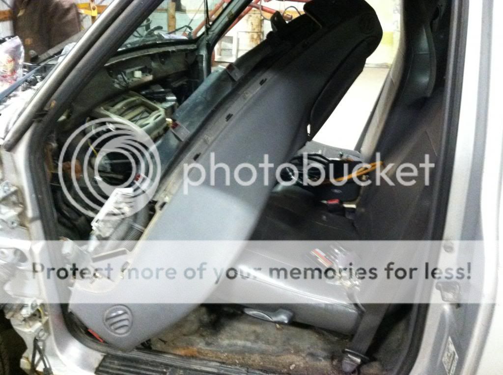

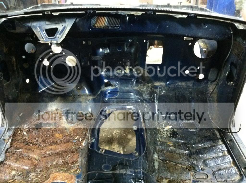

And got the dash ripped out of the 88...
Gen I Project
Gen I Project
And found the partner in crime... eek, I guess barns in PA are a favorite hang out for these little guys...
Gen I Project

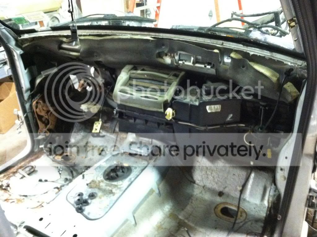

This picture may have sparked an idea that I might be able to move the blower motor from the outside to inside the cab hmmmmmmm if they can do it in a damn Tempo with A/C, there's gotta be a way to set it up on a Ranger with no A/C lol
That pic also reminded me of my impending doom - Fixing the rusted cowl!

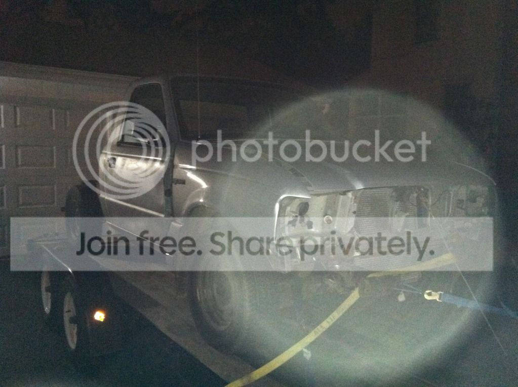

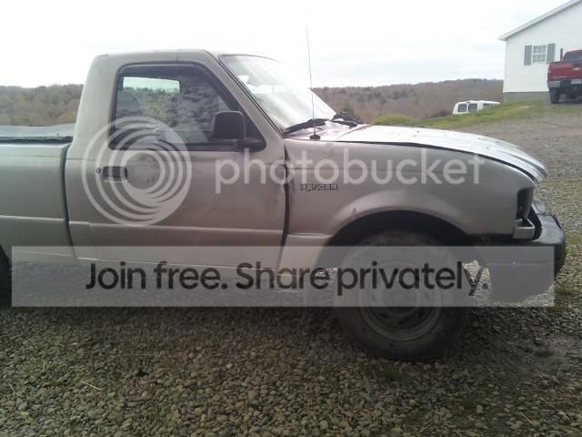

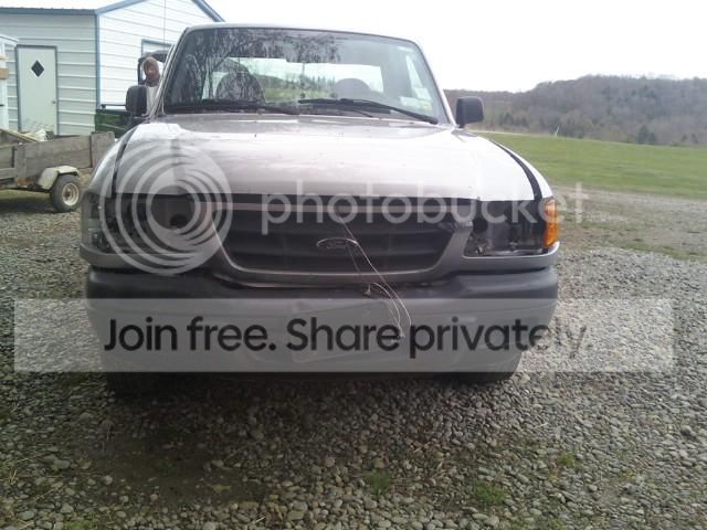

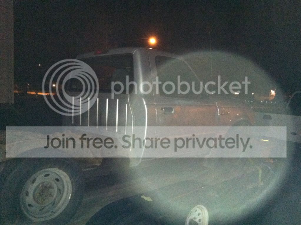

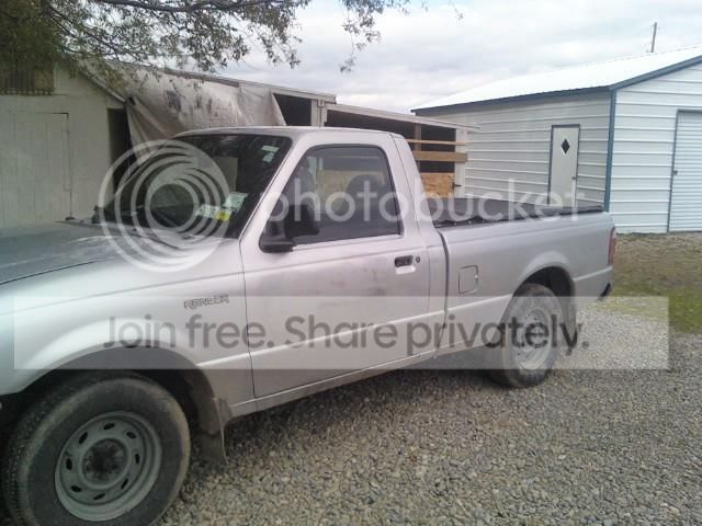

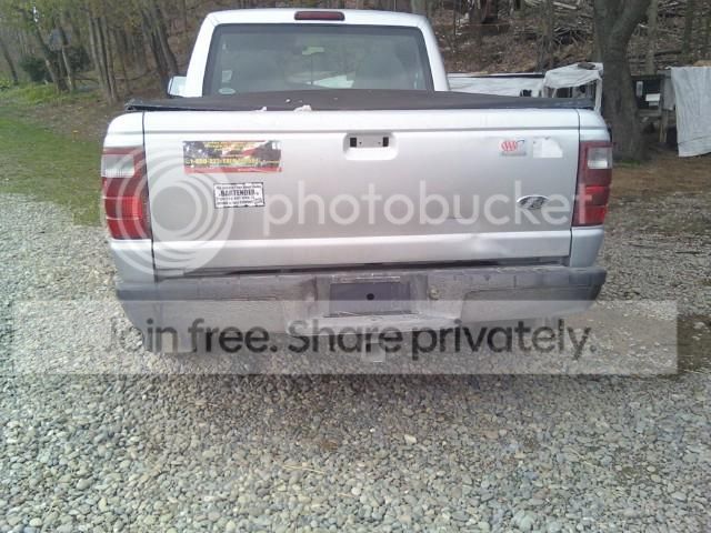

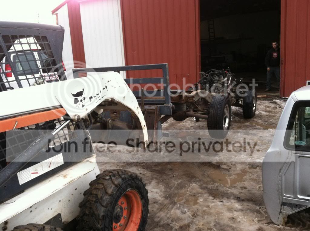

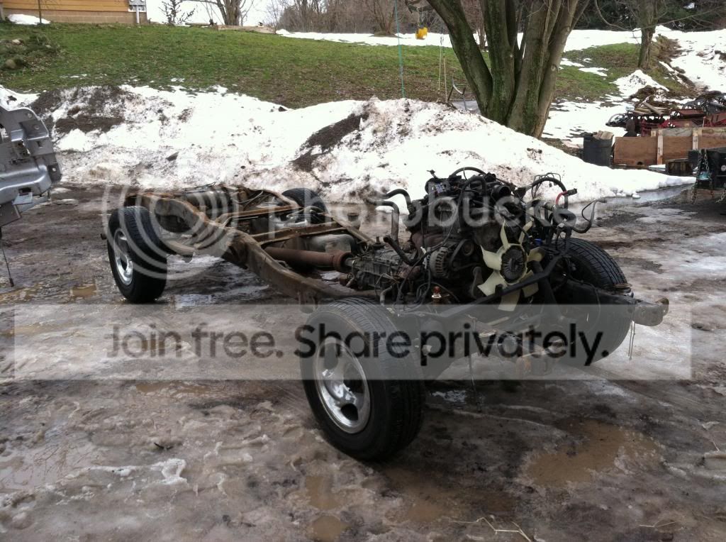

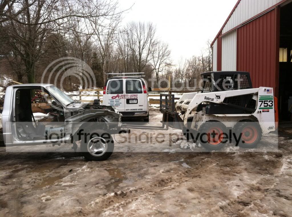

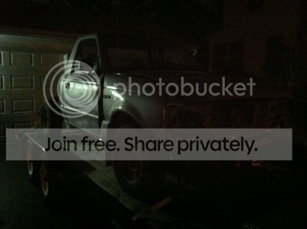

Progress on this stopped for a while, started wrenching on it again this week. The plan is to mount the 88 body to the 02 chassis and use the duratec motor. Here's the 02 I started with...
Gen I Project
Gen I Project
Gen I Project
Gen I Project
Gen I Project

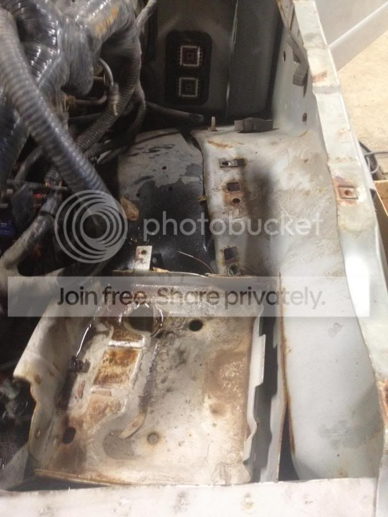

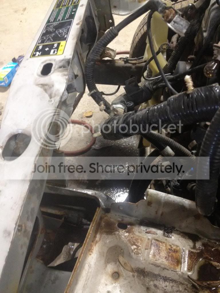

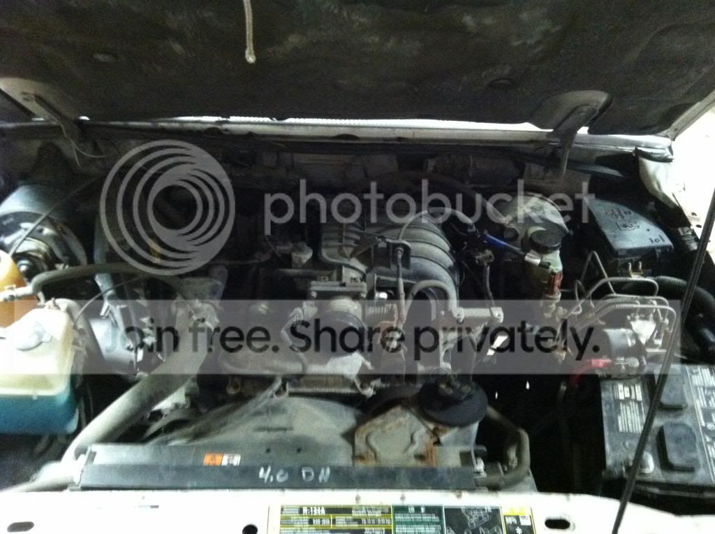

Engine bay before we ripped into it...
Gen I Project

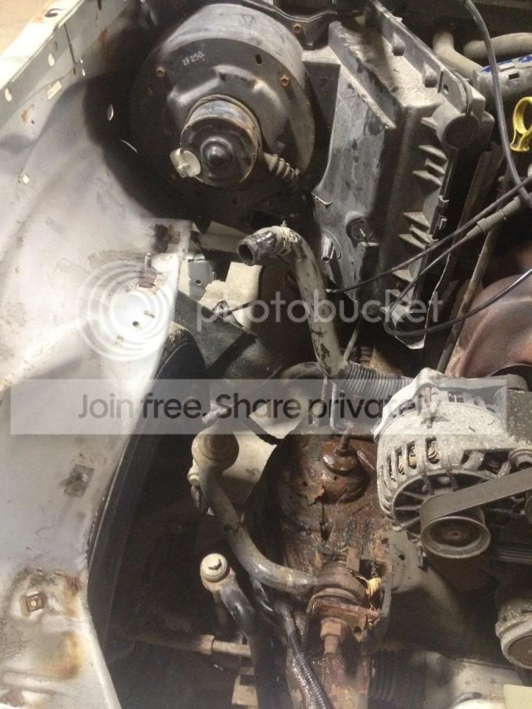

Stripping it down...

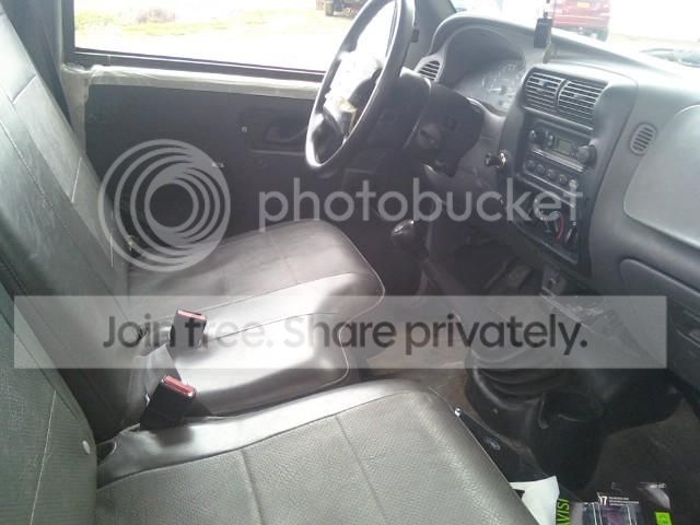

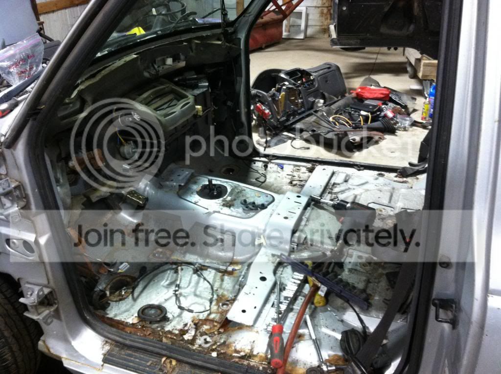

And interior torn apart...
Gen I Project
Gen I Project
Gen I Project

I've had a couple of the newer rangers in the configuration of the 02, with the duratec 4 cylinder, 5 speed transmission. I like the way they ride and the easy alterations to the A-arm suspension over the i-beams. I also love the duratec motor that can take a serious beating and still get 28 MPG all day long while being reliable. My concept with this truck is to restore the underside to like new, update the interior to modern dash, seats, etc. so interior and underside will be like new. The body I plan to leave as you see it here, not doing paint at this point. When I do paint I always end up being too anal about parking or even driving them. I'm building this to be a daily driver all summer long and enjoy it.

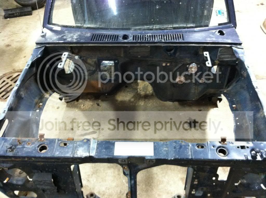

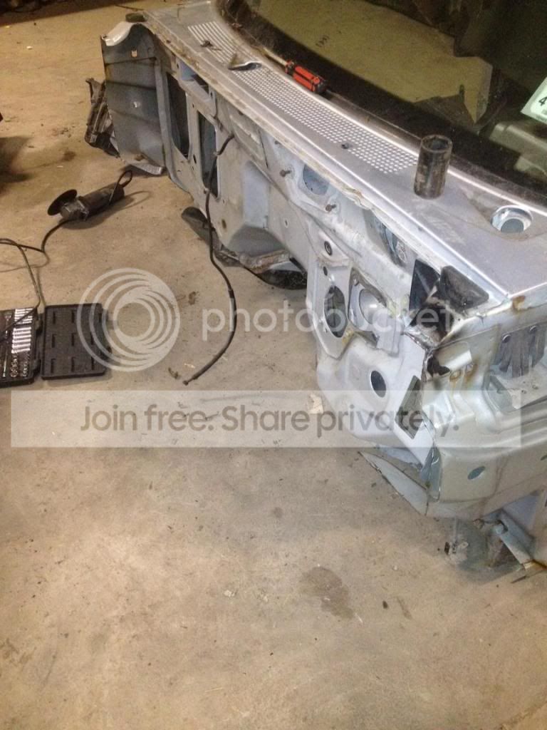

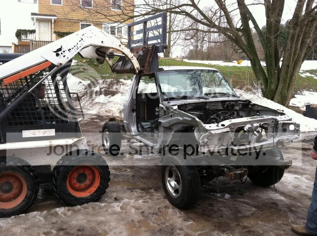

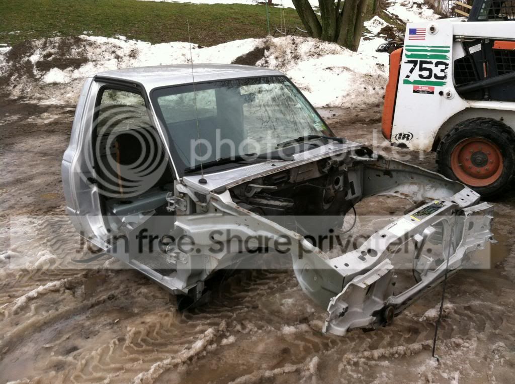

Got a couple more hours in on disassembly of both cabs, amazing how similar the firewalls and cowls are.
Bare firewall of 02...

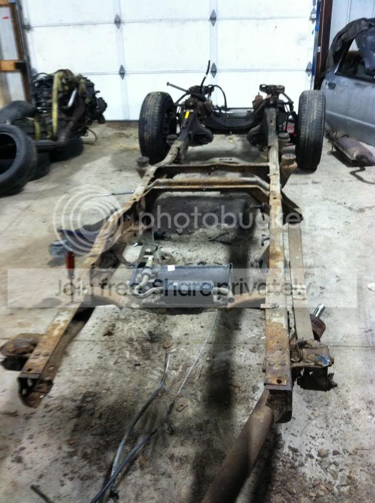

Removed motor, tranny, and rear end from chassis to clean everything up, make frame alterations, and paint before reassembling...
Gen I Project
Bare firewall of 88...
