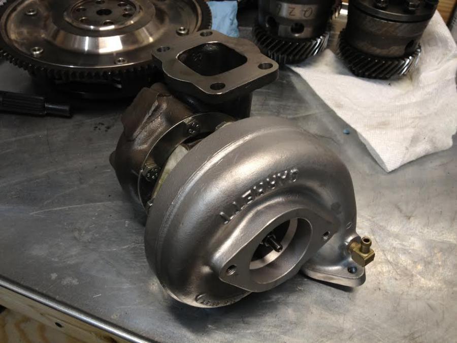

A few guys have used the above turbo, #2 in that post with good results thats why i was looking for that particular model. This is for an old british car. Really need this model. 60/48!
I rounded up a 60/48
Freshly rebuilt. Project stalled. So if anyone needs one........
