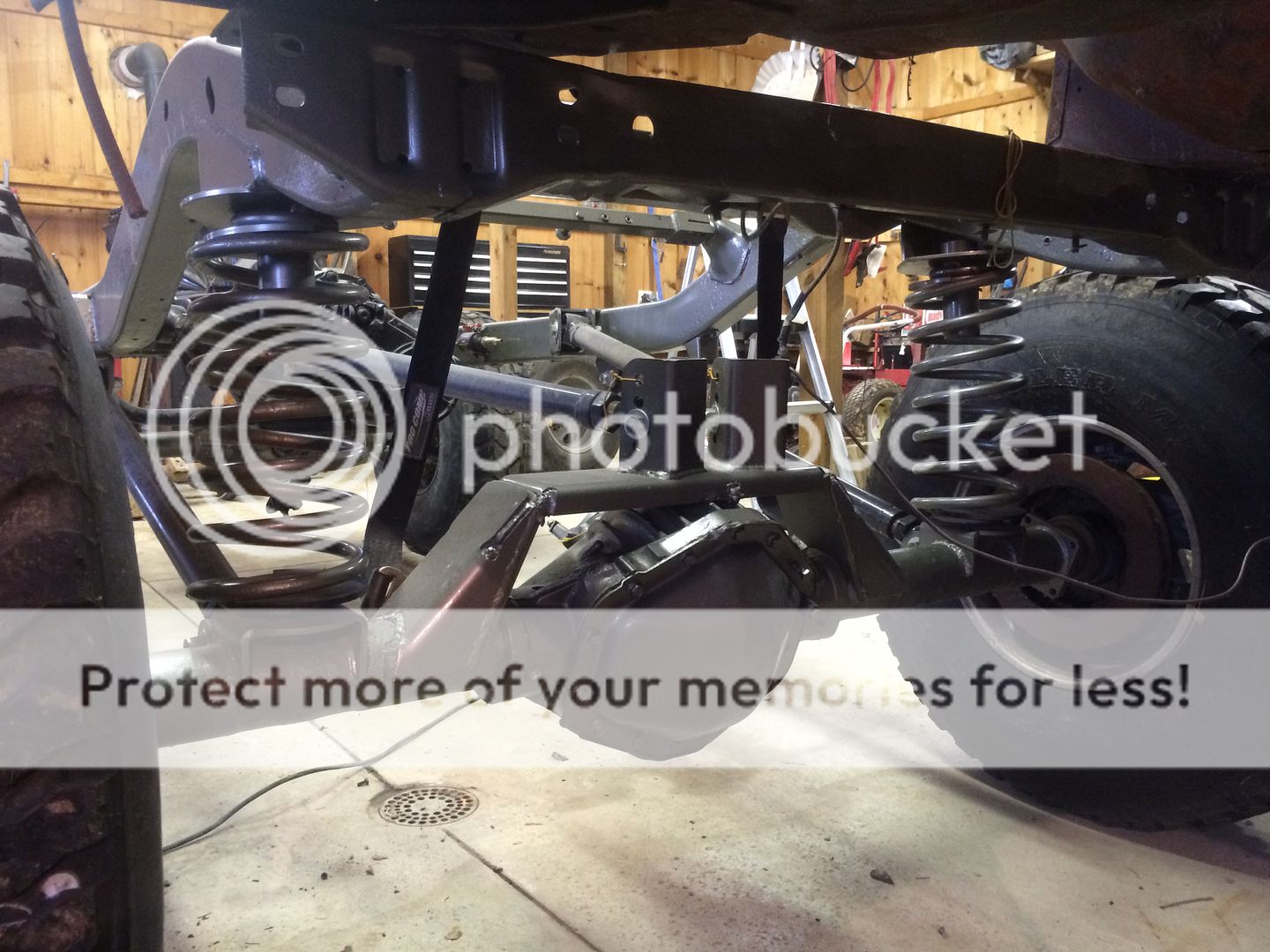

Looks like a decent start for a project. I'm not sure about the terra flex shackles up front though. I would think that would cause the axle to want to drop down every time you want to climb up an obstacle.
I agree. The front axle will be pushed forward about 4" and linked :D

Onebadex, how do you feel about low pinion front axles? This yoke isnt as low as expected, but I am worried about it...

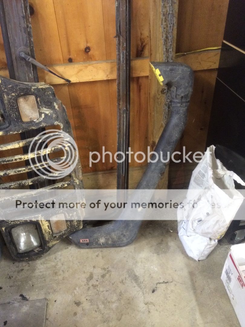

Found an ARB snorkel buried in the tub lol

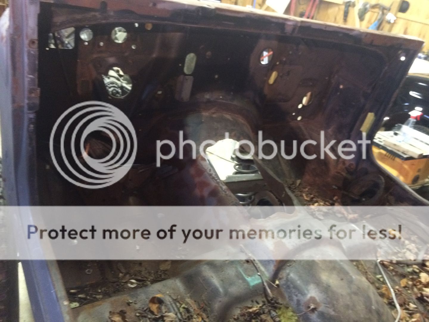

Pulled the cage out. I wont be using it. Pulled the tub off too.

Solid tub

Low pinions aren't too bad. If you are going to link it you can rotate it up some to gain some angle back. The only real other problem is when they drop they really like to bind up the front yoke/shaft. If you go with a 1410 it gives you double the operating angle as a stock size plus its a lot stronger. You can find a 1410 d60 yoke cheap like under $40. If you do links I'd run the link bars at the same angle as the front shaft so that the bar will kinda act like a skid and protect it from all the rocks that a low pinion has a tendency to plow into on the trails. If you really wanted to get crazy buy a high pinion center chunk and pull out your tubes and make a high pinion pass side axle.
After looking at it better, it think the LP will work since I do plan on linking it.
