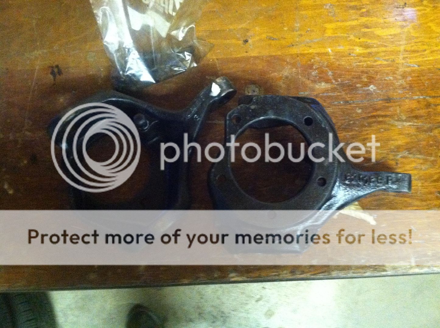

I have new to me knuckles on the way from Brinker. :D

Edit: So where's the pic of these knuckles at?
haha. Pick the new to me knuckles. Bought them from Brinker88. They came in above my expectations.

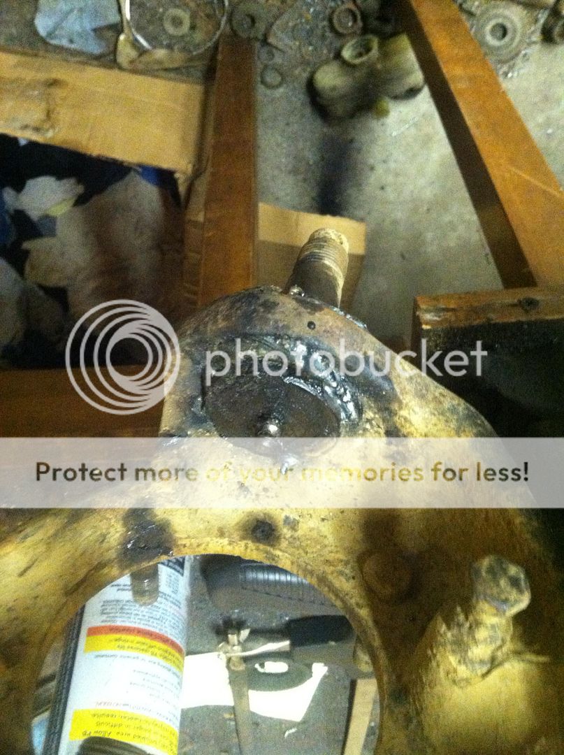

I also got the new drivers side axle shaft together. Then I grabed my passenger one to put the new axle seals on. I am putting new bearings and seals on from the diff out. Well, my passenger side outer stub is shot. The joint bores are oversized. I will be buying one of Plums spares.
Here is a video with new caps. Yes, I know the joint is not the right size lol
http://s123.photobucket.com/user/muddinford95/media/Rangers/SAS Part2/IMG_3871_zpsa26ca595.mp4.html
Then I rigged my bent knuckle for the June trip. After this trip, I will put the new ones. I need to take them to work to get the tapperd holes drilled out for my steering hiems.
