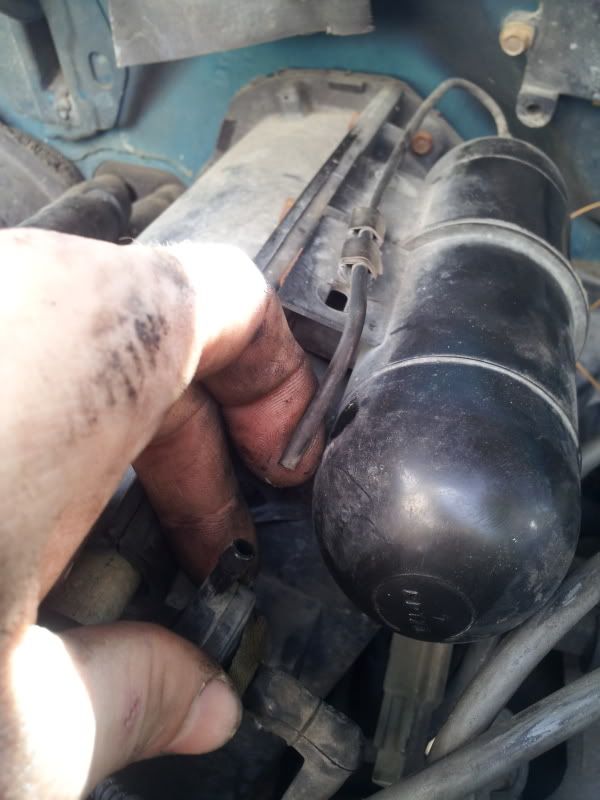

Two new developments:
1. This "vaccuum" line was broken. It seems to lead straight to the fuel rail, where a line to the fuel pressure regulator comes from! Not sure if this is unrelated.Probably have a few existing issues here but its nice to know i knocked one out today.

Low voltage Grounds and wire connections in general don't work around corrosion very well, good find.
The fuel pressure regulator(FPR) works on a vacuum, at idle vacuum is highest so FPR diaphragm is held open and fuel is sent back to the fuel tank via the return line, as RPMs increases vacuum decreases so diaphragm closes to match vacuum.
When there is no vacuum, engine off, FPR is closed to keep some pressure in the system.
Fuel pump in the tank has a check valve that prevents back flow.
If working properly the FPR should maintain 30-40psi of pressure.
The diaphragm in the FPR can get a leak as it gets older, smell that vacuum line for gas smell, if you smell gas then replace FPR.
With fuel pump running and no vacuum at FPR, pressure would have been quite high.
Another good find :)
