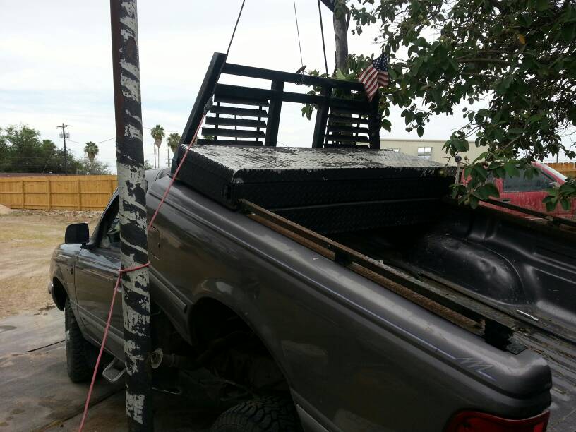

Rather than take the bed completely off, I've been advised by a friend that you can prop the front-end of the bed (the end by the cab) with a good, sturdy piece of wood. (Think of how a car's engine hood is propped up and you'll be on the right track.) Just make certain you don't mess up your tail lights or any of the wiring back there in the process. I haven't tried this yet, so I don't know how it stresses things back there, but I doubt there's any issues.

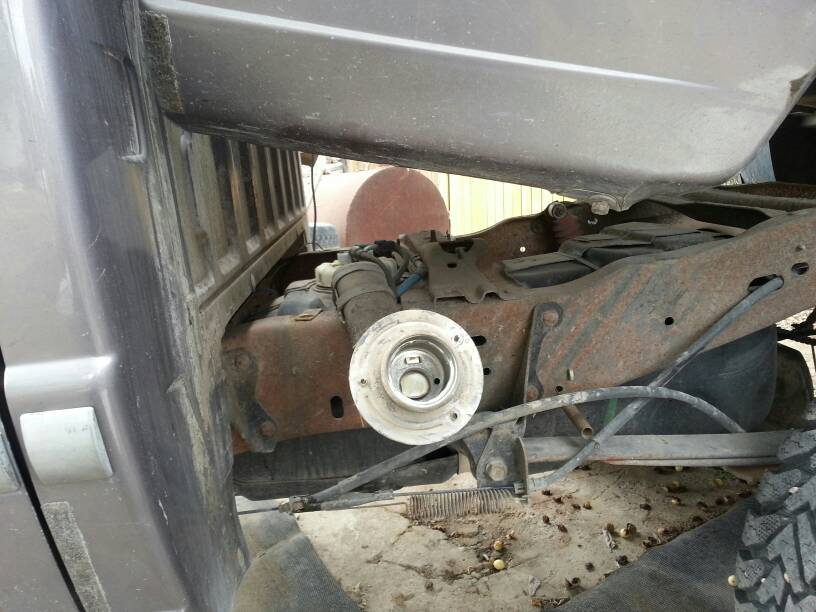

Anyhow, now you can get at the filler hose. Use a 1/4"-drive socket wrench to take off the hose clamps - I forget what size the socket is, but it's most likely metric.
The new hose is not an exact fit!!! First measure and cut the short end (the one that attaches to the fuel tank) so there's about a 1/8th inch clearance between the bottom of the hose and the frame rail - you don't want it to be in contact or else vibrations will wear a hole in your new hose!!!

With the hoses attached to the fuel tank, clamped down, and oriented in the correct direction, carefully lower the bed back down on the frame rails, make sure the hoses are properly routed through the gap between the bed and the frame rail, and then bolt the bed back down.
NOW, trim the intake-end of the filler hose and vent hoses! This is much easier to do with everything else back in place - this way there is absolutely no guess work.

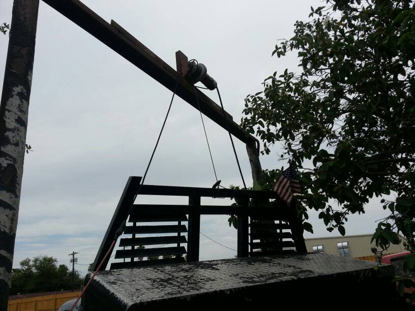

Funny you mention what your friend said. I did something sorta similar but I used a winch we keep for skinning deer.
