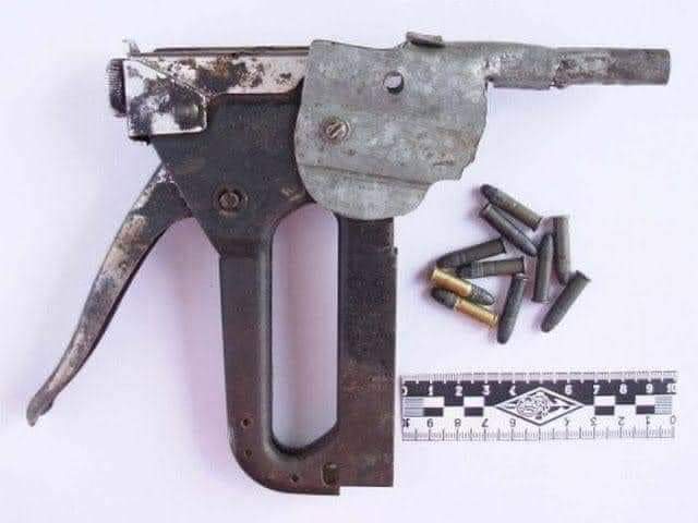

Would this help?
Why do you have my T30!?
