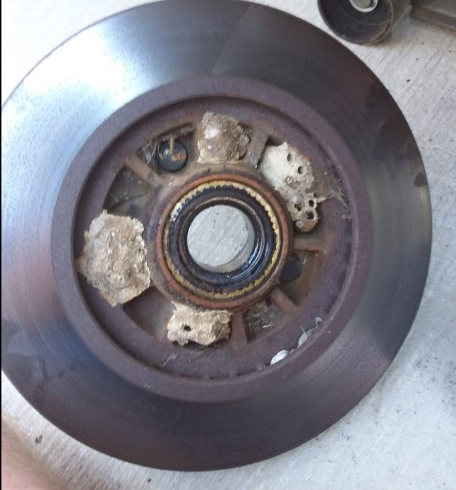

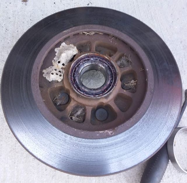

I found some surprises along the way....
I'm sure that didn't help with the vibration I was feeling.
I still have a vibration, but I believe it is the U joints.
I jacked up each wheel on each side after putting the new Timkens in and tossing the china junk and they felt smooth.
I tried to shake the tire and wheel, no movement at all. The ball joints even felt solid.
Next step is to replace all the U joints.
Got them done over the weekend. Thanks for all the tips, went very smoothly.
Surely, you cleaned off all the mud dauber creations. Even though they are close to the center, they still throw things out of balance a certain amount. Off balance = vibration
Of course I cleaned it off!
Every time I work on this thing, I find a new nest! They had infested this thing! I even found some inside the wheels between the drum shoes!
damn dirty daubers....
