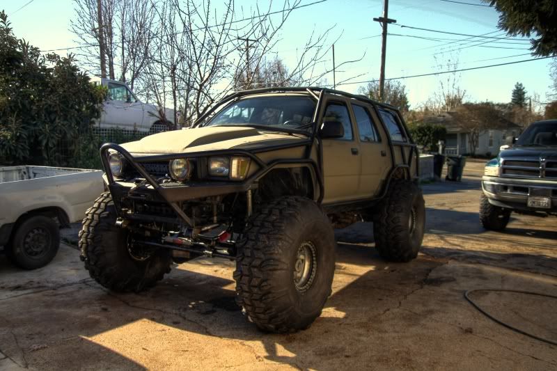

Front tube winch mount bumper

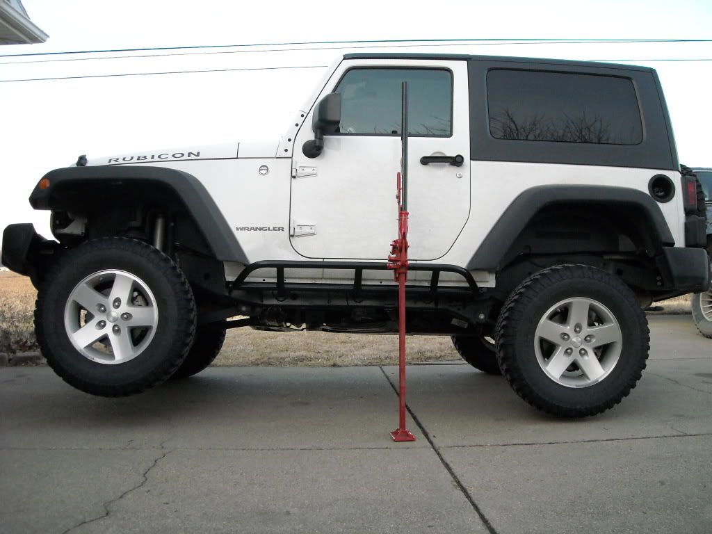

Here is some other stuff I built.

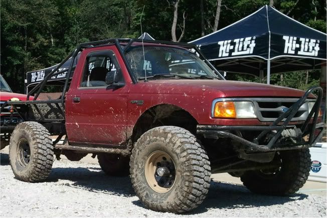

This one saved my butt . I called it the triple stinger.

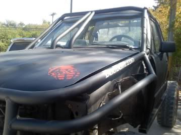

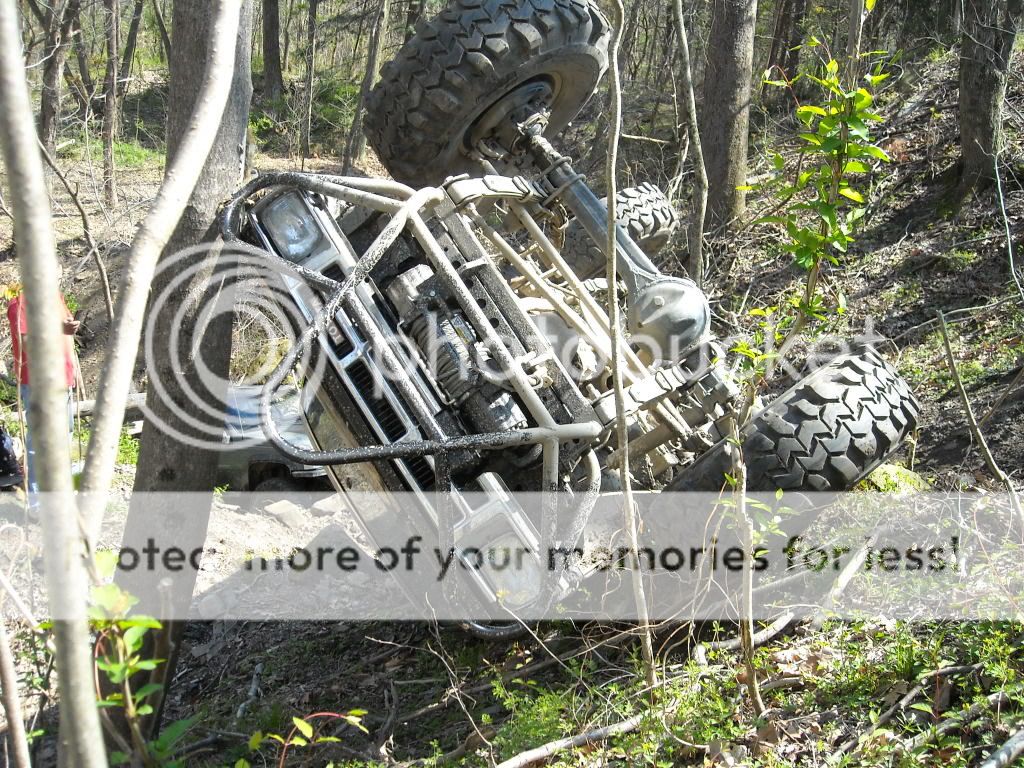

It lasted over a year but the passenger side got hit hard again today. Will be starting on a new bumper and maybe tube fenders this spring.
Sheet metal and trees just don't like each other. I could leave the stinger then rap the bumper all the way around to the exo.

Hey Greg, don't know if you said but what size tube did you use? Going to use your idea for my bumper if you don't mind.

No I don't care. But you should make it stronger some how.
It is 1.5" OD .120" wall HREW tubing.
