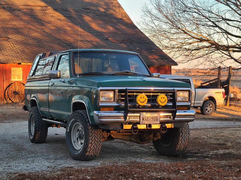

Best thing would probably be to build one. On my 93, I incorporated it into my front bumper.

I have a 3" bodylift, made a bracket to move my bumper back up to where it is supposed to be relative to the body and then incorporated a receiver mount into that for a winch.

Then I made a grille guard to fit around it

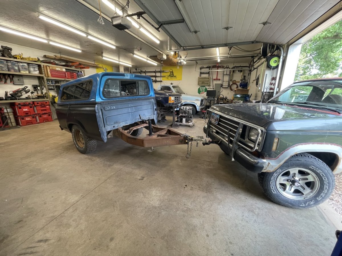

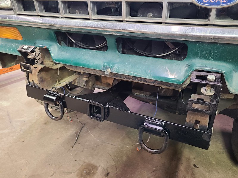

I have something similar to @85_Ranger4x4's setup on my '88, the horizontal tube sits between the frame rails and bolts onto the bottom of them though. I cut a hole in the bumper for the receiver tube to slide through. Mainly I wanted to maintain my approach angle. One downside is that it required a license plate relocation.
You can kinda see it in these pictures... very handy for activities.

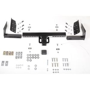

autozone someplaces carries a uni kit too.....37024 ?
nope ....this one

I've heard a couple cases of the 37042 being used as a front hitch. It is actually in my plans at some point, assuming I don't buy a rear bumper kit for a Jeep and with built-in receiver and make that work on the front.
