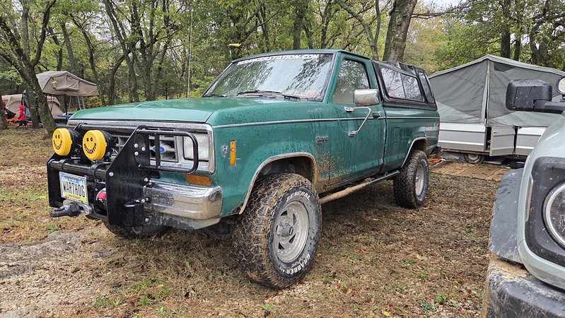

If you have a welder... and are handy... you could make a mount.
It isn't hard to do, I made one for mine:
