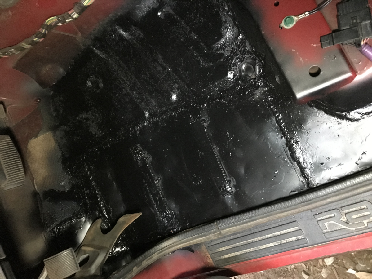

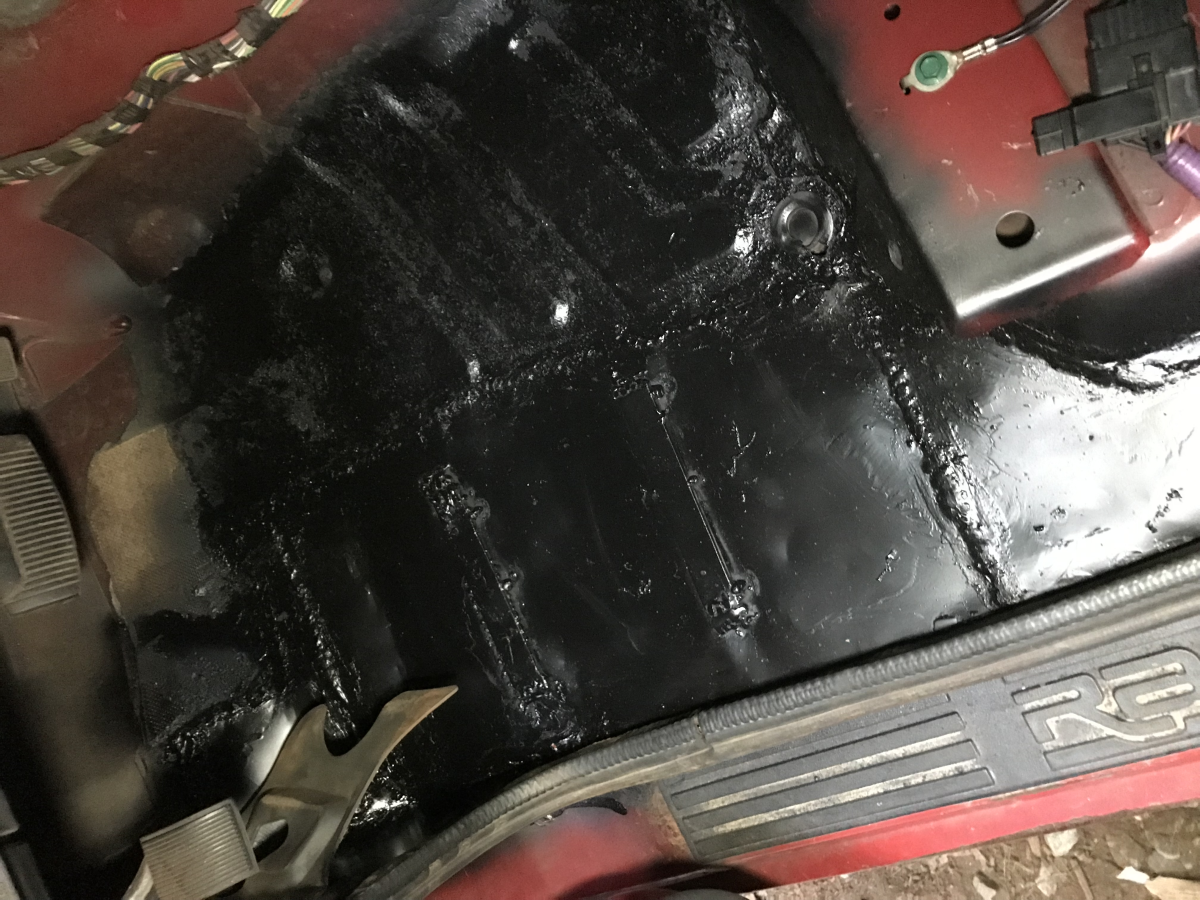

First I bought it last year early summer late spring. It had a hole in the floor and a bed that was about ready to fall off of its floor and become airborne or something. Also a rotten cab corner So I pulled the old bed and used that as practice for welding, replacing the floor in the drivers side of the cab.
It ain't pretty...

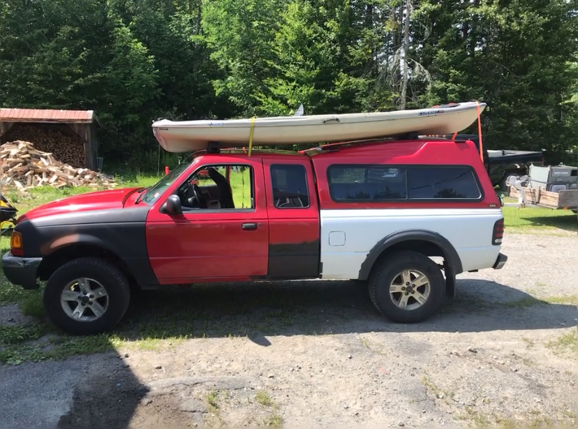

I then proceeded to find the best bed I could in New Hampshire, thank you salt, everything that you even think of driving outside in the winter gets rusty. but that was white, so since the truck was at that point red with a white bed and black cab corner, oh yeah and black fenders, those had to get swapped out too. dude who owned it before me put ZERO effort into keeping things in good shape. Thankfully he only had it two years. So it looked like this till the end of July...

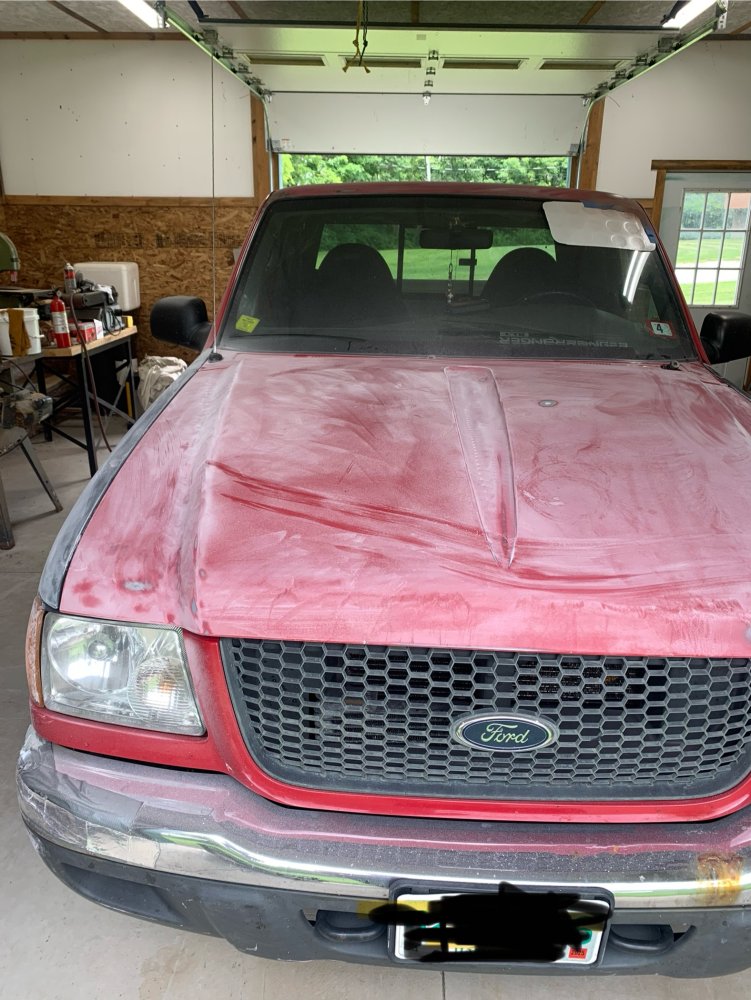

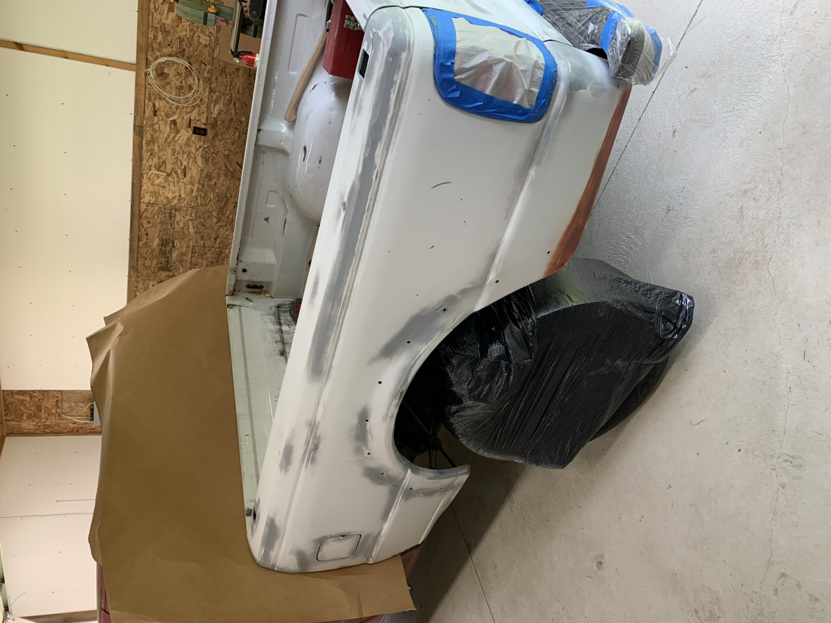

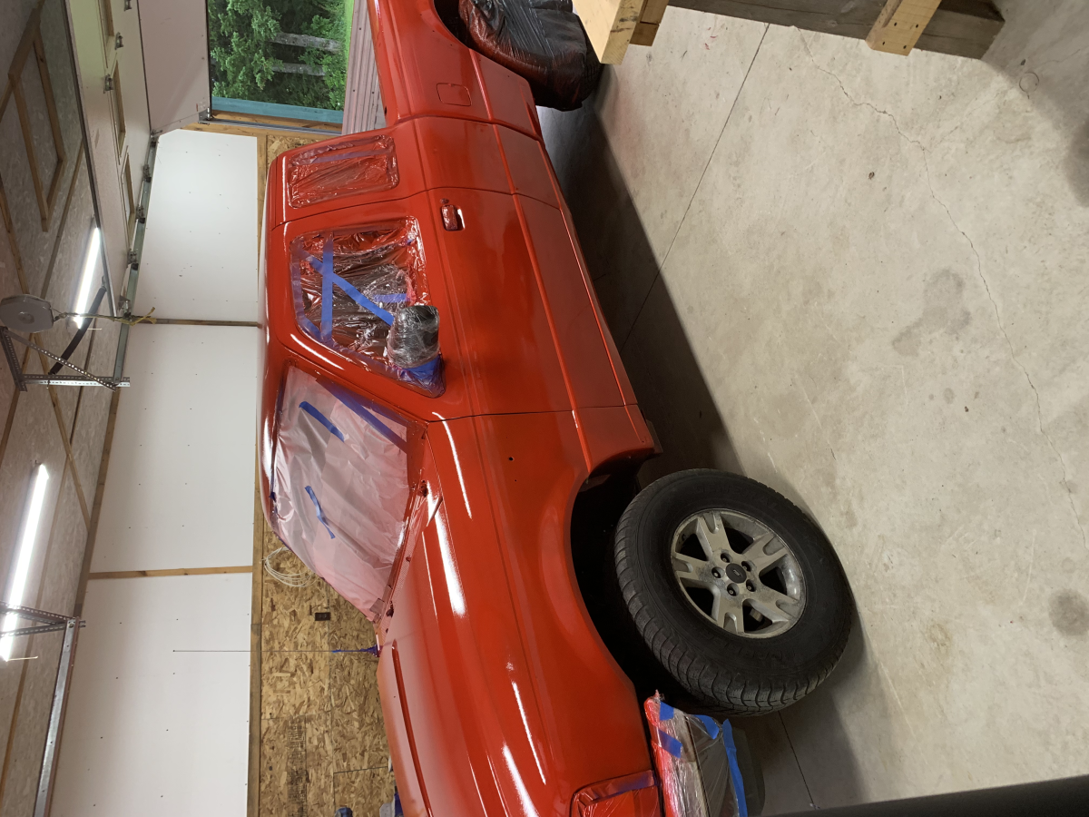

Then July my family went camping in ny, and it was ten minutes from my grandfathers shop. So I started the trip sleeping in the back of the truck, then I ended up taking advantage of the week without work or school to sand it and paint it.
Tractor supply tractor enamel, hardener, and a spray gun.
Frankentruck and its various happenings

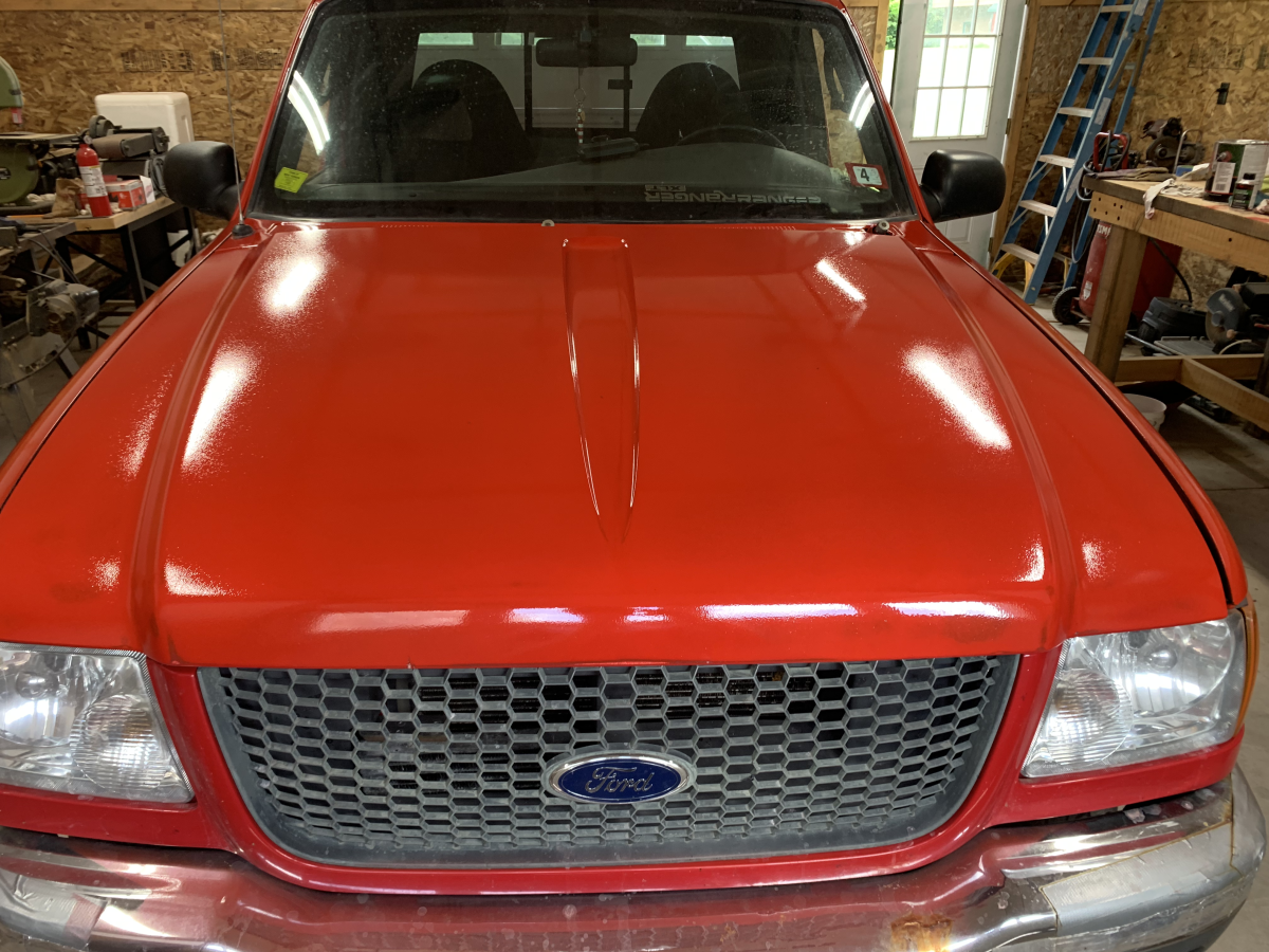

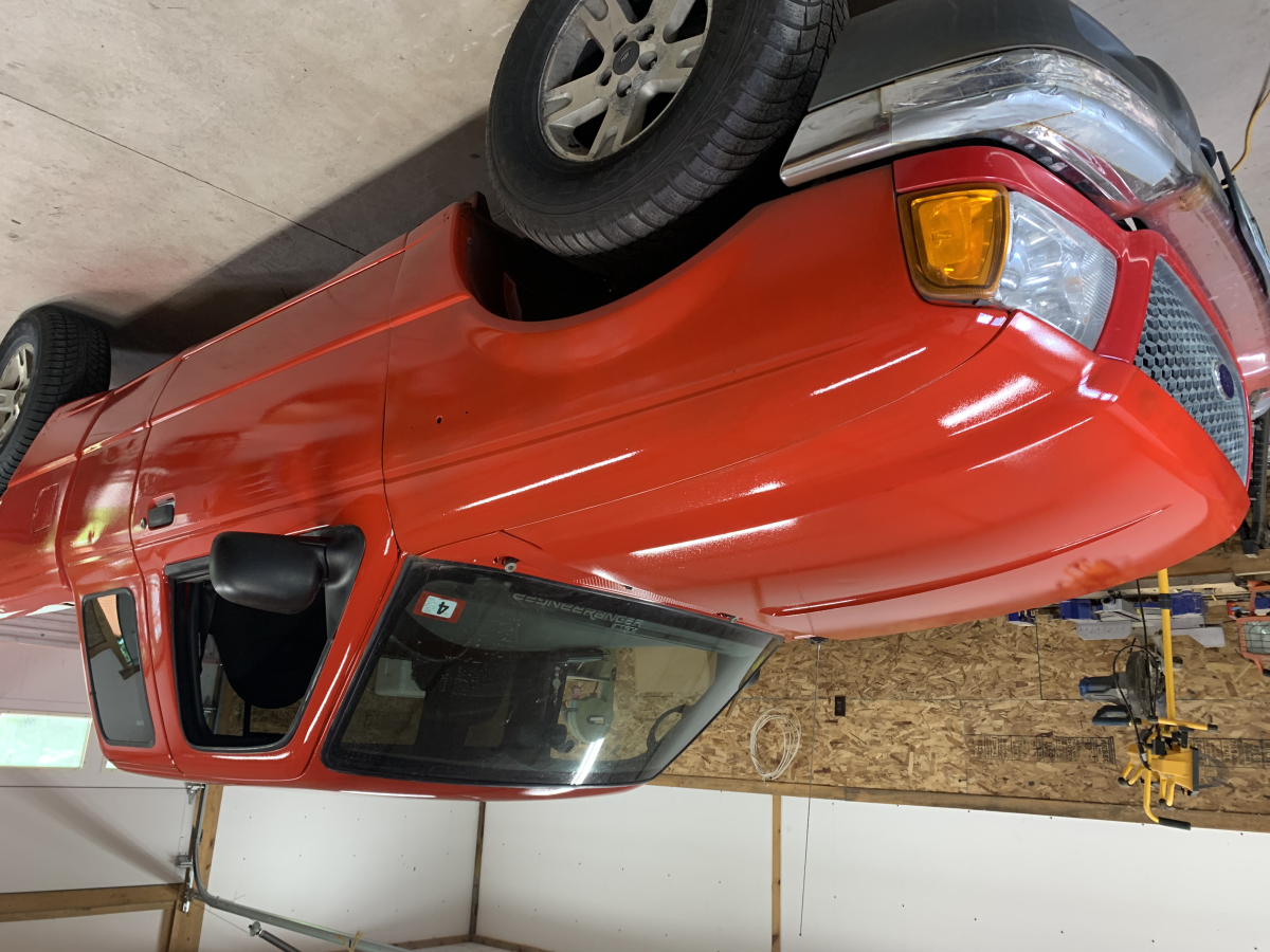

It turned out okay, It is the first time iv'e done something like this, and we had a little trouble getting the settings dialed in on the sprayer, so its got a couple runs, a couple light spots, and a bit of orange peel, needs a sanding and a second coat still. Haven't had the time to do that yet though.
I'm sorry it's upside down.... computers hate me. how did it do that?:icon_confused:
