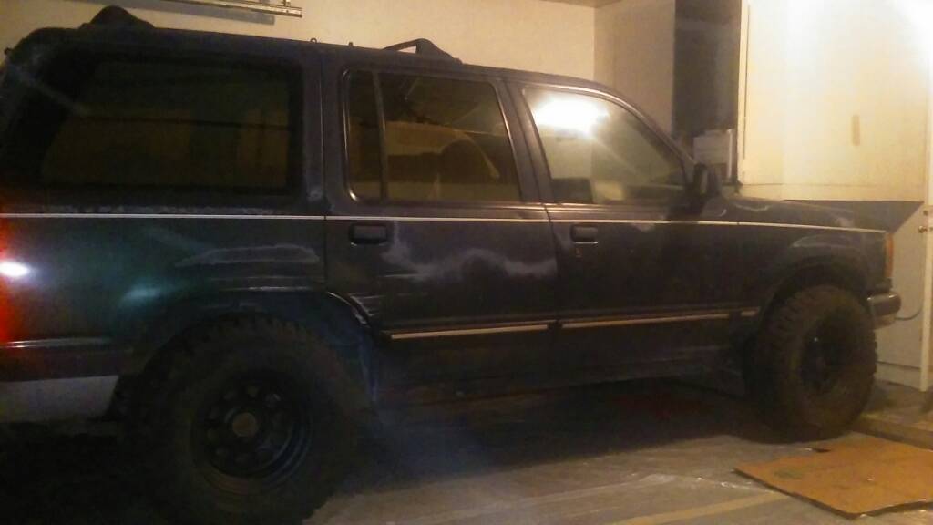

In other news I have decided that this will more or less be my "expedition" rig, going to build some bumpers, skid plates and other stuff for it. Very mild wheeler/camping/hunting rig. I swapped wheels and tires with my '88 Ranger and picked up a roof rack for it.
Built a couple replacement pieces that the rack sits on to bring it down within 1" or so of the roof so it doesn't look so stupid. I hate roof racks that are way above the roof.
Figured I can't own anything without doing a bunch of stuff to it, I am going on a back country trip later this year and need some armor/recovery points. Here is step one, front bumper. I built a receiver mount winch cradle that slides into here, that way I can use the winch on my other pickup or my car trailer if needed. Not quite done with it yet, still have to weld on some stuff and paint it but it's getting close.

Thanks, yeah I built it... just a piece of 6" channel that I cut up and bent plus diamond plate to fill in the top. It is in paint mode right now, should have it on the truck later this week.
Myself and a couple friends are meeting at 4 Corners in September and are going to run the Colorado Backcountry Discovery Route. Mostly very mild wheeling, scenic stuff and light rock crawling but the Explorer is low enough that I think better skid plates and armor are absolutely necessary. And I am the only one showing up in a $800 vehicle so I need every advantage I can get. :D

Some things I have done lately:
Removed the seats and carpet, and pressure washed the carpet at the carwash. It looks so much better, and more importantly, smells a lot better. Had some serious stank in it.
Also did an add-a-leaf in the rear, built a skid plate for the middle of the truck (basically from the trans crossmember back to right in front of the front spring hangers.) I will be building at least one more skid plate and rock sliders but first some rust repair! The dog legs were awful, rocker panels aren't great, but this truck is otherwise in excellent condition as far as rust goes so it's worth fixing and the whole thing will get painted after my CO trip.

Driver's side is about 90% done, then on to the passenger side, rock sliders, front skid plate, some wiring work, and a few other items.
Since May when I last posted, my little Explorer has gained about 5000 miles and has taken me through a lot of WY, NE, CO, and NM. I ran the Colorado BDR which starts at Four Corners and ends in Baggs, WY. 700ish miles of dirt, rocks, mountain passes, snow, etc. It was a great time, the whole trip went off without a hitch except a blown tire on the drive from SD to NM, which ended in a stop at Discount Tire in Farmington for a new set of 30x9.50x15 BFG KO2's.
I also did the following upgrades before: additional lights, rock sliders, R134a AC system swap from my 2 door, front skid plate, new bigger radiator, HD fan clutch, water pump, thermostat, steering linkage, front springs, and a few other maintenance items. I am just totally pleased with how this rig works. Plan is to finish up a few other projects and then repaint it - I'm otherwise just leaving it as is, it's too much fun how it is now to change it.
