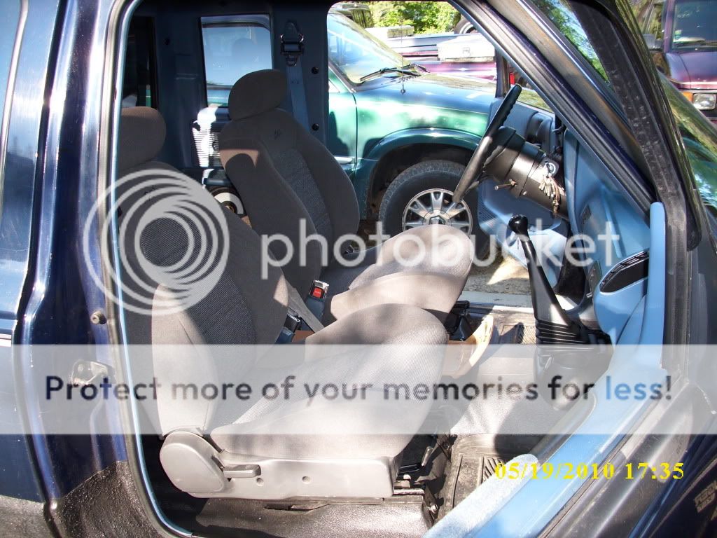

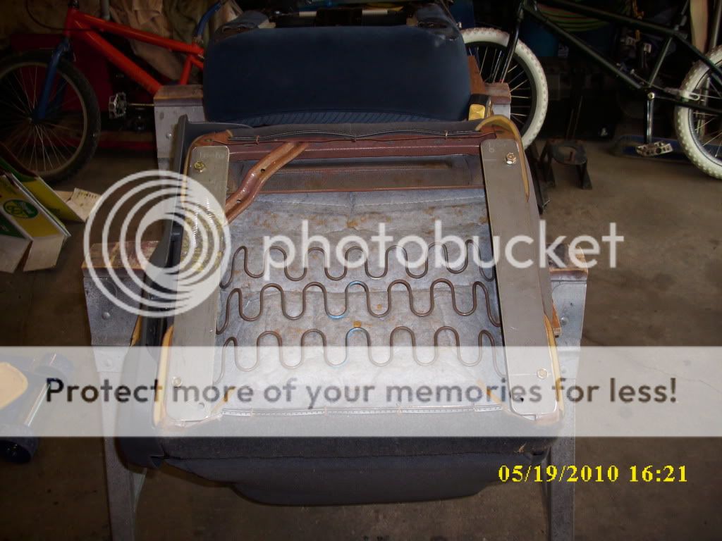

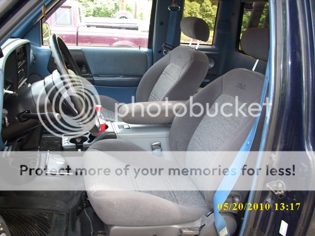

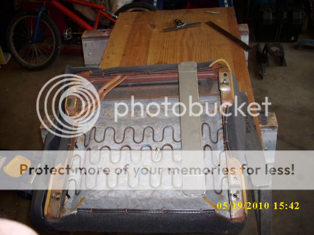

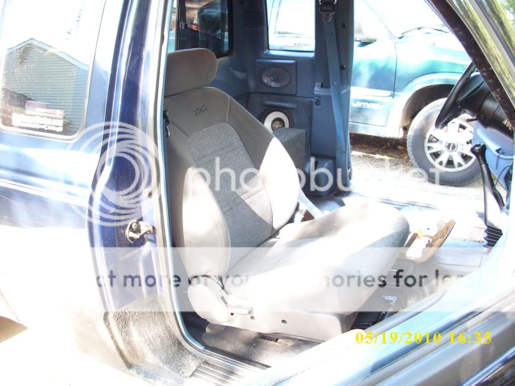

heres an update from my last 2 days off. terra and i are going to be making a trip up north for memorial day so there were a few things i needed to address to make the trip go smoother. i made up the brackets for the zx2 seats and got them mounted, then mounted the center console to fill in the large gap.

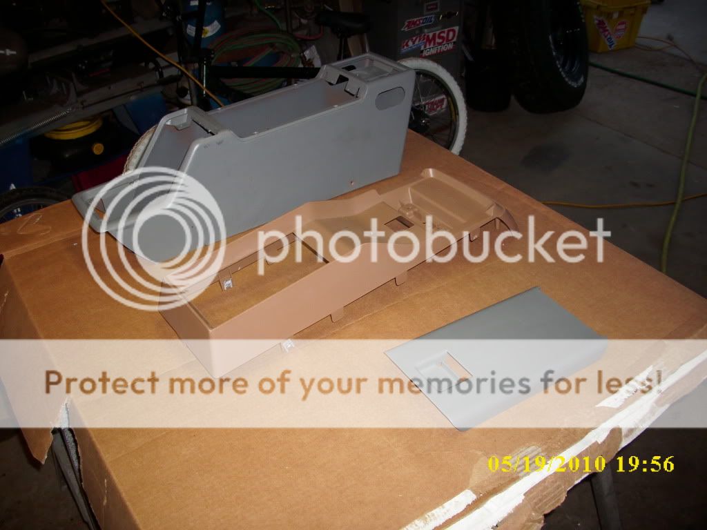

i got this center console out of an explorer a few years ago and until now i was only using the upper half in my std cab (rescue ranger), but since the ext cab was designed to use the bottom half i had to do some painting.

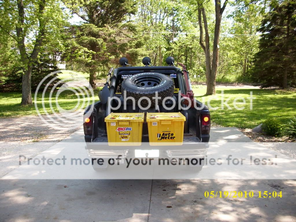

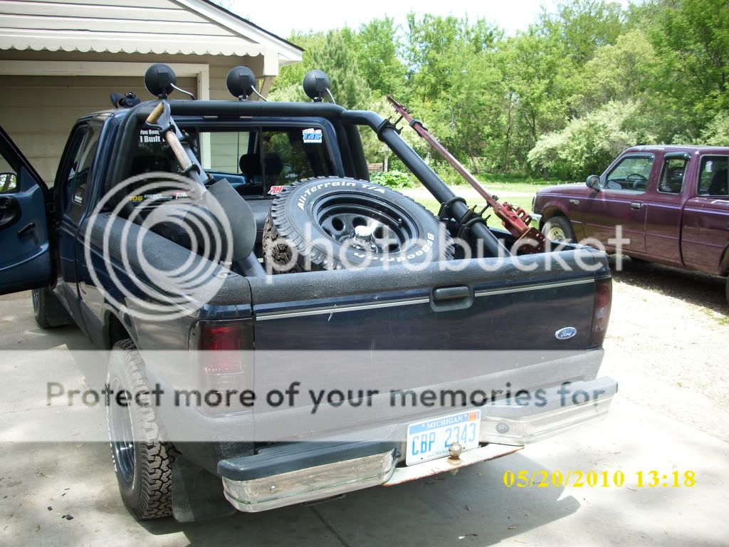

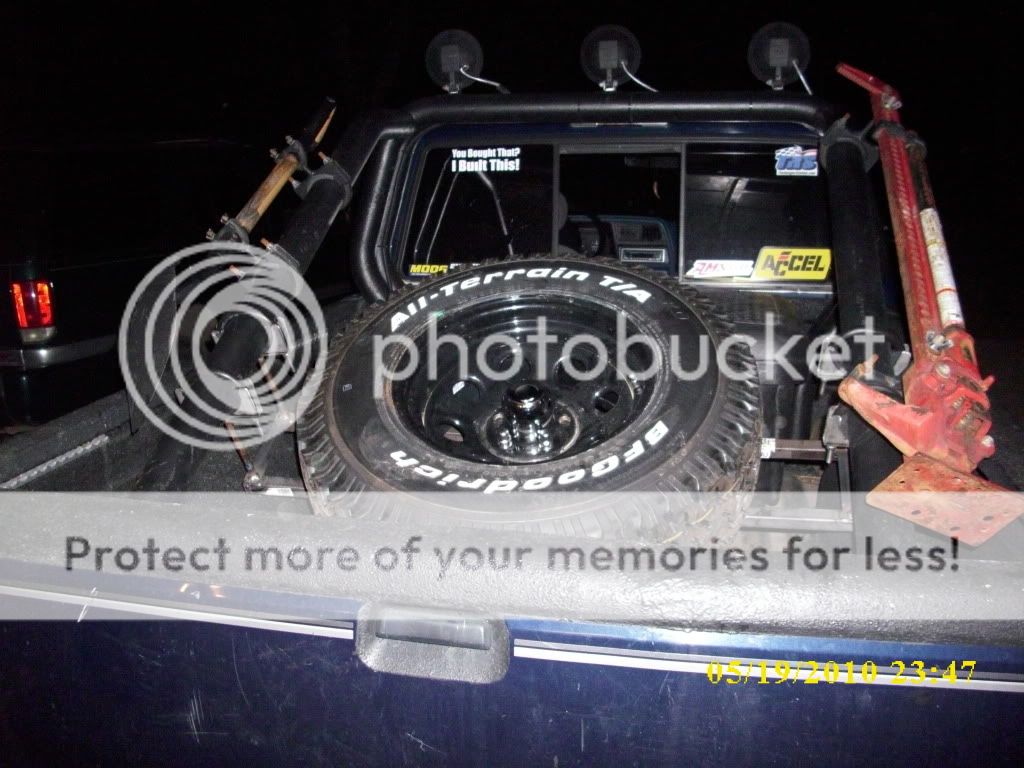

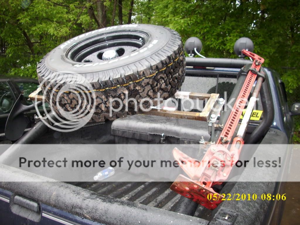

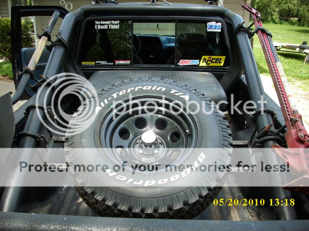

the next issue to reslove was spare tire carrying, which short of building a tire swing didnt leave me many options. i decided to turn to the muffler clamps and my roll bar to hold the spare, keeping in mind that i need the tire to be as high up as possible when loading the bed (not above the roofline though) and as low as possible when daily driving. heres what i came up with, in the low position it doesnt obstruct my view too badly, and if i unbolt it and put it on the top side of the roll bar i can slide my camping totes under it and still have room for more gear. i still need to get one more F.S. bronco tire carrier mounting plate to finish the design, but ill get to that in a few days.

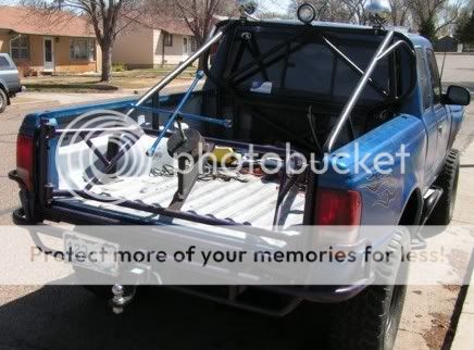

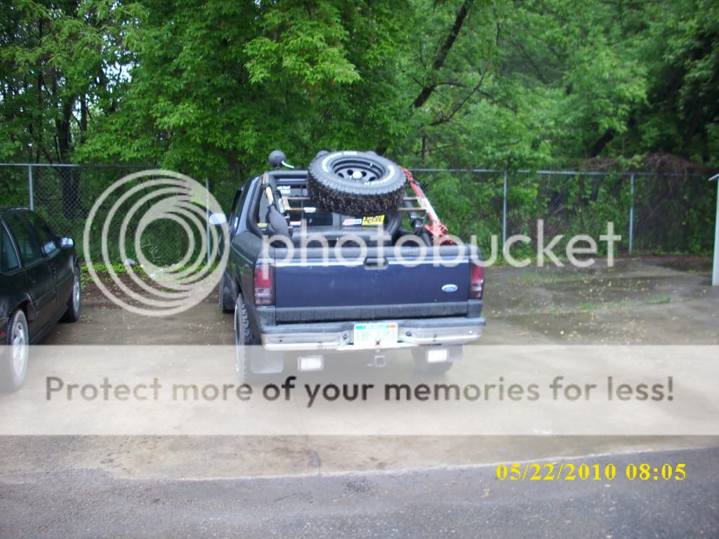

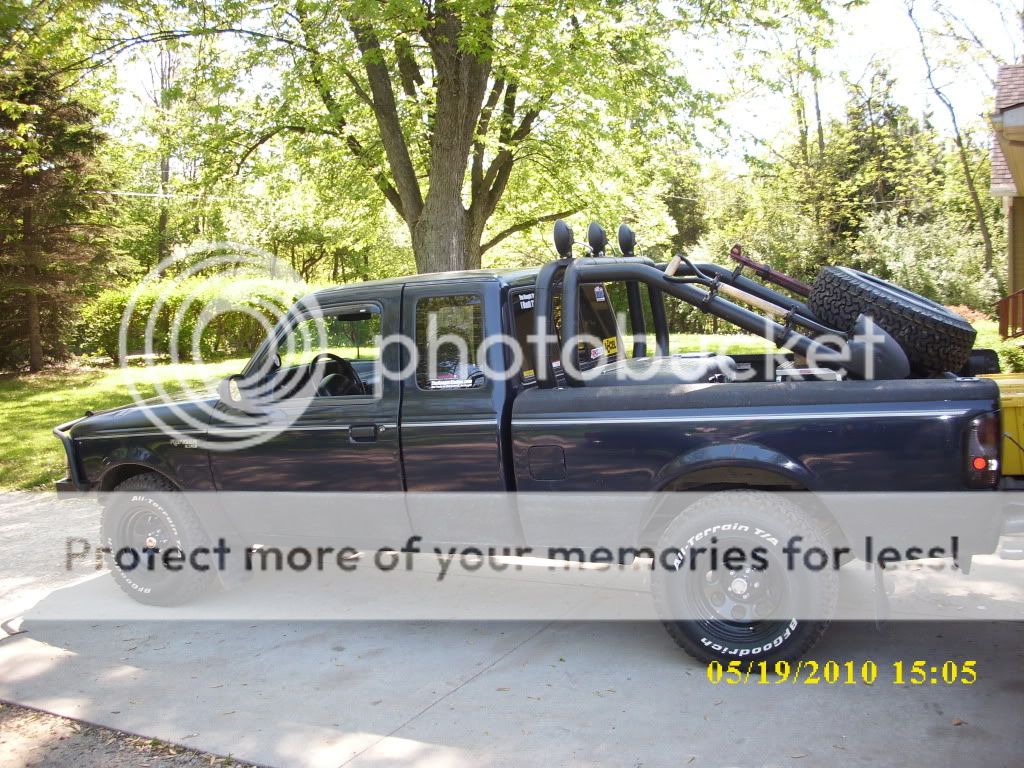

last night i got the trailer hitch mounted (with some welding, drilling, and bending of the bumper brackets) and decided to rework the tire carrier since it just didnt seem to look right.

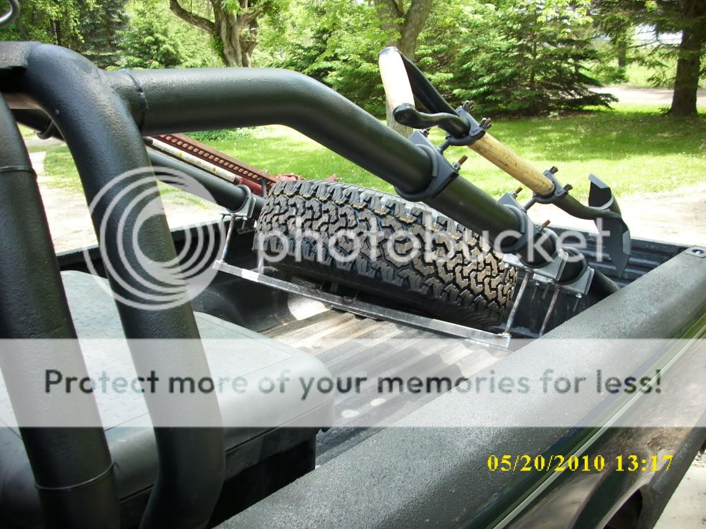

by using bolts welded to the clamps i can swivel them downward and mount the carrier below the roll bar legs and carry the tire lower in the bed.

nice seat swap!
