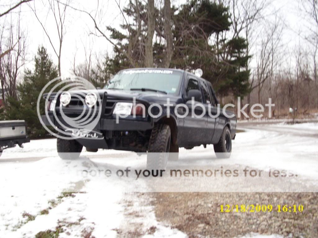

35psi seems to work much better in this crap, im still thinking about maybe throwing some junk small-block heads in there for weight though. the mud tires arent wearing unevenly, they were worn that way when i bought them. i only intended on using them as a mock up tool to help determine where the truck would sit when i got my new tires, but money has been tight and i have been forced to run these longer than i wanted too. i do have 2 of the ipike tires and i want to get 2 more, but im having trouble finding 2 or 3 more 15" gen2 wheels to mount them on. the junk yard wanted $50 a piece for some corroded ass wheels and for that price i could just buy more cragar soft 8s (the only reason i dont just get the ipikes mounted on the cragars is because the rims are too wide). thanks for all the kind words guys, once i get some good pics of the truck all cleaned up in the snow ill post up some pics in the show off your truck forum.

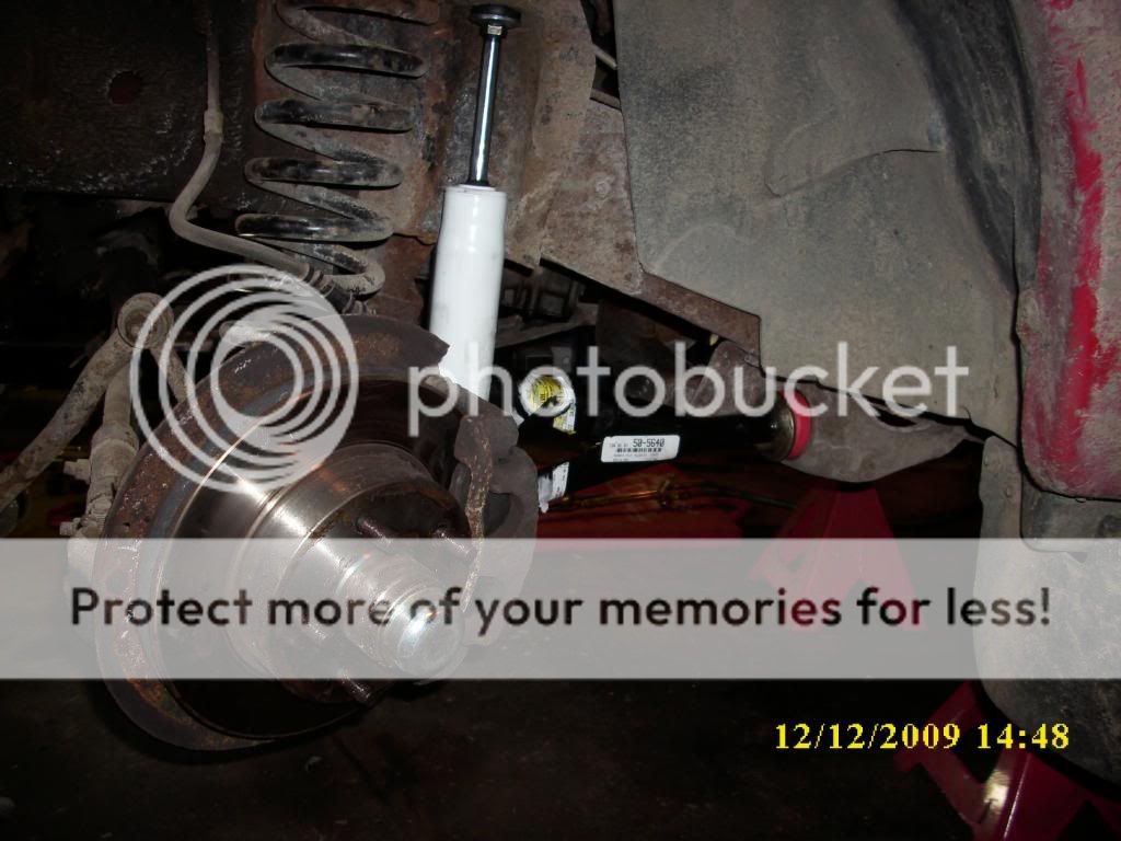

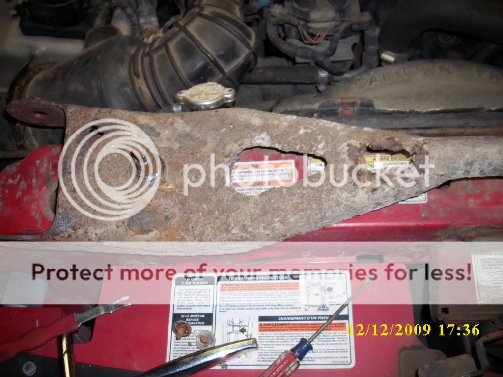

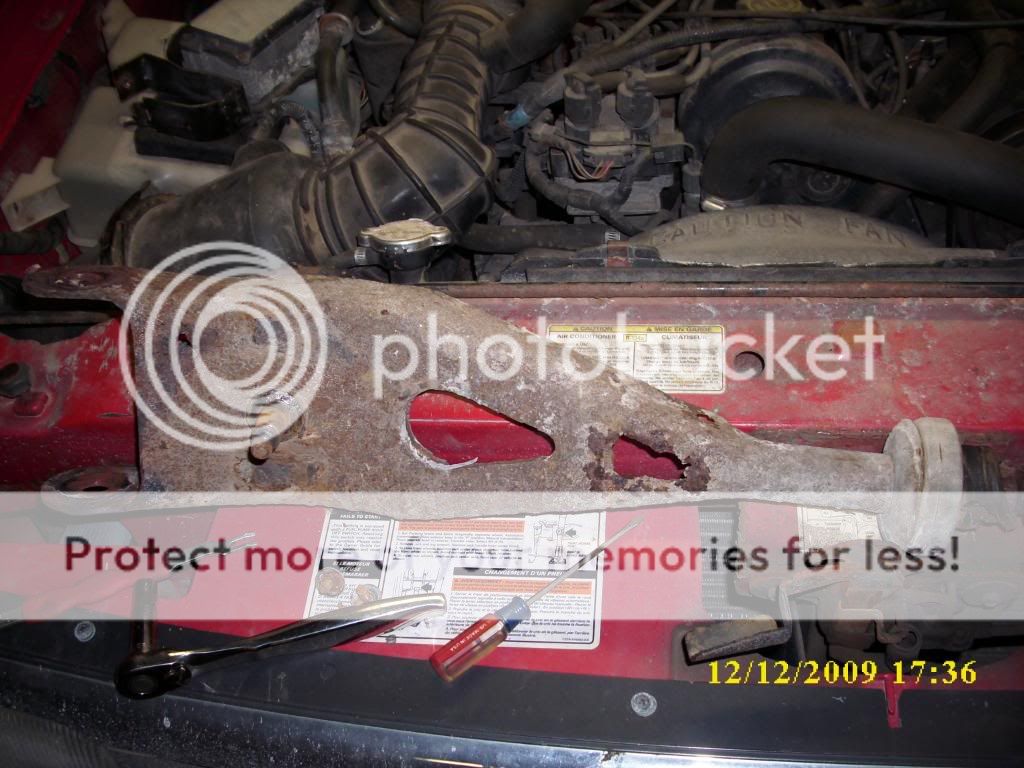

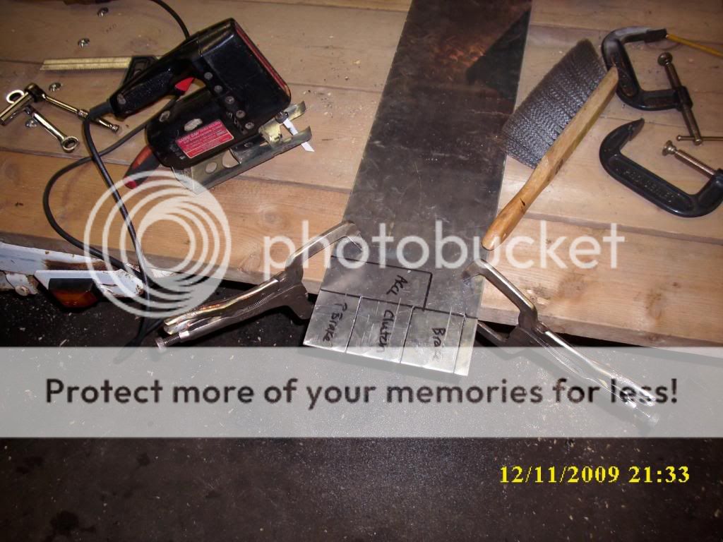

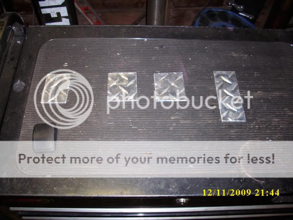

yesterday i cut out the pedal plates and ialso did a side job for my neighbor, replacing his radius arms, shocks, and bushings on his 95 2wd extended cab ranger. i noticed the holes in them about a week ago when i was removing a rattling heat shield on it. i put about 7 hours into it and also threw on a new blower motor and PCV valve that i hadnt had time to do the last time he was over.

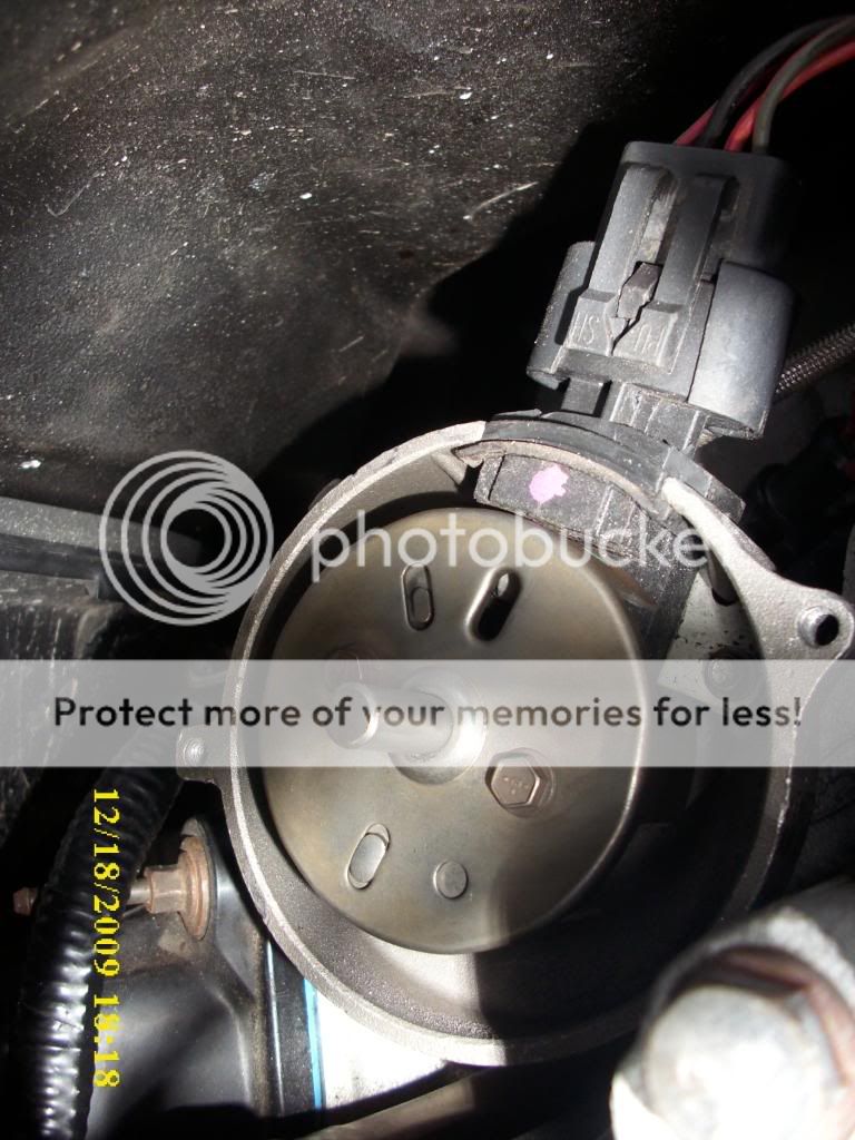

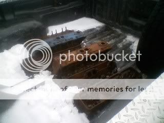

after i test drove his truck to make sure everything felt right i took thumper into town to get some pizza (about a 18 mile drive both ways) and he started acting up on me half way through the trip. my tachometer kept dropping to zero everytime the engine would miss so im thinking its either the distributor again or something in the engines wiring harness causing the voltage to spike and fry the pick up module. this is getting frustrating, and to top it off the rescue ranger is leaking coolant, has 4 different exhaust leaks that i know about, has a vaccum leak which causes it to idle funny, and its still got the worn down cooper cobras on it which made it a fun ride in to work this morning on snow covered ice (i threw 6 bare small block chevy heads in the bed when i got to work to help me get home so i can put the snow tires on it). if its not one thing its always another, plus im supposed to go xmas shopping today, i want to just say F xmas, its cancelled!

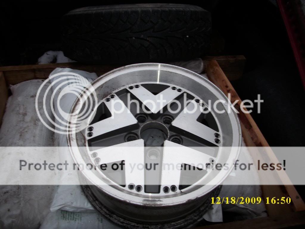

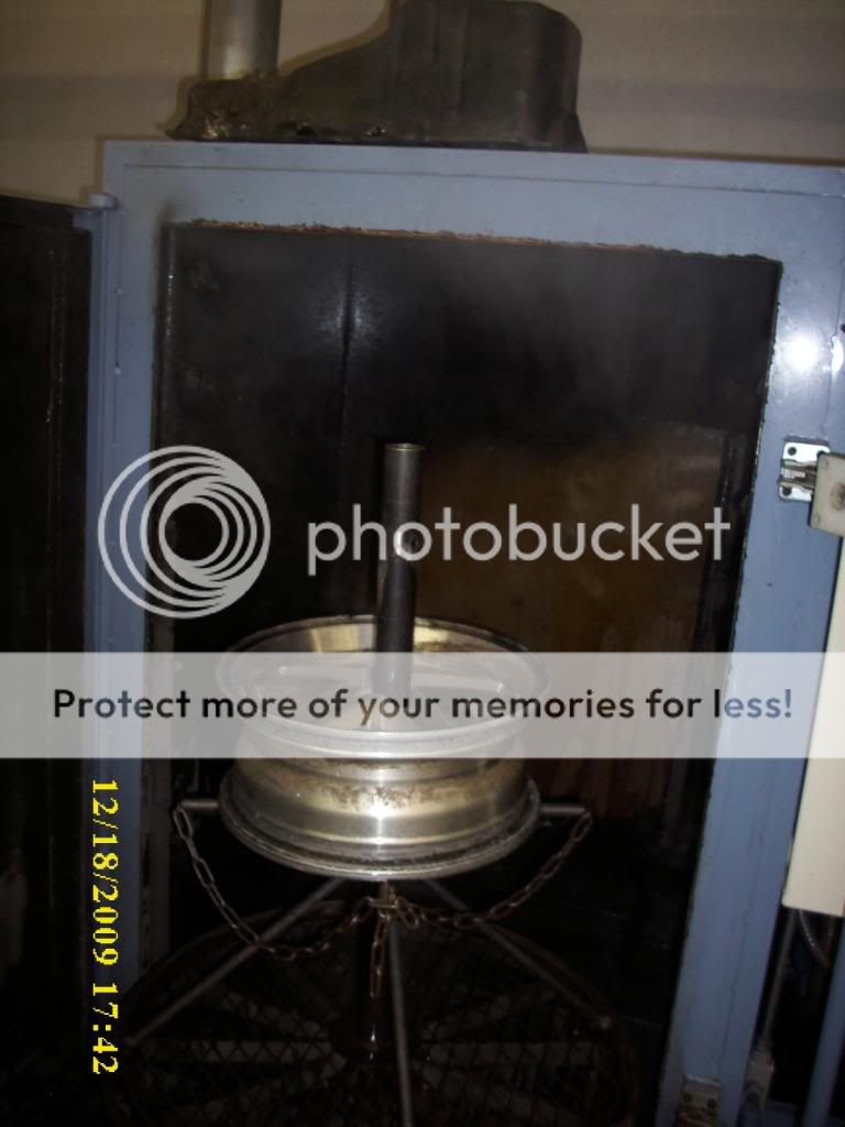

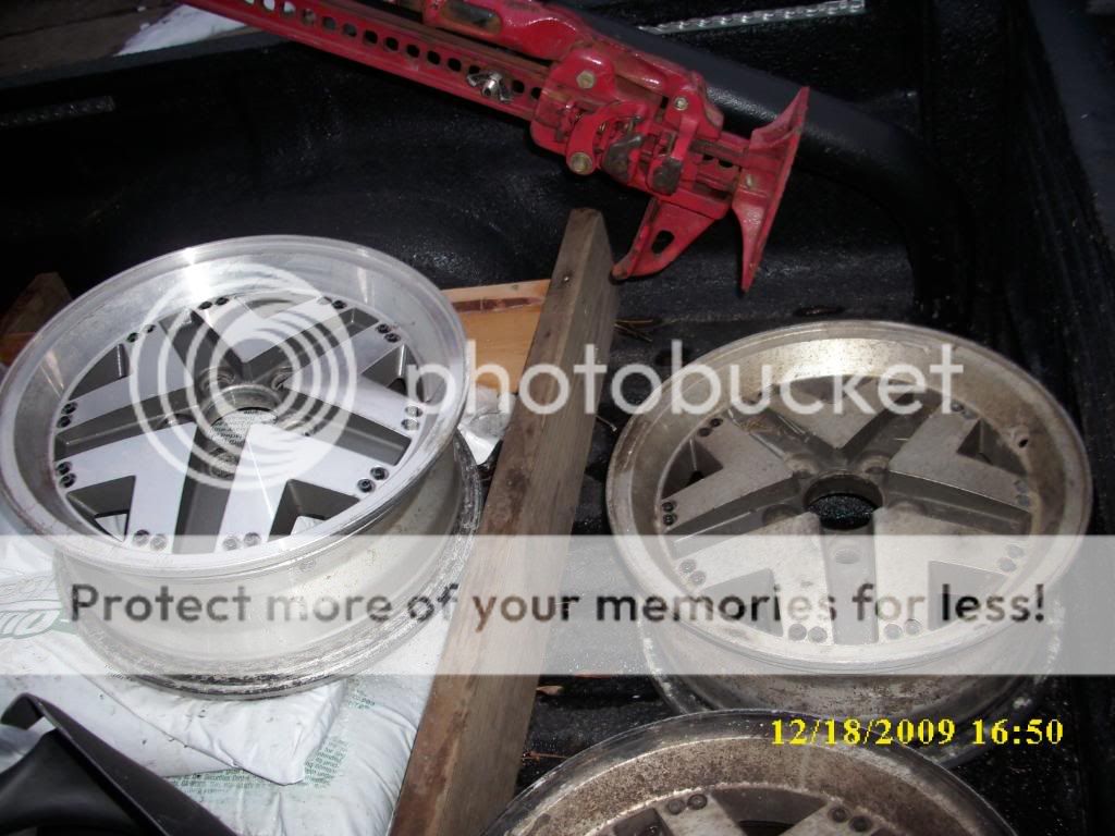

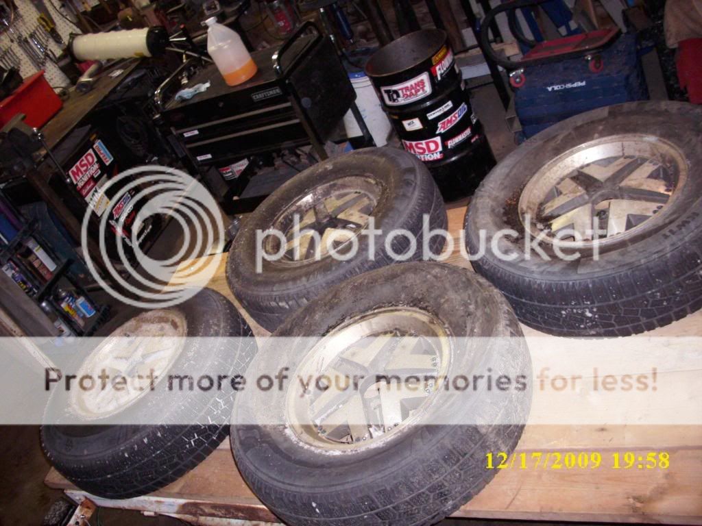

yesterday i got a set of BII wheels from a guy i know so today i had the tires dismounted and then ran each wheel through the spray off machine to clean them up. of the 4 only 1 came out very clean and the others are decent for being over 20 years old.

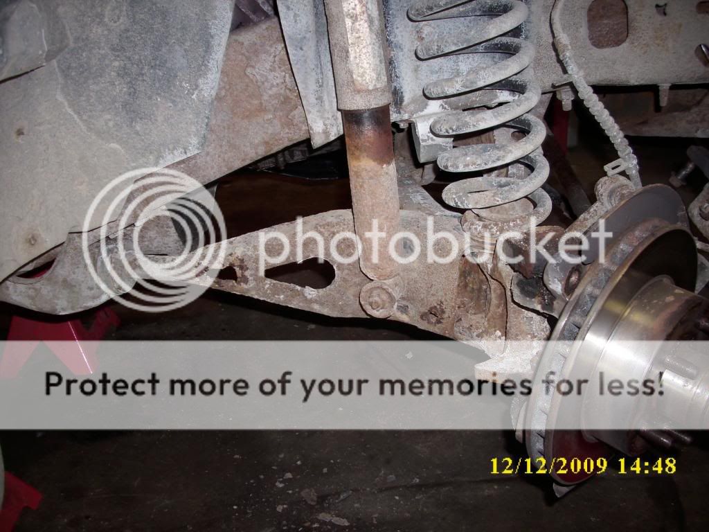

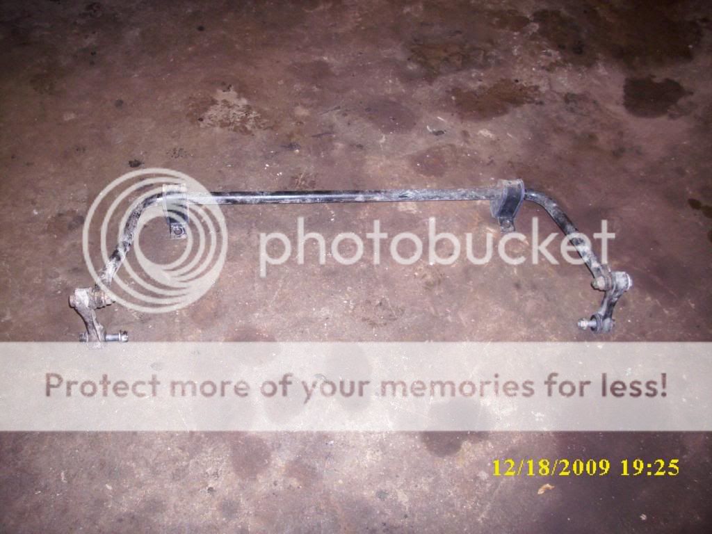

i ran thumper all day to see if i could get him to act up for me, but i couldnt get anything to go wrong, so i pulled him back into the garage to see if i could find my mystery clunk in the front end. i didnt see anything that was suspect other than possibly the sway bar links, so i decided to remove the sway bar and the noise is now gone. of course, no sway bar removal is complete with out poser flexing pics, so i made sure to take some.

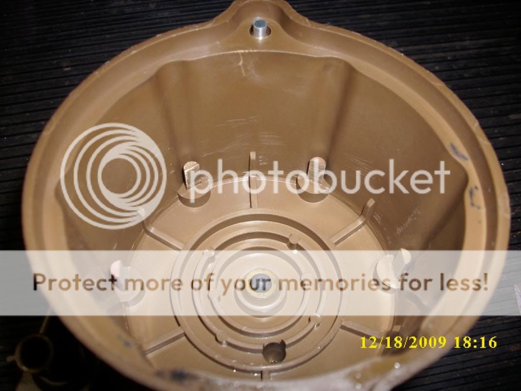

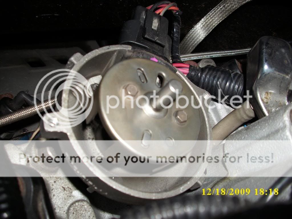

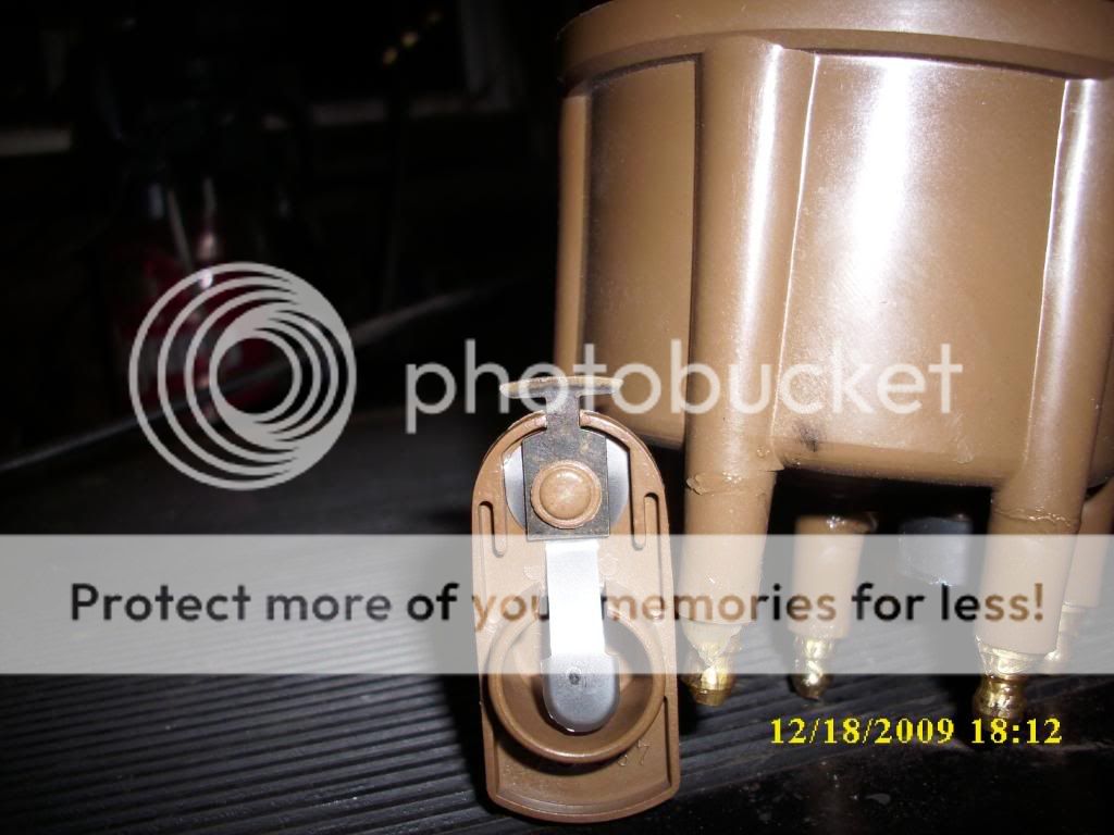

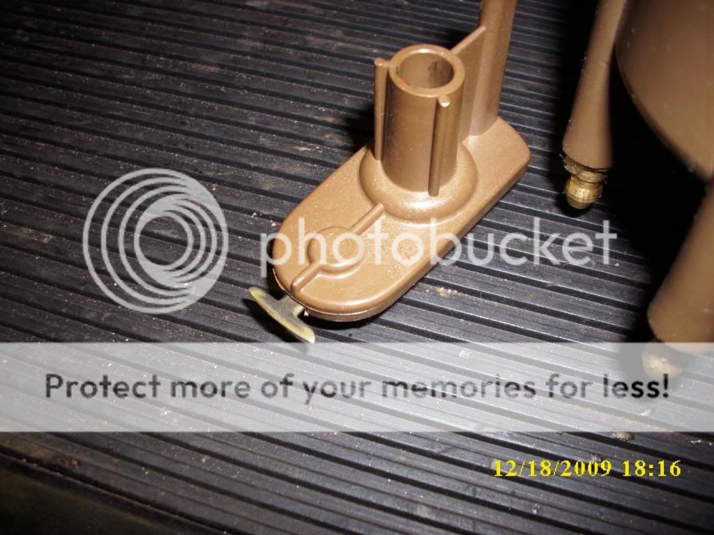

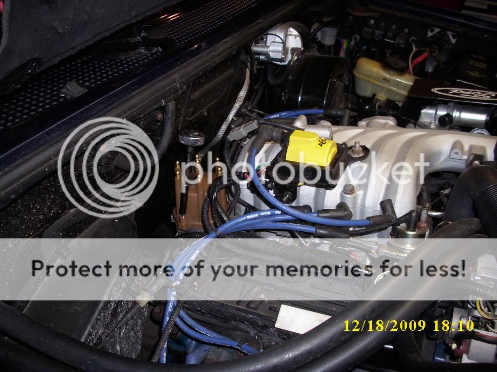

im still thinking about pulling the dist. cap off to see if theres anything noteable goign on in there.

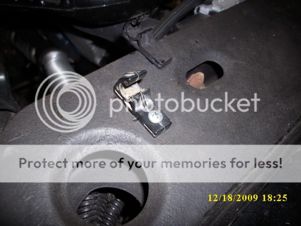

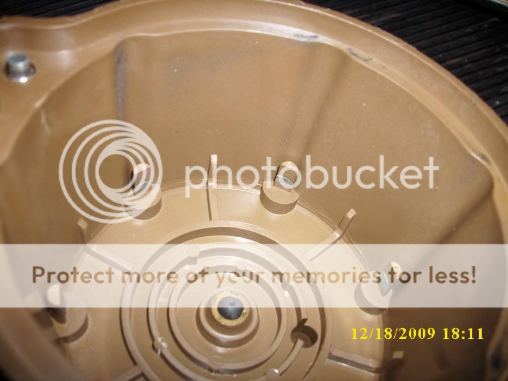

i took the cap off last night, but it didnt look as bad as i expected. the last time the distributor pickup quit on me the posts inside the cap were arc-burned about half way through, but this one only had minor arcing so i used some emery cloth to clean up the contacts. my hood prop rod clip had broken a few months ago and since i removed the sway bar earlier to get rid of the clunking, i decided to make a hold down to stop the rattling.
