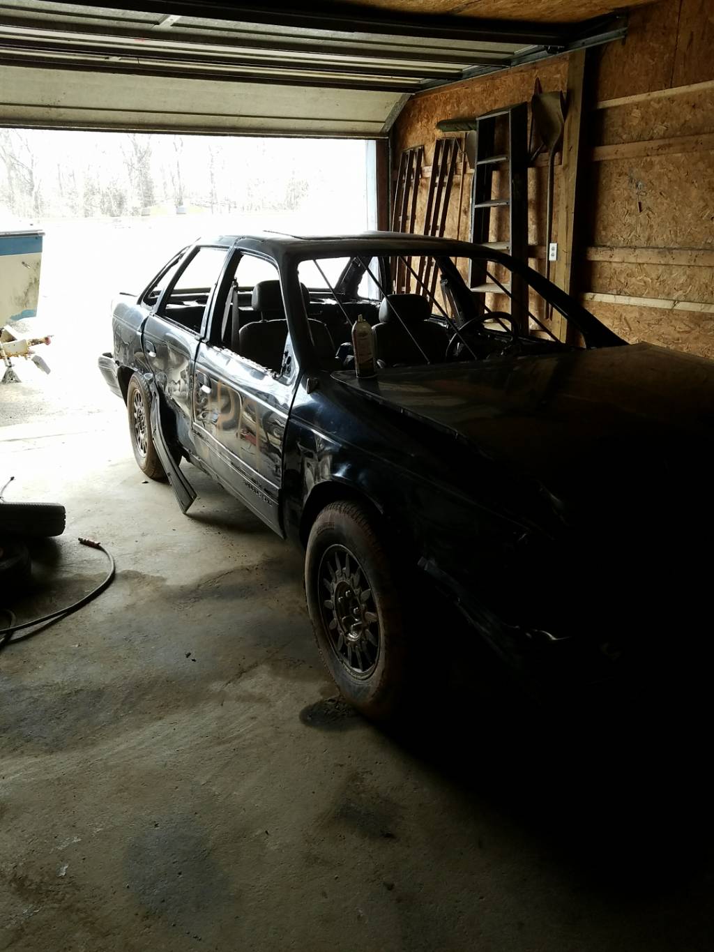

I have a sho...
650 seems like an ok price, where you at? Id sell mine.
What are your plans for the intake? I will be putting my motor in my bii once im done racing this thing (unless you wanna buy it) and that is where im stuck at currently.
Sho throttle body is on what will be the back of the engine in a truck. And ot sticks a good 8 inches past the block
