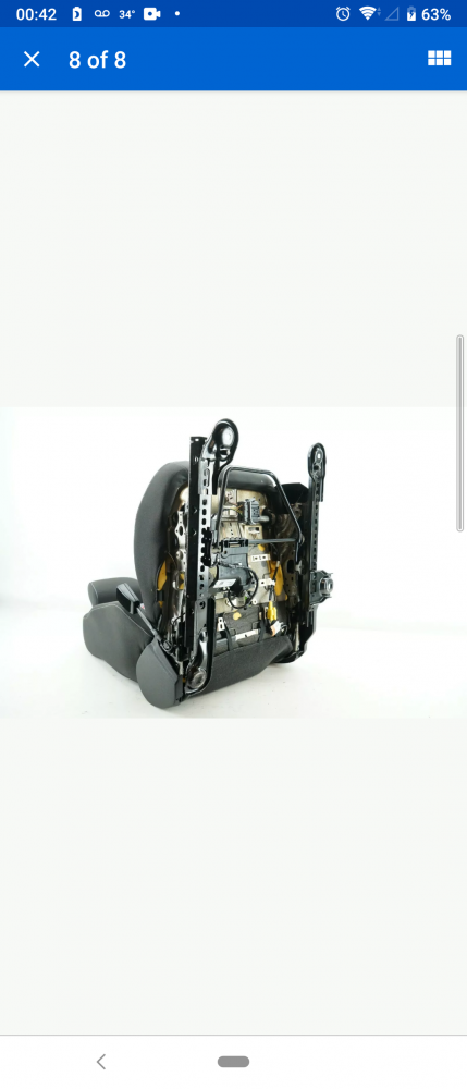

Note position (giggidy) of mount (giggidy) tabs on all sides, 2013 -2015 focus:

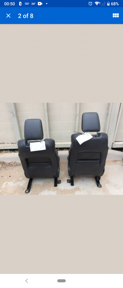

I cant remember the year with acalarity, but I think 2009-ish:

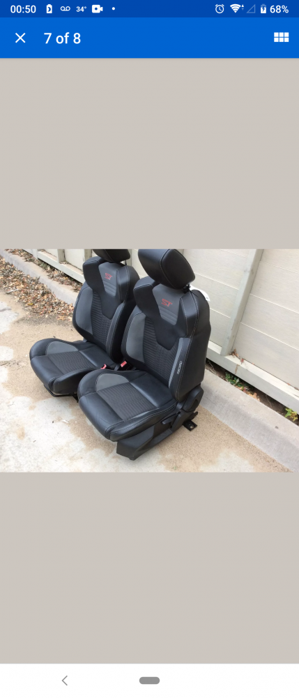

Grumpaw. If this aint the finest pasture that one could place his posterior, I don't know what is:

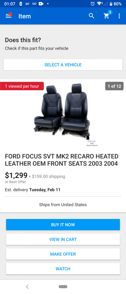

Yeah Gump, those would be perfect. But a nice set, even in cloth, in good condition, runs upwards of $600 bucks.
