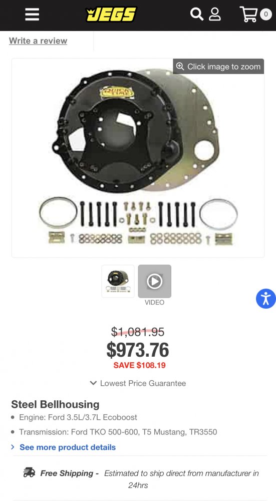

I don't think you'll find one that'll just drop in. I think the 3.7 shares a bellhousing face with the 3.5 EcoBoost used in F150 4x4s but it's going to be expensive and require fabrication.
It seems they do have the same bolt pattern.

Best bet is running a complete drivetrain from a 4x4....this presents some issues due to how low the late t cases sit in regards to ideal.
If your not using a power adder then consider this.
..the 4cyl Ecoboost with a sbf adapter is the best solution for my application. Because I have all of those parts. I have r2 and r1 options ...the power is better...but not enough to be the factor. Much easier to adapt though.
The r2....or whatever...435...zf.... t 19, ect allows easy use of doublers and np205.
There are a few companies with different variations ford gm and toy and dub using bells and or plates that can retain stock starter/flexplate with the cyclones. Most are expensive...
.but the 6r80 is a beast and very cheap.
