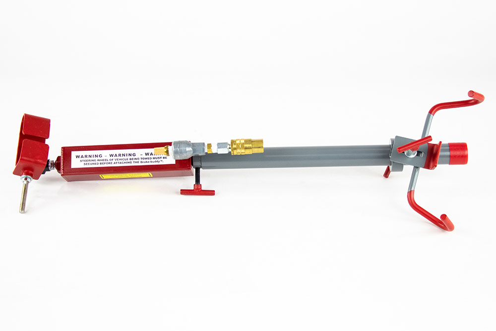

Another item to be concerned with when flat towing/4 down, is a supplemental brake system. Even tho your towing with a large, heavy pick up, your towing 3000lbs or more, and in almost all states that means a supplemental brake system is required.
I can vouch for the need...my motor home is based on a E-450 superduty, and weighs around 12,000 lbs. We tow a 3200 lb Subaru Crosstrek that I equipped with a brake system. Have stopped from a 60 mph speed both with and without the system activated, and without the system the stopping distance is about 20% longer.
They do work...the only downside is the cost. New will run around $1000.00 depending on make. The one I have, an RVI 2 went for $1300.00. Used can be purchased for 1/2 to 2/3 less than new.

I didn't consider the brakes. The F350 has more than enough stopping power but I never considered what the legal max is.
However I have a few remote braking systems made for towing semi's. Runs off air though... got me thinking just building a copy but with an electric piston instead of pneumatic.
